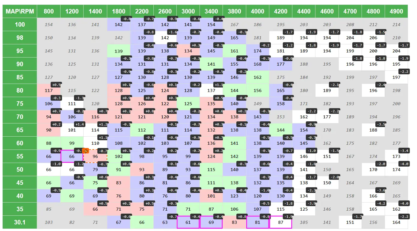

Free VE Table Corrections — Drop Your MSQ and a Datalog, I'll Do the Rest

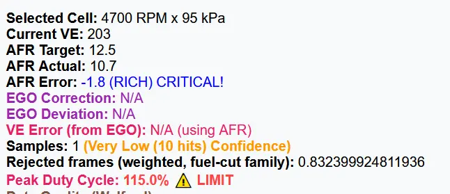

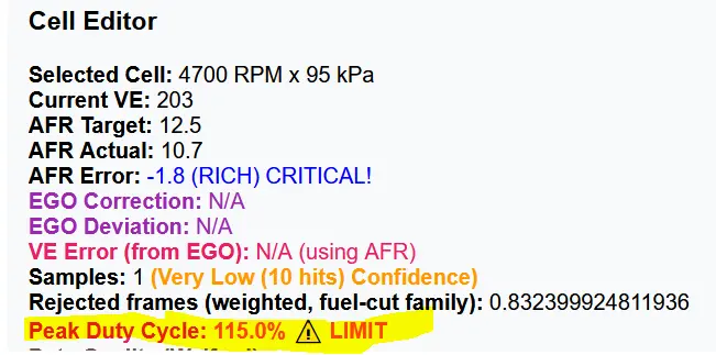

From RPM 4600 -- 90 KPA and above your injectors are maxed out any where from 10 % to 15% maxed out, in that region I am going to reduce your fuel by 5% But it looks like you need bigger injectors to go into WOT safely.
Green is good, purple is Rich , Red lean and white is overly rich or lean. Let me go over the log and send you a new VE table....
Reactions: infamous

Code:
Changes:
2600 x 100: 146 → 143 RICH (41.25%) [Low (46 hits)]
2600 x 98: 146 → 144 RICH (0%) [Very Low (31 hits)]
3000 x 100: 142 → 140 RICH (33.75%) [Low (71 hits)]
3400 x 100: 156 → 154 RICH (0%) [Very Low (48 hits)]
3000 x 98: 139 → 137 RICH (22.5%) [Low (72 hits)]
3400 x 98: 152 → 151 RICH (18.75%) [Low (84 hits)]
3000 x 95: 138 → 137 RICH (0%) [Very Low (45 hits)]
3000 x 90: 138 → 137 RICH (0%) [Very Low (35 hits)]
3000 x 85: 131 → 129 RICH (0%) [Very Low (33 hits)]
2600 x 85: 128 → 127 RICH (0%) [Very Low (47 hits)]
3400 x 85: 142 → 141 RICH (0%) [Very Low (32 hits)]
3800 x 90: 157 → 156 RICH (12.5%) [Low (40 hits)]
4200 x 95: 183 → 182 RICH (0%) [Very Low (26 hits)]
4000 x 90: 169 → 168 RICH (18.75%) [Low (26 hits)]
4200 x 90: 179 → 178 RICH (0%) [Very Low (18 hits)]
4200 x 80: 166 → 165 RICH (0%) [Very Low (8 hits)]
4200 x 75: 163 → 161 RICH (0%) [Very Low (6 hits)]
4000 x 70: 146 → 145 RICH (0%) [Very Low (20 hits)]
3400 x 75: 141 → 142 LEAN (18.75%) [Medium (110 hits)]
3400 x 70: 139 → 141 LEAN (33.75%) [Medium (138 hits)]
3400 x 60: 141 → 142 LEAN (19.59367552958419%) [Medium (329 hits)]
3400 x 65: 139 → 141 LEAN (27.04792430285343%) [Medium (169 hits)]
4200 x 65: 148 → 146 RICH (0%) [Very Low (22 hits)]
4200 x 60: 146 → 144 RICH (25%) [Low (35 hits)]
4200 x 55: 145 → 144 RICH (12.5%) [Low (58 hits)]
4200 x 50: 146 → 144 RICH (11.730970905883478%) [Low (65 hits)]
4200 x 45: 143 → 141 RICH (13.61025010615077%) [Low (40 hits)]
4000 x 60: 143 → 141 RICH (33.75%) [Low (43 hits)]
4000 x 55: 142 → 141 RICH (12.5%) [Low (89 hits)]
4000 x 50: 141 → 139 RICH (18.75%) [Medium (116 hits)]
4000 x 45: 136 → 134 RICH (22.5%) [Low (92 hits)]
4000 x 40: 127 → 125 RICH (26.080846145579358%) [Low (116 hits)]
4000 x 35: 110 → 109 RICH (9.546283009413353%) [Low (89 hits)]
4400 x 65: 159 → 156 RICH (0%) [Very Low (10 hits)]
4400 x 60: 151 → 148 RICH (0%) [Very Low (21 hits)]
4400 x 55: 152 → 148 RICH (CRITICAL) (0%) [Very Low (25 hits)]
4400 x 50: 149 → 145 RICH (CRITICAL) (0%) [Very Low (22 hits)]
4400 x 45: 144 → 140 RICH (CRITICAL) (0%) [Very Low (16 hits)]
4600 x 60: 166 → 162 RICH (CRITICAL) (0%) [Very Low (6 hits)]
4600 x 55: 154 → 150 RICH (CRITICAL) (0%) [Very Low (8 hits)]
4600 x 50: 155 → 150 RICH (CRITICAL) (0%) [Very Low (7 hits)]
4400 x 35: 130 → 128 RICH (0%) [Very Low (9 hits)]
4400 x 30.1: 110 → 107 RICH (CRITICAL) (0%) [Very Low (11 hits)]
4200 x 30.1: 92 → 89 RICH (CRITICAL) (0%) [Very Low (24 hits)]
3800 x 45: 140 → 141 LEAN (12.454660541889606%) [Medium (358 hits)]
3800 x 30.1: 85 → 88 LEAN (CRITICAL) (12.750263627920738%) [Medium (230 hits)]
3400 x 30.1: 73 → 72 RICH (19.63557036797158%) [High (1518 hits)]
3000 x 60: 112 → 111 RICH (26.09451073991394%) [Medium (327 hits)]
3000 x 55: 106 → 105 RICH (37.13128217474036%) [High (597 hits)]
3000 x 50: 99 → 98 RICH (40.15309272695568%) [High (941 hits)]
2600 x 45: 89 → 88 RICH (22.46729819195722%) [High (1822 hits)]
2600 x 40: 83 → 82 RICH (22.508538536682632%) [High (3085 hits)]
2600 x 30.1: 66 → 64 RICH (37.36612391145096%) [High (3558 hits)]
1800 x 75: 127 → 128 LEAN (11.309051128047154%) [Low (64 hits)]
1800 x 60: 113 → 112 RICH (0%) [Medium (151 hits)]
1400 x 75: 119 → 121 LEAN (0%) [Very Low (16 hits)]
1400 x 70: 116 → 117 LEAN (10.240021022281967%) [Low (47 hits)]
1400 x 65: 117 → 118 LEAN (4.992087945636398%) [Low (56 hits)]
1400 x 60: 112 → 114 LEAN (9.91948423551169%) [Low (72 hits)]
1400 x 45: 76 → 77 LEAN (14.786066417223035%) [Medium (281 hits)]
1400 x 35: 65 → 67 LEAN (14.706187787349997%) [Low (328 hits)]
1400 x 30.1: 68 → 71 LEAN (CRITICAL) (0%) [Very Low (352 hits)]
1200 x 70: 107 → 110 LEAN (CRITICAL) (0%) [Very Low (21 hits)]
1200 x 65: 101 → 103 LEAN (12.672124873467727%) [Low (40 hits)]
4700 x 30.1: 153 → 152 RICH (0%) [Very Low (6 hits)]
4900 x 35: 164 → 160 RICH (CRITICAL) (0%) [Very Low (1 hits)]
4900 x 30.1: 164 → 162 RICH (0%) [Very Low (1 hits)]
4900 x 95: 207 → 201 RICH (CRITICAL) (0%) [Very Low (5 hits)]
4900 x 90: 199 → 194 RICH (CRITICAL) (0%) [Very Low (5 hits)]

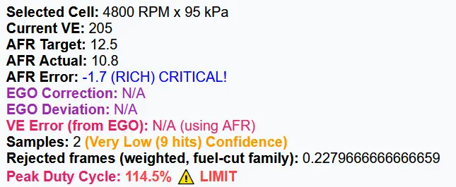

4800 x 95: 205 → 200 RICH (CRITICAL) (0%) [Very Low (9 hits)]
4700 x 95: 203 → 198 RICH (CRITICAL) (0%) [Very Low (10 hits)]
4600 x 98: 198 → 193 RICH (CRITICAL) (0%) [Very Low (20 hits)]
3000 x 30.1: 66 → 65 RICH (21.131780150044477%) [High (2884 hits)]
4900 x 85: 198 → 193 observed-insufficient (0%) [Observed Only (4 hits)]
4800 x 85: 198 → 192 observed-insufficient (0%) [Observed Only (4 hits)]
4700 x 85: 200 → 196 observed-insufficient (0%) [Observed Only (2 hits)]
4700 x 98: 206 → 200 observed-insufficient (0%) [Observed Only (9 hits)]
4800 x 98: 208 → 201 observed-insufficient (0%) [Observed Only (7 hits)]
4900 x 98: 211 → 202 observed-insufficient (0%) [Observed Only (3 hits)]
4900 x 100: 214 → 205
4800 x 100: 212 → 205
4700 x 100: 209 → 205
4400 x 100: 204 → 200 no-data (0%) [No Data]
4900 x 80: 199 → 192 no-data (0%) [No Data]
4800 x 80: 197 → 191 no-data (0%) [No Data]
4800 x 75: 198 → 190
4900 x 75: 200 → 191
4900 x 70: 196 → 190
4800 x 70: 194 → 190
4800 x 90: 198 → 193 RICH (CRITICAL) (0%) [Very Low (5 hits)]
2200 x 100: 138 → 136 RICH (0%) [Very Low (39 hits)]
Total changes: 91
Lean: 16, Rich: 59, Good: 0, No data: 16

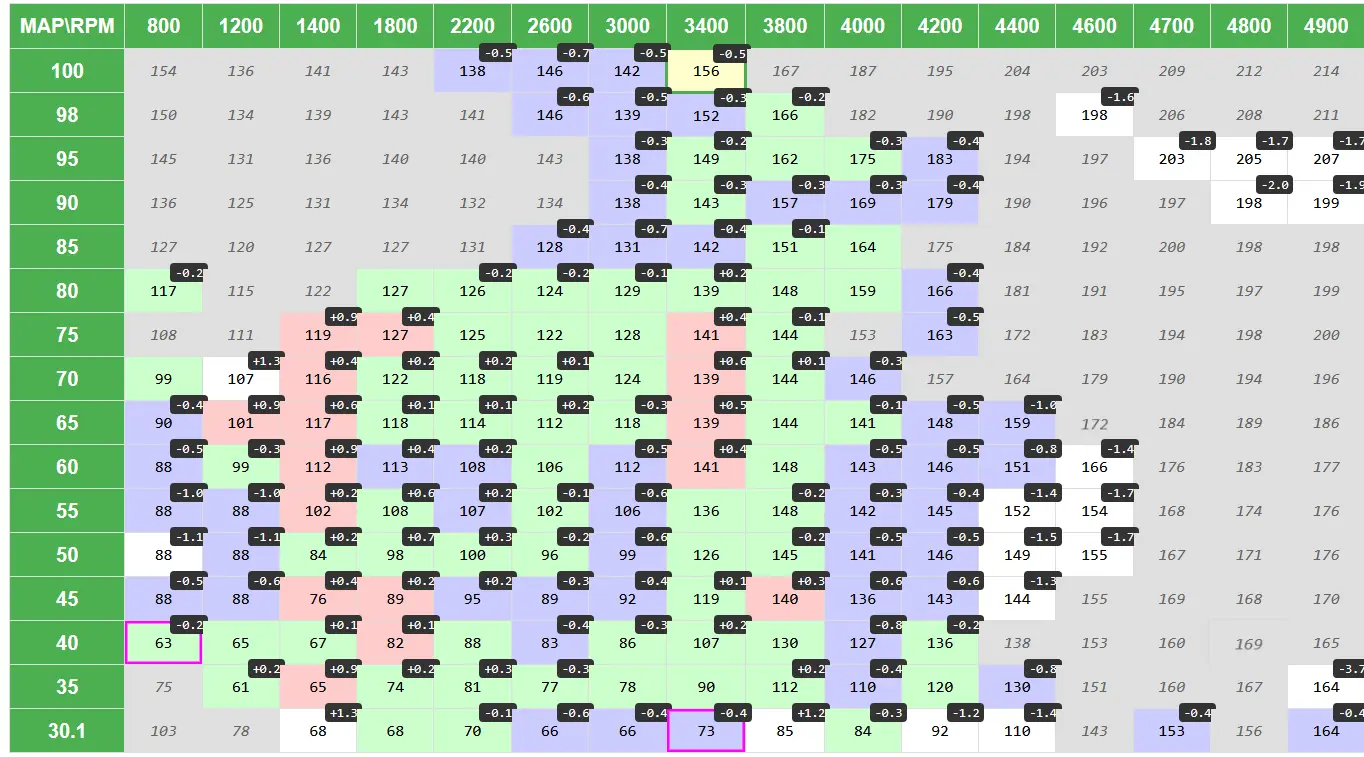

So after a lot of riding and testing, the VE numbers you provided seemed to really help a ton. Here is a log from today along with the saved tune file. Let me know if you think I should modify the tables further. Thank you so much for all your insight. Looking forward to seeing if the numbers change yet again.
Cheers.
OK... I see what happened before, I ran the tune from post #32 against the .mlg from post #30. But what you logged with is the VE table from post #30.
So if I had put that into the tune.... The corrections would have been different. I need to now ask you if the two combined of what you have here the .mlg and .msq is what you actually logged with, the last round of corrections was basically Null and Void , the VE table I corrected against was not what was in the tune while you were logging.
The tune and .mlg are the same from logging time and there was no Auto tuning going on?
I need to build that detection into my tool...
