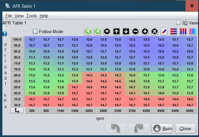

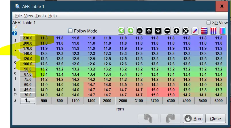

I was hoping you could help me with my '90 5.0. Attached are the files you ask for. I just installed E303, GT40 3bar Heads, shorty headers, wideband, edelbrock intake, 1.72 Roller rockers, BBK Power Plus fuel, 24lb inj, 160 stat, 75mm throttle body. Never tuned a car before and I'm using a MSQ2PNP. Struggled to get the idle but have it as good as I could get for now. I haven't driven it yet, this log is really only idling so far. Wasn't comfortable taking it out. If that is what you need I can reload a new log later. My AFR has been all over the place. Any help would be appreciated.
You have a .msq loaded for a boosted car. Grab the base table from here and re-log.
https://www.megasquirtpnp.com/downloads/basemaps/fw_pro_152/dlmap.php?dlfn=Foxbody 5.0 1.5.2.msq

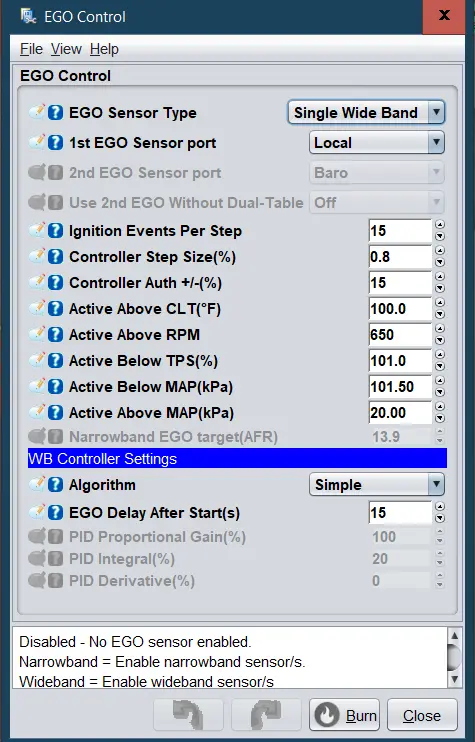

Go to tools====> Calibrate AFR enter your wide band :
Fuel settings injector dead time 0.85 -----> Batt voltage correction 0.140
Basic Load settings: Engine Sequential: ---> Engine Size: Engine Size: 4949 cc ---> Injector Size Each: 252 cc ---> Staging: Alternating
Click required fuel after this:
Fuel---> Ego control like this:
Save tune flash to car, then turn car off wait 15 seconds turn back on idle then log send me new data

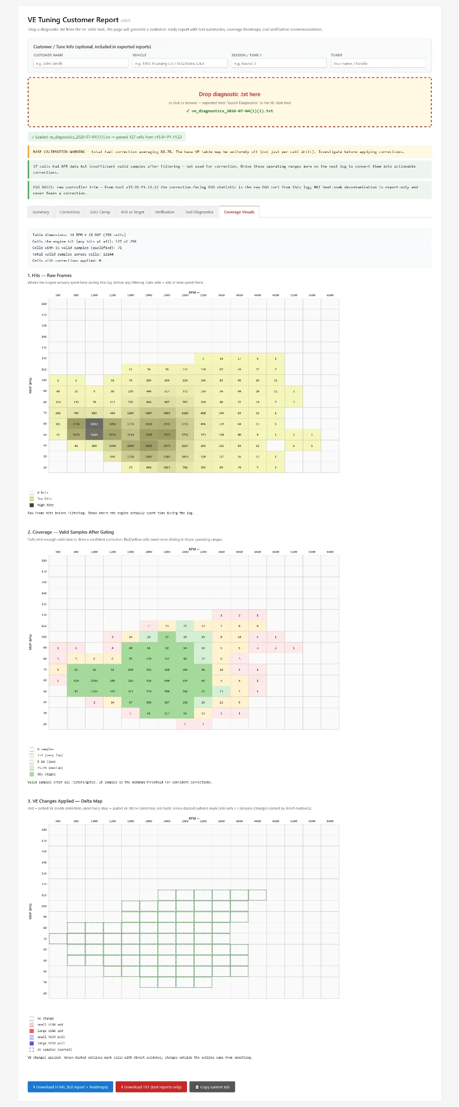

Apologies I ran that without the Wideband Lag adjustment checked.
