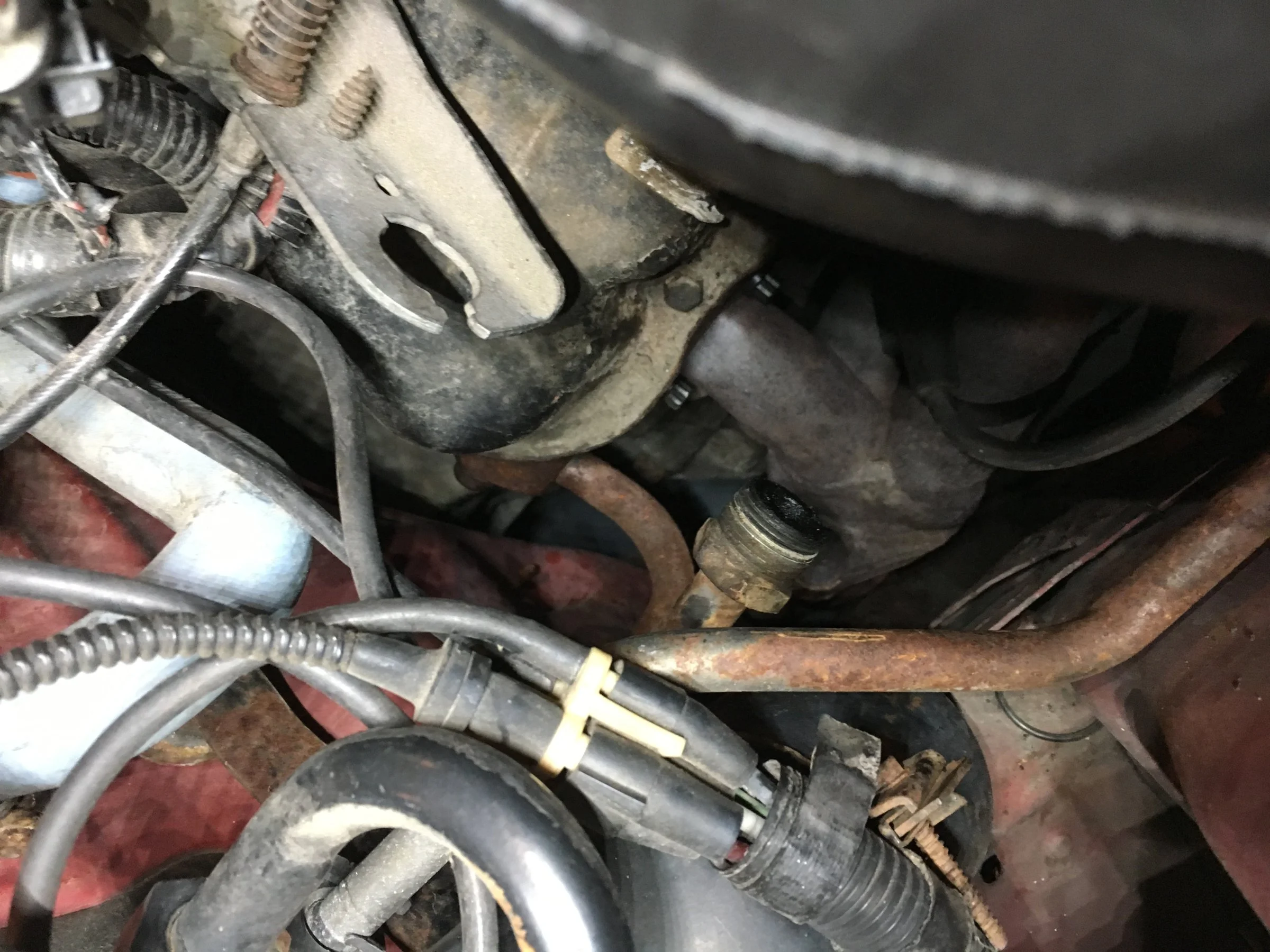

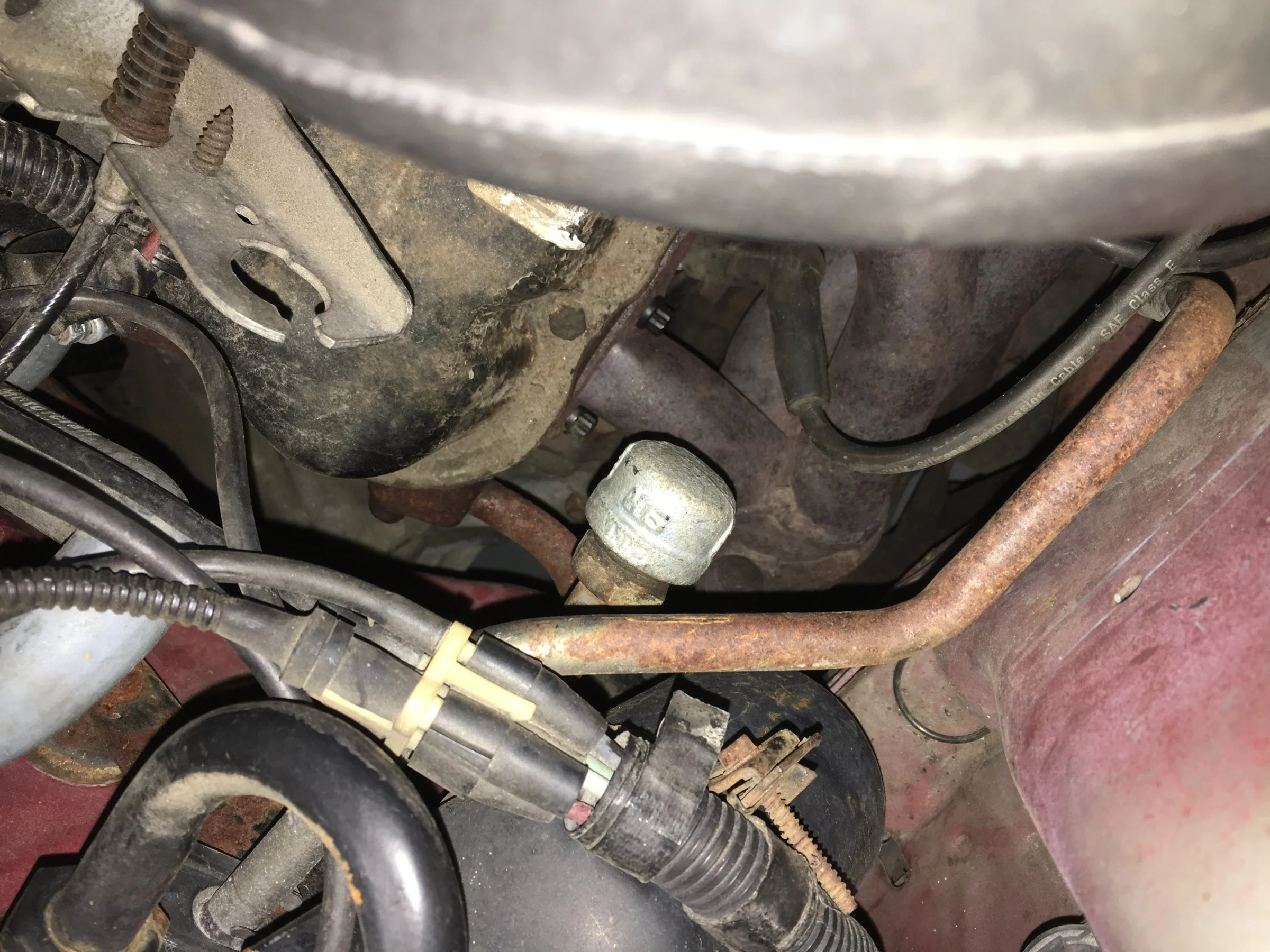

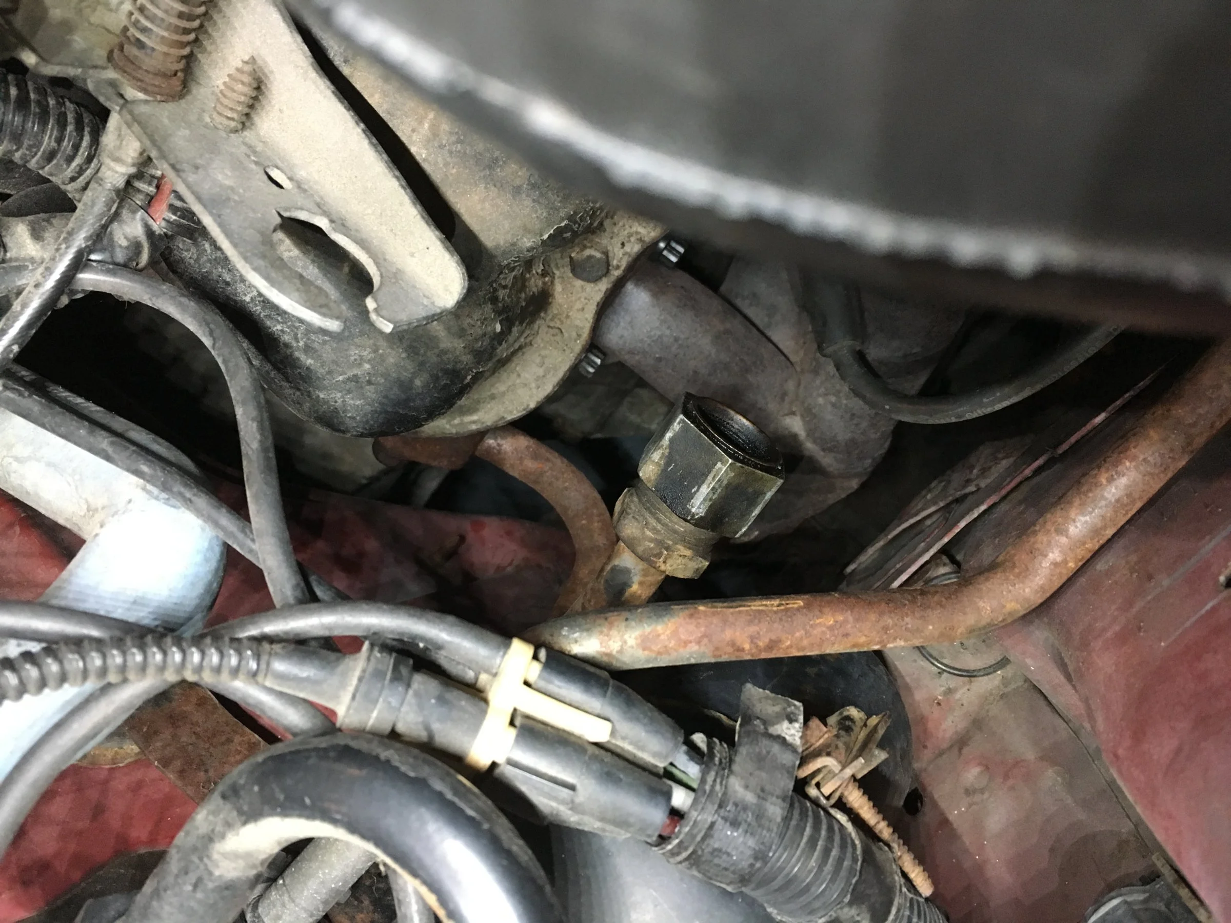

correct way to delete smog off of 88 5.0?
This is what I have to work with. I was able
To get the nut off of the end and I believe I have a pipe cap at work that will thread and seal the tube completely.

This is similar to how my car came. Half deleted smog, disabled but still present egr. My tubes were luckily blocked off. I had to deal with the vac lines on mine and clean all the carbon build up from the egr not working. Also found my pcv screen missing. Dealing with these along with adding the charcoal canister and cats helped the car a ton
That's how I did mine. I figure when I yank my motor, i'll do it the right way.
If you don't have cats on the car, OR have modern cats that do not need air injection to be fully efficient, there is no reason to keep the air pump on. Removing it generates a couple codes which do not affect engine operation, and can be defeated with some resistor packs if you elect and cap the solenoids on the pass strut tower.
But, like said, I wouldn't ditch the charcoal canister or EGR.

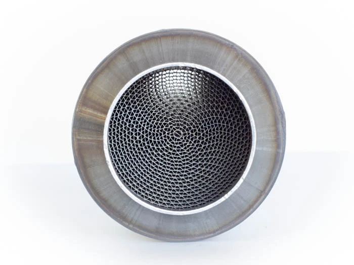

The modern "airless" catalytic converters are design to work with a leaner, cleaner exhaust system that is found on newer cars with a much more advanced computer and sensor system. The 86-95 5.0 Mustang system is primitive in comparison using an old, slow 15 MHH, 16 bit computer. On top of this, most of the engines are loose, burning oil and many have air/fuel ratios purposely manipulated to run at the rich end of the range. The result of both these problems is higher than normal HC levels at the catalytic converter input.
Newer engine have tighter manufacturing tolerances that translate into lower blowby and less oil consumption in the combustion chambers. The newer generation of engine management computers are running at 150-500 MHZ or more and some are even 32 bit units. More speed, more processing power and for all practical purposes, real time engine control. All this increased processing power means that the computer isn't playing catch up while calculating the input from sensors. That sensor data is used to to make decisions about the next event the computer controls like air/fuel ratio, injector pulse width and ignition timing.
At 6000 RPM, the computer has to calculate 400 firing cycles per second. That translates into checking air/fuel ratio 400 times per second and and spark timing 400 times per second, all the while monitoring the knock, air temperature and coolant temperature sensors for signs of abnormal engine operation. That's just the very short list of what the computer is doing.
All this extra processing power results in an engine that has lower emissions, lower fuel consumption and the best air/fuel ratio for the performance demands at hand. The catalytic converters have lower HC and NO demands placed on them. Because of the lower HC levels present they don't need the extra air provided by the Thermactor Air System (AKA "smog pump"). Run one of the newer "airless" catalytic converters in the relatively dirtier exhaust environment of a 86-95 5.0 Mustang and it will coat the catalyst with unoxidized HC . This will decrease the efficiency of the catalytic converters to the point that they start to clog and restrict the flow of exhaust gases through them. By the time a decrease in power is noticed, it is too late to take remedial action to save them.
I do not disagree with what you are saying,in fact-that's one of the best,most informitive examples of converter tech I've read-but I do believe as advanced as after market technology has come since the fox era-that the manufacturers of high flow-performance oriented converters base the design of there performance/high flow converters on example/scenarios like what you laid out in your post.

There's a thread around here that a member passed smog inspections for 5 + years with spun metallic converters all while running road courses etc consistently .
As always-thanks for the knowledge @jrichker -another thing I have a slightly better understanding of :-)
