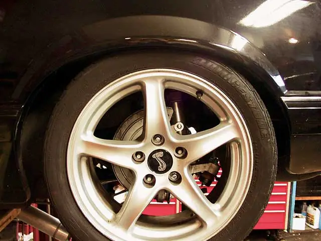

This does't look too bad:
Oh, and the wheels I want to run in the rear are 18x10, +38mm Offset, 7.0" backspace. I know it's pushing it, but it would be kick ass!
