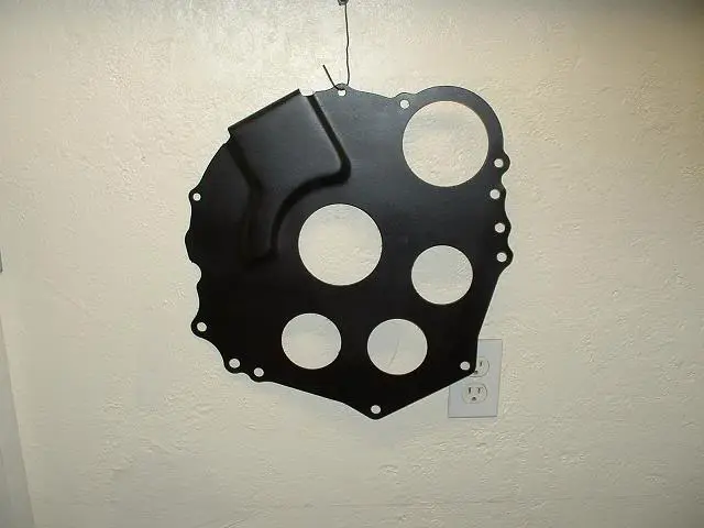

AOD TO T5 SWAP
I just pulled the motor and AOD out of my 91 gt 5.0 today. I am changing out the AOD to a T5. Is the spacer plate between the motor and flywheel the same as a stick setup?
Also do i have to change the front yoke on the driveshaft? Any other info you can give is appreciated!!(pedal swap for clutch pedal)
Thanks, a former AOD stanger!!
the t-5 drive shaft yoke is the same as an aod so your good there.
you do need a new seperator/block plate for a t-5, their different, the aod is basically a 2 piece ( the plate and the inspection cover) the t-5 is all one piece with some other differences as well.
here's a pic you can see the diff, this is a t-5 plate
