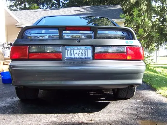

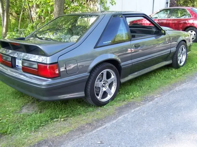

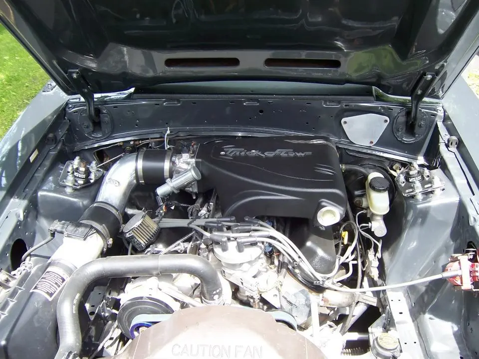

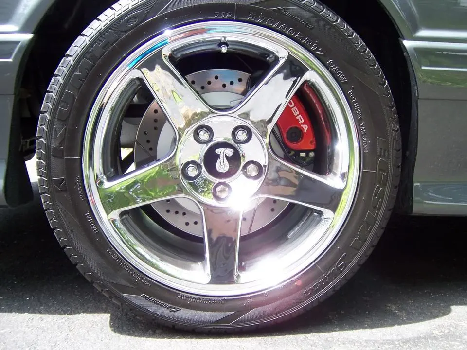

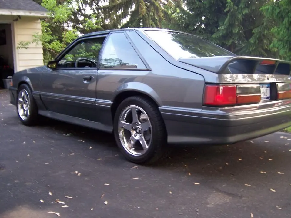

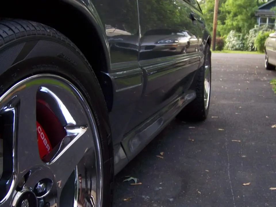

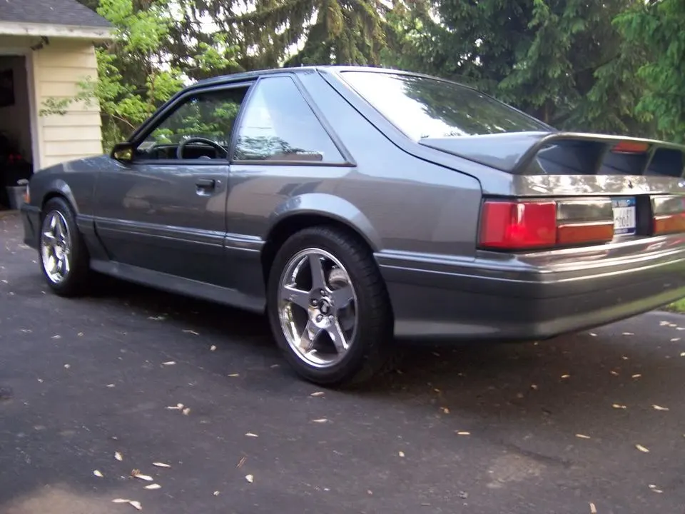

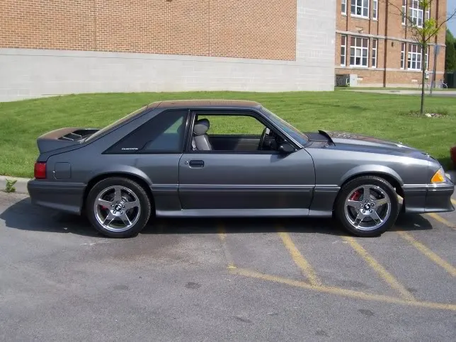

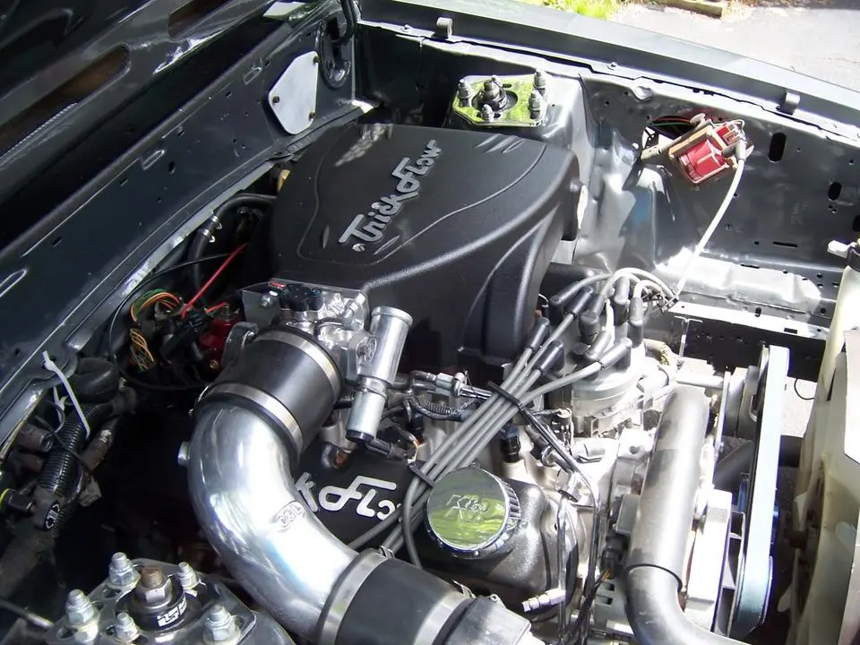

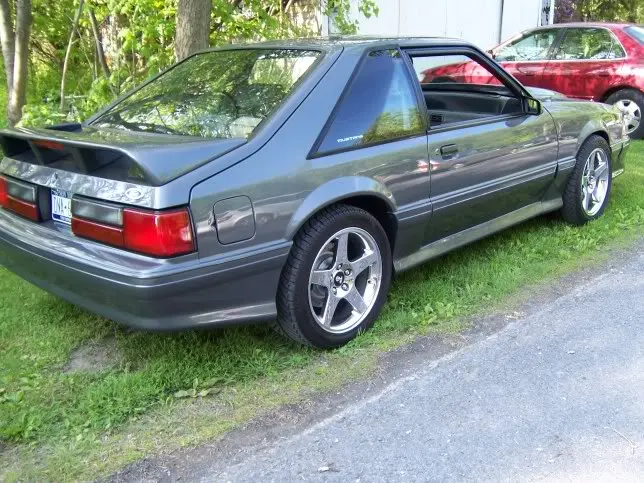

Couple pics of my ride
Oh yeah, I should probably list my mods
Engine:stock bottom end, TFS track heats, N41 cam, 24's, C+L 76, K+N panel
no PS/AC/Smog, 1.7RR's, underdrives
tranny:stock t-5
exhaust:1-3/4" LT's, off road h, flows dumped
rear: 4.10's,superior 28splines, aluminum D/S
brakes: braided lines, cobra 13"
misc: upr kmember, arms, coilovers, flaming river rack and steering shaft,
battery moved to rear, bunch of other crap i cant remember
:nice:
eww at the last pic

Thanks for the responses guys. Next step for this car is thru-the-floor subframes, then probably a s-trim, or a 150 shot of juice.
Oh yeah, that LS1 in the reflection in the last pic is 380 to the wheels, in case anyone's interested.

How do you like the N-41 cam? I am thinking about replacing my TFS stage 1 cam with it. Sick car by the way:nice:
Thanks. car definitely turns heads these days when there is not a lot of sweet 5.0's left in my area.
I love the cam, I misstyped though, it is actually the N21, but with 1.7's it is supposed to be the same as a N41 with 1.6's. It has a pretty nasty idle, but doesnt seem to run real well under 2200-2300 rpm's, it bucks a little bit.
I think this could be tuned out easily, but haven't got a PMS yet, and I don't really want a chip. The car pulls like a mofo from 3000rpm's to the limiter,
enough to run a 110 mph trap speed with 10 degrees initial timing and 38psi of fuel.
I hope to get 12.2's or better with this cam after suspension work.
Yeah the N21 should be the Same thing as the N41
with 1.6 rockers. I wanted my car to idle smooth that why I went with the Stage 1. But my neverending hurt for power has kicked in, so I think I can deal with a little bucking at low rpms.
