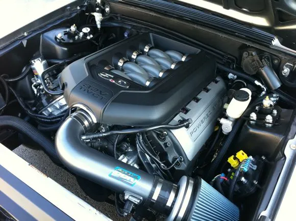

Have you seen our very own "Built to Cruise" project? That's some pretty detailed work right there!!!
Check out the link -----> http://www.stangnet.com/2010/02/27/stangnet-built-to-cruise-project/
