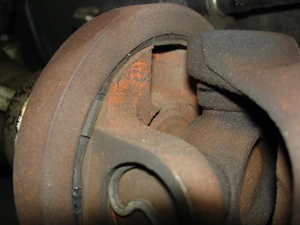

Back story: Car started having serious vibrations. Took it in to the shop and they replaced the U-joints. Drove it home and the vibration was significantly reduced, but now on deceleration I could hear/feel a soft grinding/vibration. I was slammed at work so couldn't get car back into shop right away. A couple days later the grinding part of the noise went away but I still felt a slight vibration at times. There was no heavy driving during this time just to and from work on city streets. Now a week after I had the U-joints replaced the mechanic showed me this dampener on the driveshaft (DS) is cracked. (image below is of part, found on another thread, not my part that is cracked)

The 4cyl driveshaft is different than a V8. You cannot interchange them. The dampener is on both 4 and 8 cyl automatic cars.
Just remove it. If you look at the replacement aluminum DS Ford sells, they fit both T5 and AOD and do not have the dampener. If you notice excessive vibration you may either need the DS balanced or find a stock/alum replacement.
All AOD's come with that dampener. I'm currently using the one that came on my AOD car as a plug for the old AOD when i ripped it out and put a 5-spd in.
So the info about them only being on the 2.3L is incorrect.
Just buy the AL driveshaft. Not worth putting $$$ into a stock one.

those dampners can be found on many cars from the late 70s on. they replace the weight that was bolted to the trans tail shaft on many cars. you can remove them without issue, but as noted be prepared to rebalance the drive shaft if needed.
