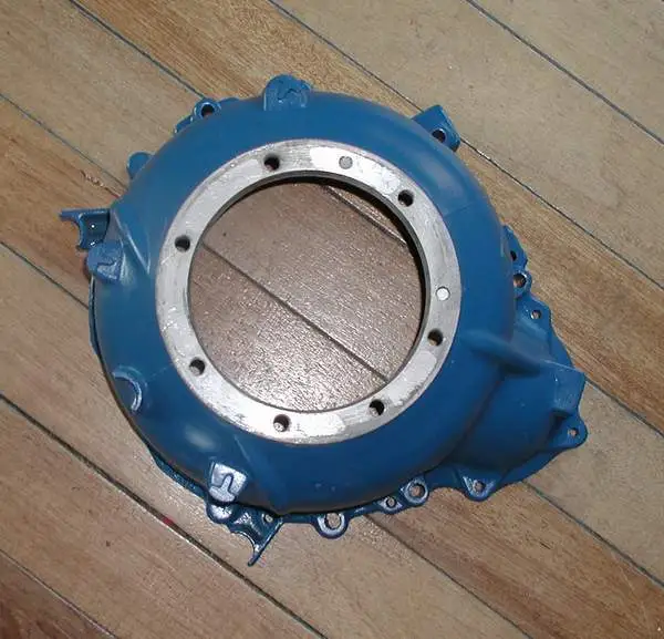

I have one that is in excellent shape out of my 68. If it will work for you let me know and we can work something out. PM or email me.

Thanx for the offer on the bellhousing, it's the wrong one. I have a 4 bolt trannie.
