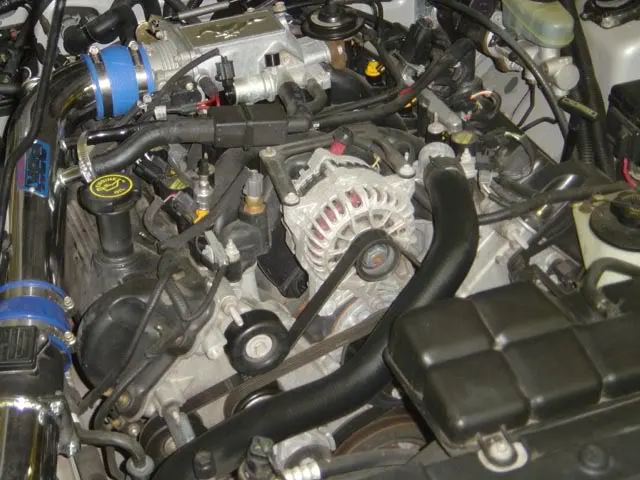

On the plastic versions you can see the front of the intake that passes behind the alternator is black plastic. On the aluminum versions this piece is going to be silver aluminum. The picture shows the plastic.. I would change it as soon as possible, I sat on mine for 2 months (That I KNEW it was cracked and leaking) and it ended up wrecking my cylinder head.
