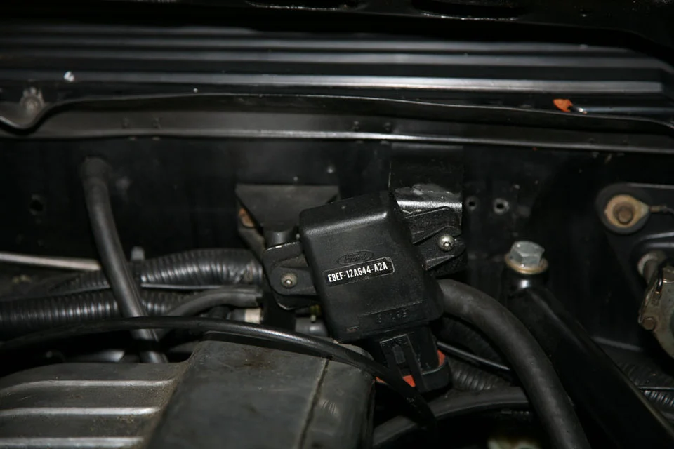

Check for 5 volt Vref on the orange/white wire at the firewall mounted MAP/Baro sensor. Good 5 volt Vref there, then the problem is in the 10 pin salt & pepper connectors or in the engine mounted fuel injection harness.
No 5 volt Vref at the MAP/Baro sensor, then the problem is either a broken wire in the main fuel injector harness or the computer has died.

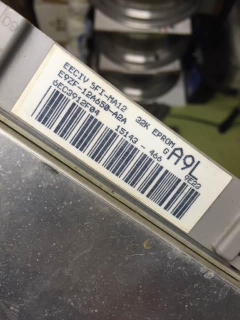

The ECM in the car looks like it has been "modified". No Ford part number and numbers scrolled on with felt pen. The Pro-Tech guy told me if I call my local ford parts guy and give him the VIN #, that they could provide me the part number for the ECM. Ford came back with F3ZZ-12A650-DB as the proper part. So Pro-Tech had one for $550 "smakaroos" and it is on its way. Ford must have superceeded the F1 part number at some time.

Sounds like an A3M computer, which is a 1993 5-spd ECU. You could even go with an 89-92 A9L if you wanted, they are more common, and a bit more desirable. And yes, a factory ECU should be able to run the car fine despite mods. And wow, holy crap $550! I wonder if snagging an A9L would have been cheaper since it was available more years than the A3M.
Do you know the history of the car? Original 5.0 car and 5-spd? Reason I ask is because having an incorrect O2 harness (there are auto and manual versions) in a car has been known to fry ECU's.

Looked at the old ECM and it has A9L written on it in felt pen. I am supposed to send it back to activate the warranty on the new ECM.

Btw, not that you need the info now, but this is what was stock in there. A3M just setup a bit differently for emissions in 1993, but will still work fine

Mustang5L5's advice is right on target. The O2 sensor harnesses are different for 5 speed and auto transmission. Externally they look the same but they are wired different. Use an auto trans O2 harness on a car with an A9L or A3M and it will damage the computer. Be sure to check for 12 volts on pin 46 as he has advised you to do.
