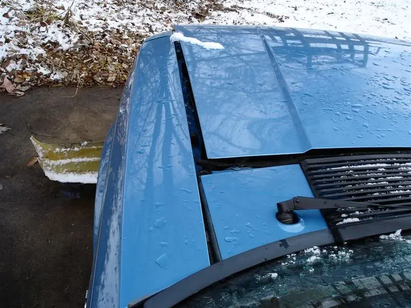

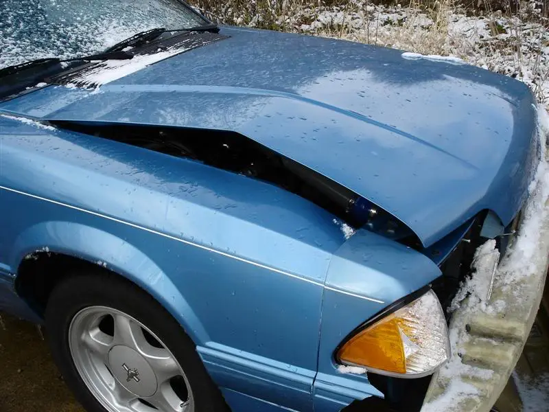

Aside from some back and neck pain i am ok, But i am not sure what will happen to the car. I would love to have some opinions on if this is repairable or not. I Only have liability insurance so if it gets fixed, its gonna take a while cause i have to pay for it. Here are some pictures..

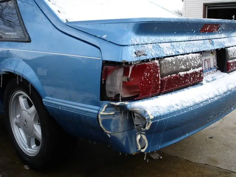

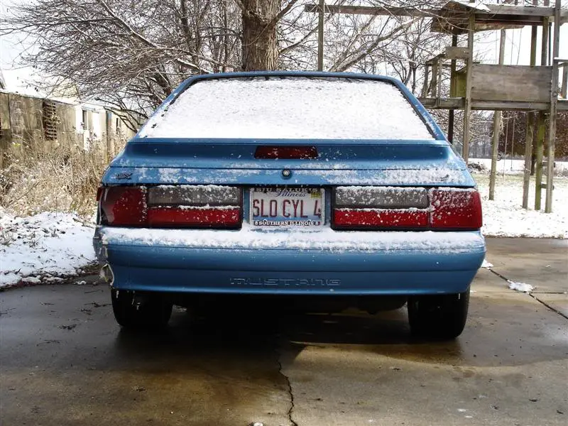

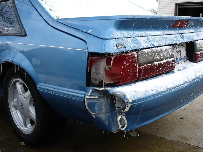

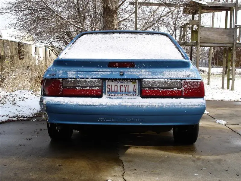

Rear is just minor, very fixable.

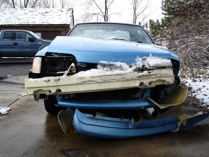

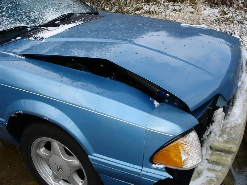

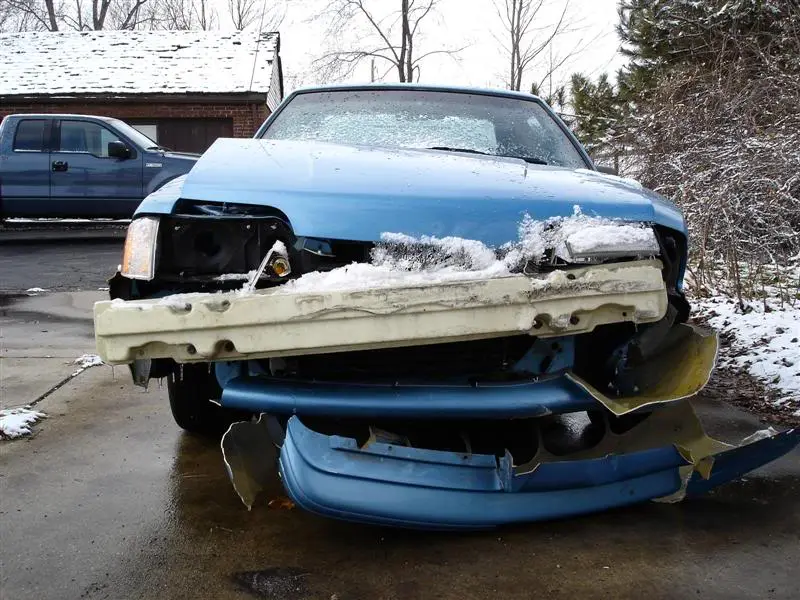

The front However didnt favor as well.. I would guess i was going 45-50mph when i hit..

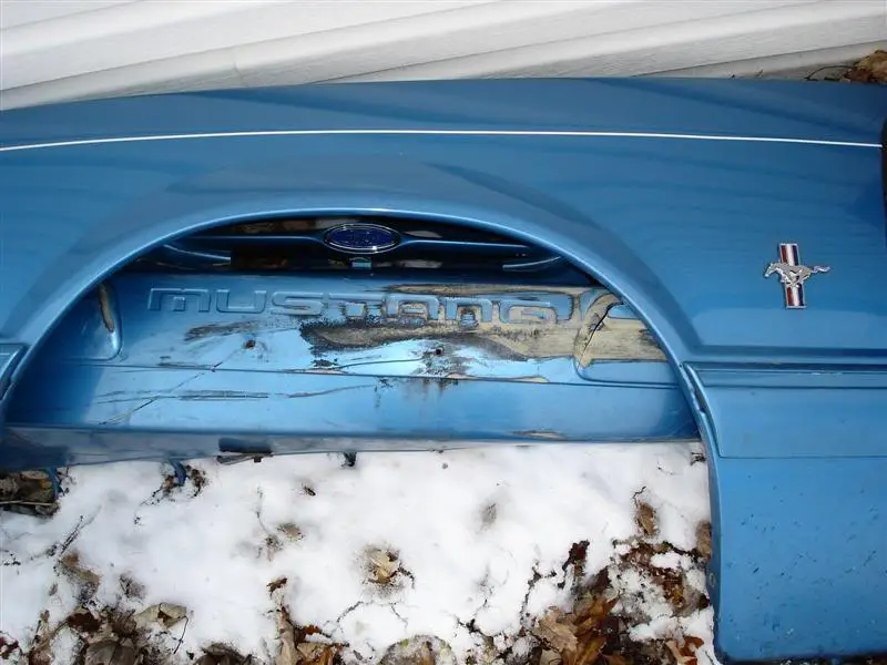

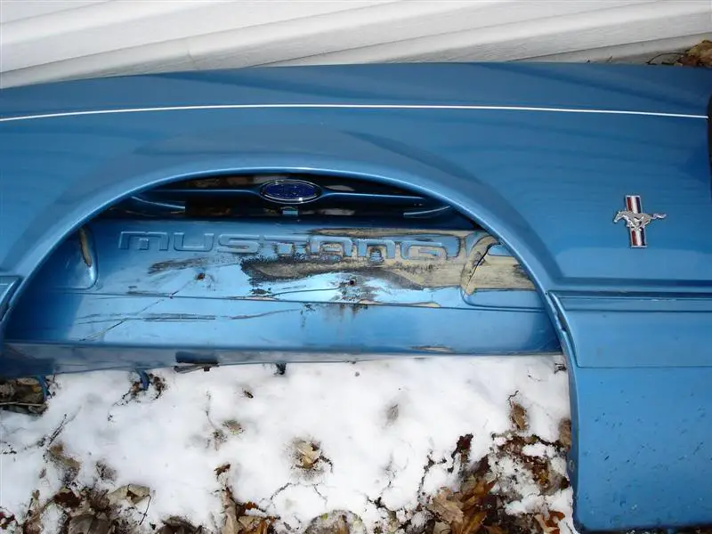

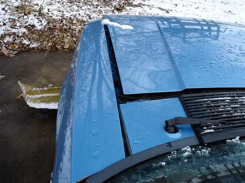

Hood Fenders, Bumper.. All trashed.

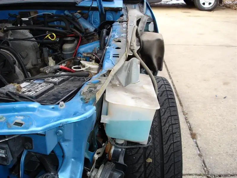

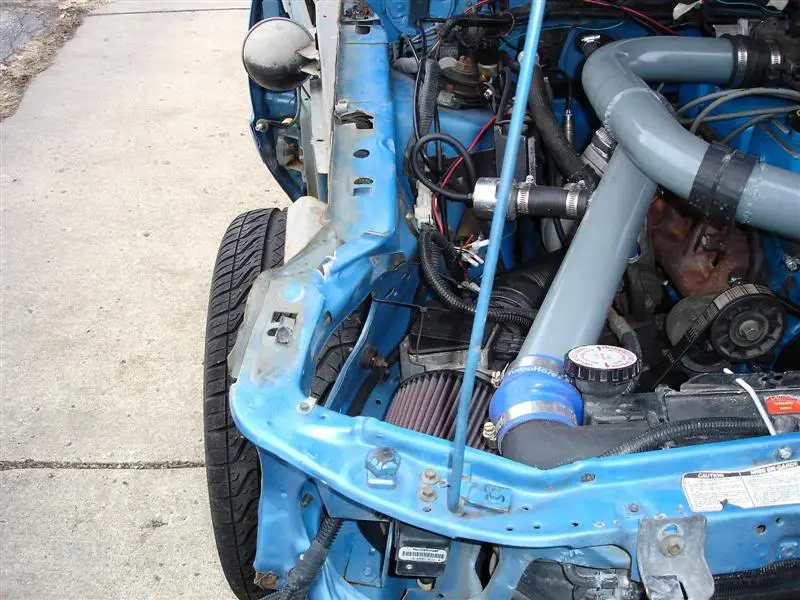

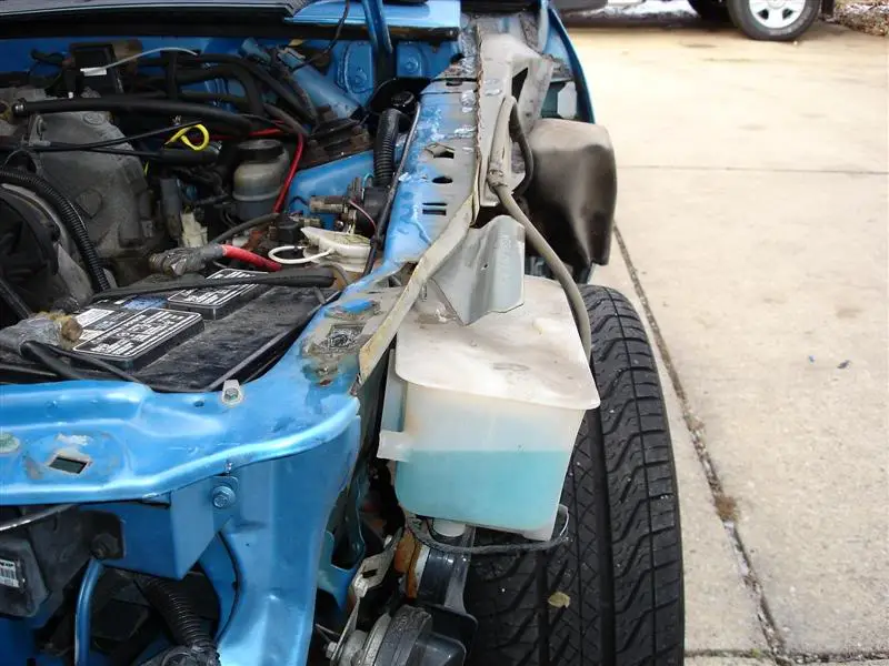

I actually have a set of fenders, And i needed a new hood and bumper anyway so i dont think thats a big deal, But here is what i am worried i cant fix.

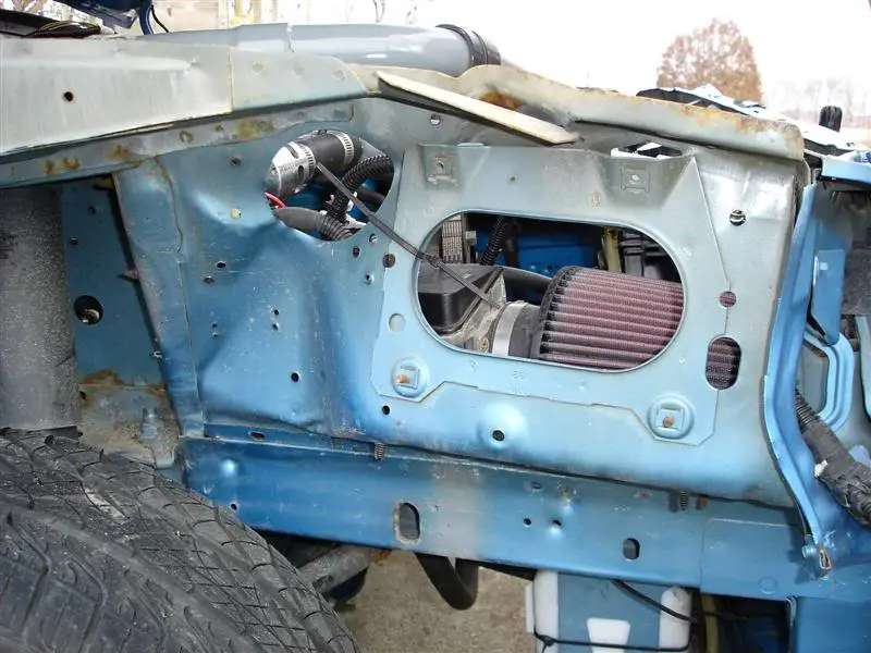

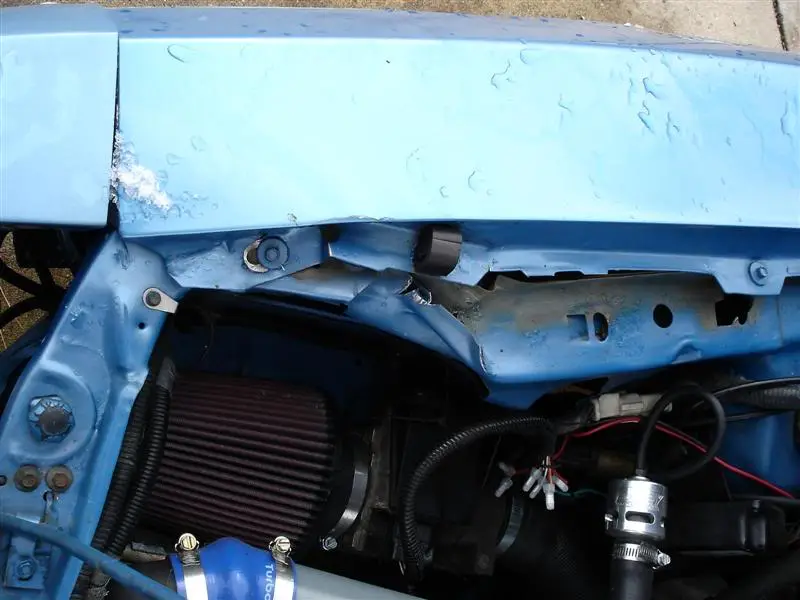

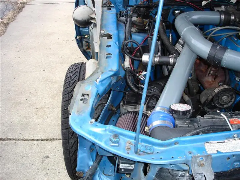

Look near the K&N at that Bend.. the whole area from there forward is racked toward the passenger side.
Can this be fixed?
The suspension seems to be ok, the Car Will NOT start, but its probably due to the Kinked IC hoses or IC damage i havent found yet.
I really love my car, and it kills me to see it like this, I need honest opinions though, its this something i (a body shop) can safely repair?

Glad to hear your okay. Reminds me of my accident when i got hit by that truck. She's banged up pretty bad. Hopfully no frame damage or nothing to expensive. Probably best bet is to get a front clip. I see your in illinois , if you check A-Affordable's they usally have a few laying around that are in decent shape. I think its in downtown Joliet.... IMO i would fix it ONLY if there wasnt any terrible frame damage. I had one like that and it never felt the same and always sat kinda funny even with all new suspension.... Good luck and i hope you feel better!
im not a body man but i do know that parts for mine and yours lx are dirt cheap and easy to find. ive seen worse im sure it can be fixed. insurance would take one look and say it is totaled because last timed i check (this was for my 88 GT) it was KBB at 1,500. so its gonna have to be done out of your pocket...snow sucks i have taken down my LX and my Jetta GLI for winter. hope things turn out well cars looks awesome and very clean.
have the frame done at a GOOD shop and use all used body parts and you SHOULD be ok, but it will be pricey. Insurance will DEFINITELY total the car, but you can buy it back and use the check they cut you (wont be that much being that its a 4banger) to buy parts
glad you are OK...i followed your website on the buildup...i love the car man, dont give up on it UNLESS it really is worse than it looks. then let its soul live on in another clean LX :D
I really hate to say this.... but Im pretty sure the frame is bent. The core support is pushed in and the inner fender area is wrinkled nicely...
it can be repaired however time on a frame straightner is expensive. But I dont discourage you trying. Glad you made it out alive could've been much worse.
Doc, my condolenses! That bites! Don't give up, you built a really nice car from the ground up! I have to agree with some of the other guys, though. You probably have some frame damage, wrinkled fender aprons that you'll never get straight and maybe some suspension damage.
I say, find another unmolested hatch or notch, pick it up and swap everything over. It'll be cheaper, better and safer in the long run.
Good luck, my brother!
I think it's repairable, bodyshop guy in my area usually ask 250$CAN to do this job... maybe it would be around 300$Us, 'cause it seems kinda F*** up..
I wouldn't say the frame is bent.. take the hood, fenders away, and look for damage to the frame..Just to be sure..
When you look to the front view pic.. the car seems to be lower on the right side.. :(
It might cost you approx... I would say.. 725$US to get all this fixed, not painted.. if the frame is okay..
Good luck!

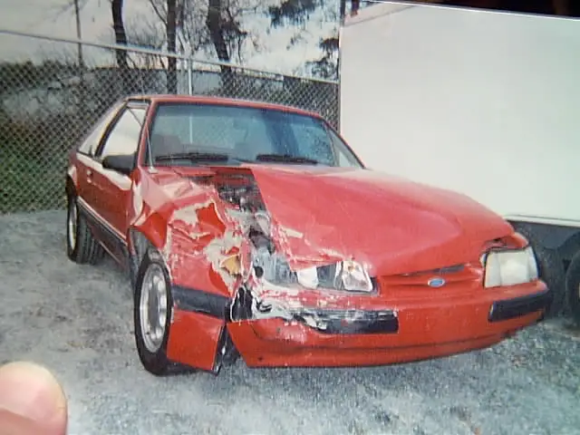

Anyway, DR, this right here is a picture of my Mustang when I wrecked it real good back in November of 2000 (plowed into some woman who pulled out in front of me at an intersection). The accident was ruled no fault and I had no coverage on the car and my dad decided to fix it. It ended up costing over $2000 to fix (which is what I paid for the car in the first place). What they did was cut the subframe and inner fenders off in front of the strut towers and weld on a new subframe from there forward. I don't want to be the bearer of bad news but you're probably looking at some big bucks to fix that car.
attachment.php
(sorry for the poor quality, it's a picture of a picture)

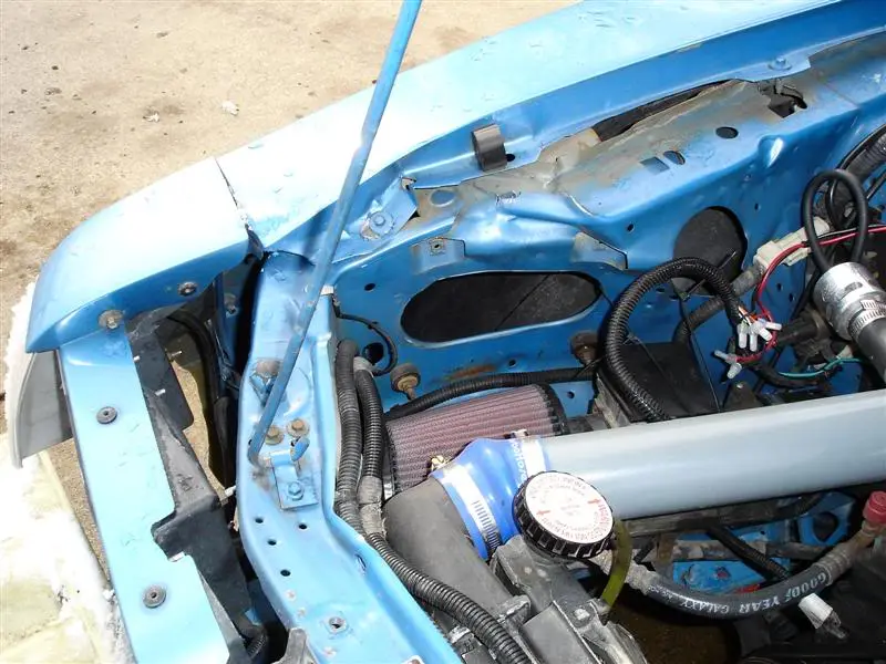

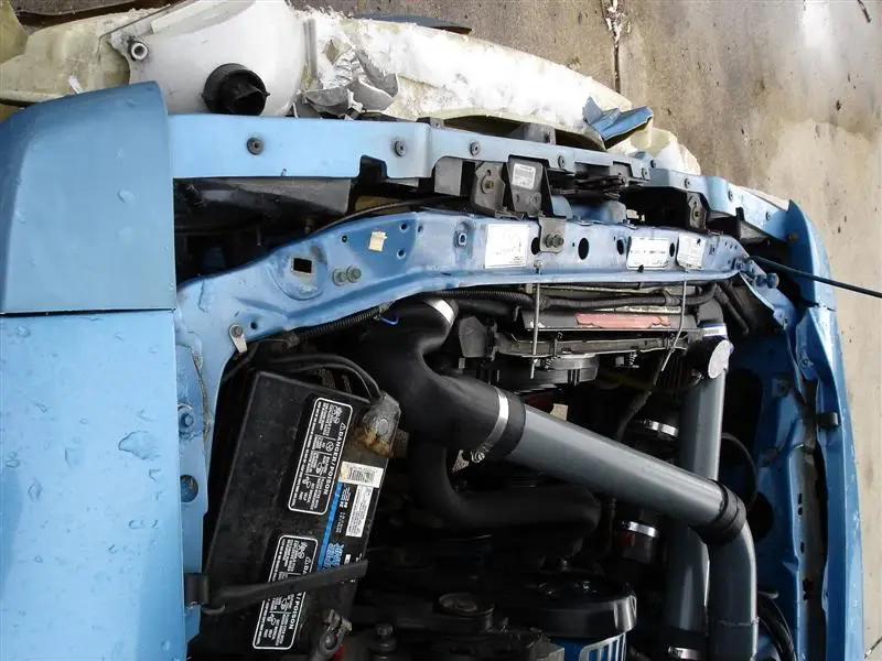

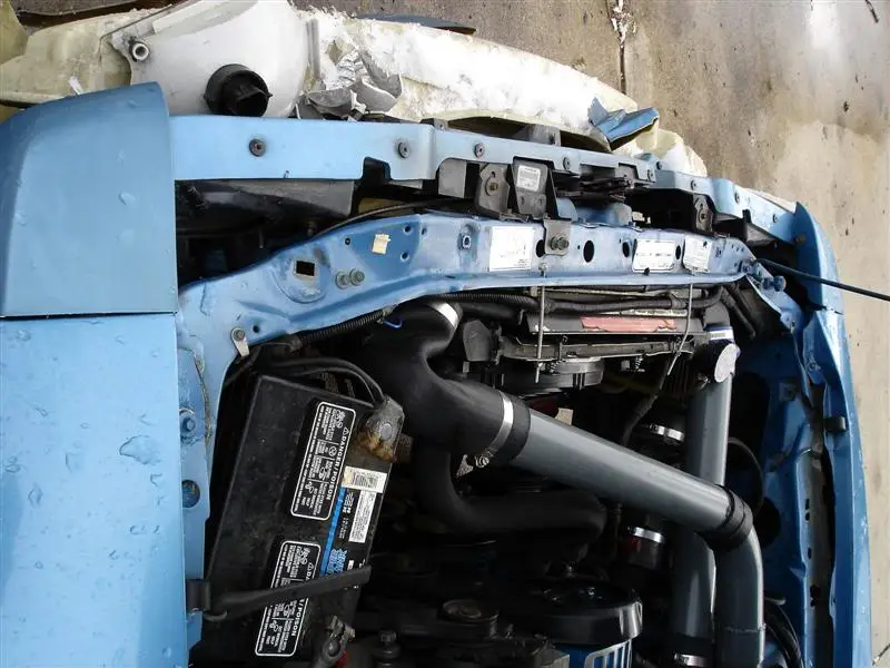

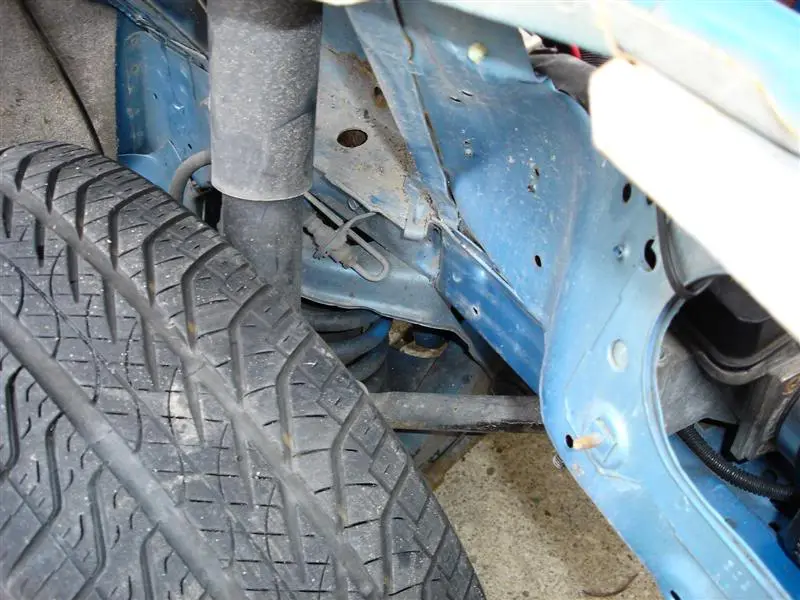

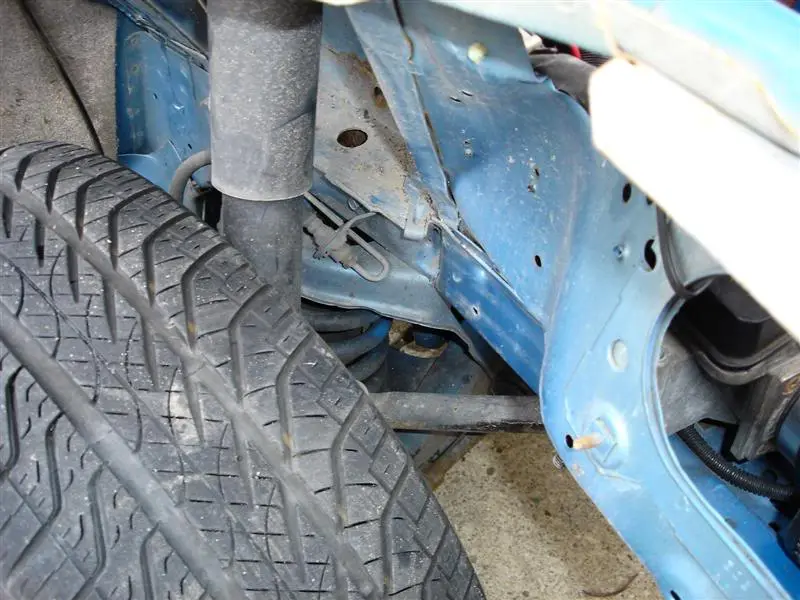

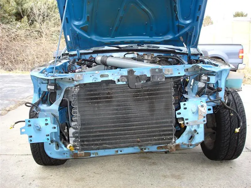

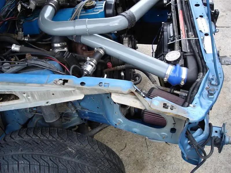

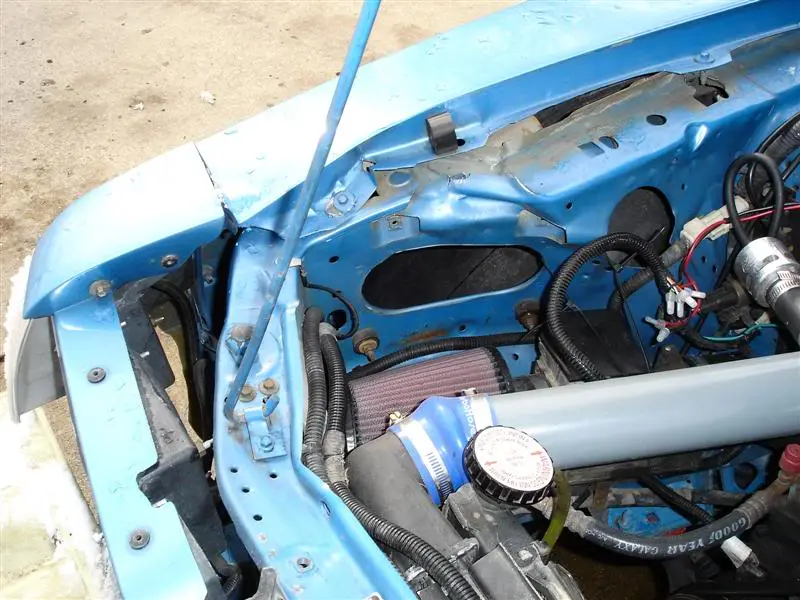

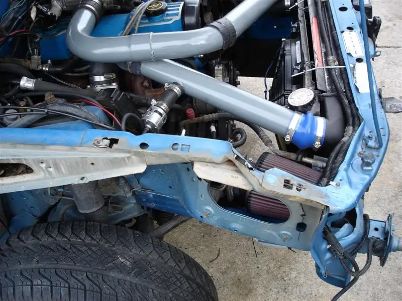

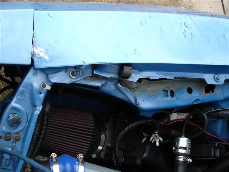

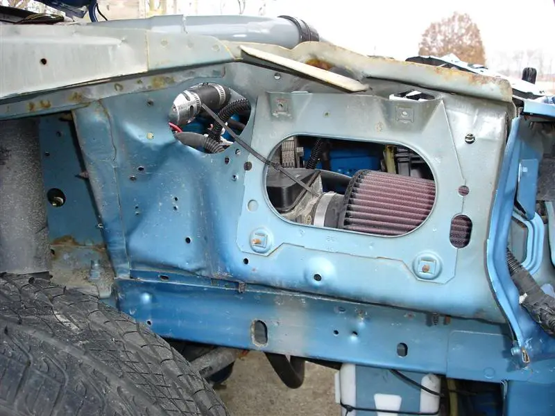

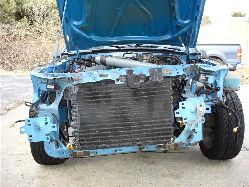

Thanks for all the support Guys.. its really is like losing a Friend to me.. I do have an update though, After i got off work today my dad and i tore into the front end to see what was underneath. I have pictures of what i found that i will post below... I think its saveable, but i am not a body guy so dont take my word for it, It does looks like the suspension is Intact, and it appears the Upper strut tower support stucture is undamaged. I am friends with a body/paint guy that works out of his garage, and he knows a guy with a Hydrolic frame machine that he can use so i may be able to get the front pulled back for cheaper then normal, Also if i cant make the front straight he told me i might be able to clip it right about the front of the motor and replace it. So i have a few options. I am gonna wait till he actually sees the car in person to decide what to do next. I DID get the car started and it runs fine and drives and turns like normal. It still tracks straight.. i didnt do much driving on it though as i didnt want to get pulled over.. Here are the pics...
Let me know what you think now, I want to save the car if possible, but i still want it to be safe.
The Rad Support is racked Up and over to the pass side.
Pass side, the damage doesnt get into the frame above the strut tower.
This is my biggest area of concern.
Note the bent frame rail right near the Kmember mount.. Hopefully i can pull that straight on the rack..
Drivers side, its pushed in and up little bit, but really its not too bad.
Pass side again, good shot showing how much its pushed..

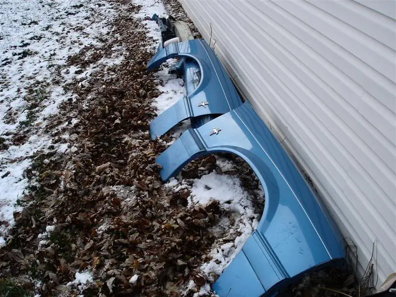

Rejected parts..

Why? The k member isn't even hurt...
Dr, there is no question it can be pulled back on a frame machine...it's amazing what the machine can do. The only question is whether the operator is any good with the machine. If he knows what he's doing, he should be able to pull it back so perfectly that you can just bolt a hood and fenders on and drive away...

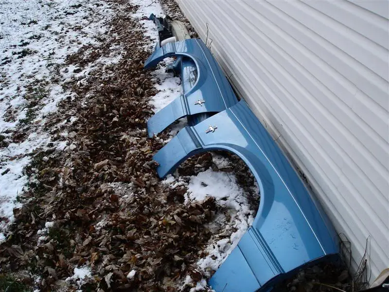

Looking at the fenders, are they even messed up? Looks like they are salvageable to me...
They have some pressure bends in them, on the top surfaces and around the wheel arch, They dont have any scratches or missing paint on them though.. I have some spare fenders i will probably bolt on, but in a pinch i could probably reuse the old ones after some gentle massaging.
