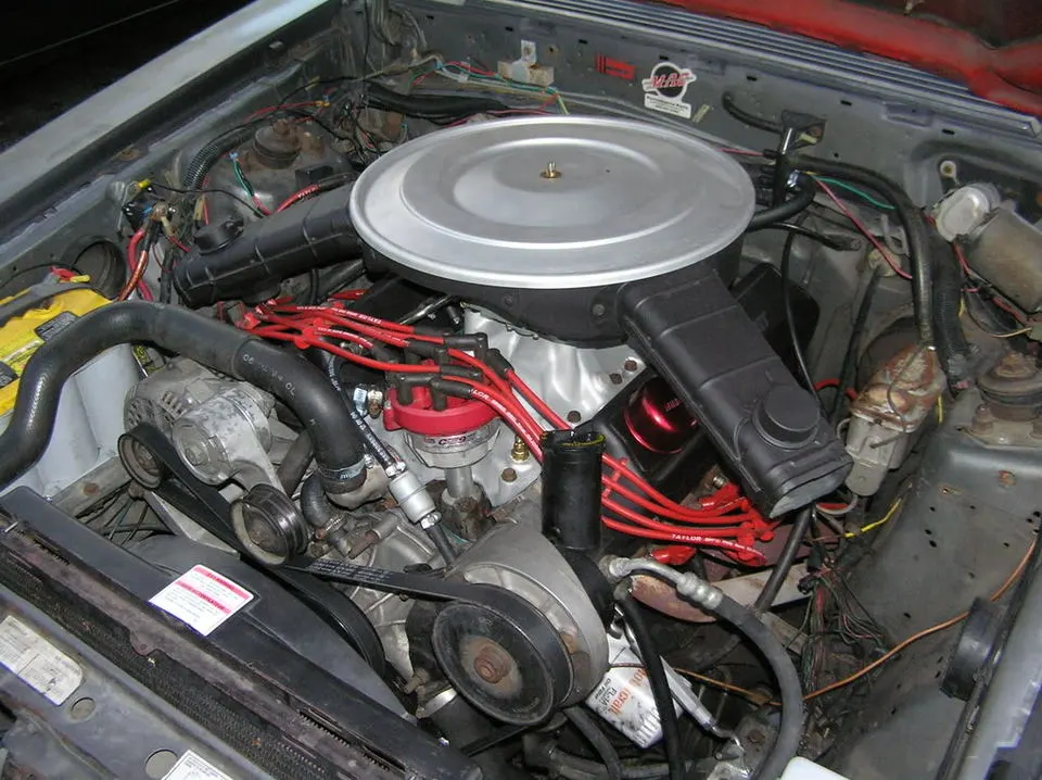

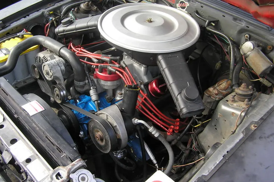

Funniest thing is, it looks exactly how it did before only cleaner and with blue paint. Works great for keeping it low key (until you start it..lol).
Before:
After:
