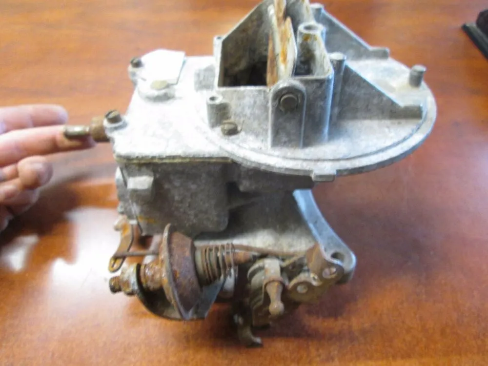

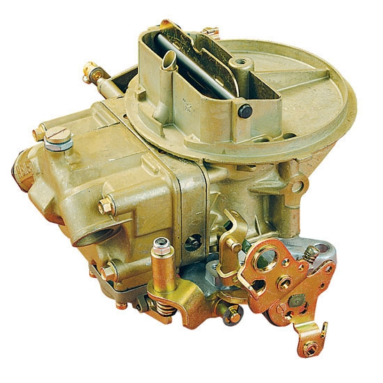

easy enough to tell which carb you have with one question, is the float bowl removeable? if so then it is the holley carb.
holley carb
autolite carb
tks for the info, i obviously have an autolite.
that makes things a bit tougher, but still doable. if you are careful you can use a bottoming tap to cut new threads, and then use a brass fitting to replace the screw in filter, and go with an inline filter.
be very careful though if you go this route as you MUST BE ABSOLUTELY SURE that you run the tap in straight and you have no margin for error. if you dont get it precisely straight, you will battle fuel leaks.

tks for that info, i am going to try the tap route and see what happens, if all else fails i will get a new carb.
more power to you. like i said use a bottoming tap, not a starting tap since you have no room to use a starting tap. the bottoming tap is flat on the end with no taper. and again make sure you get it as absolutely straight as possible. and take your time.
thought i had it, but it still leaked. sigh. Big Brown bringing me a new carb.
