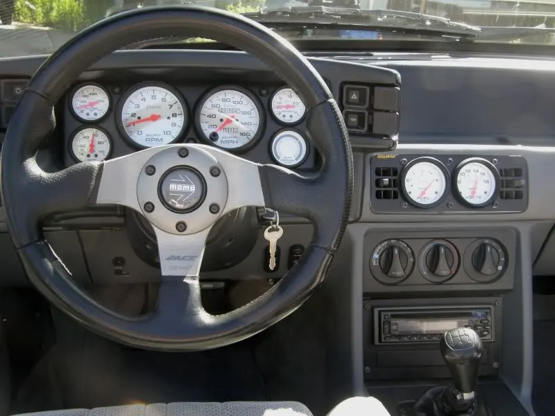

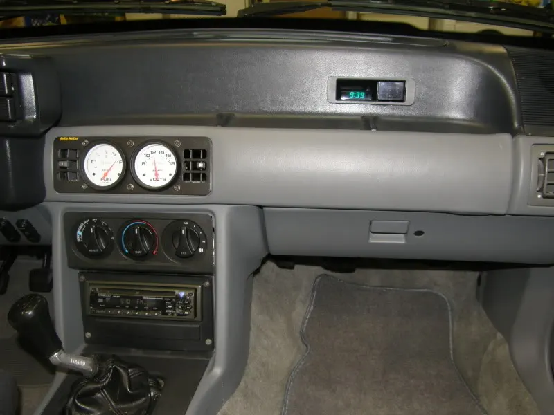

I did it a few years back in my '89. Relocated them and it worked fine and I used a Momo horn button. I found 3 old pics.
You can see 'em behind the hanging key.......
To the left of the heater controls.............
Here's a shot head on..............

There's a guy on the corral that was making the cruise adapter for momo wheels.
Not sure what an SVO style wheel is, but i would consider a momo monte carlo style wheel and the adapter instead.
Looks and operates right.
