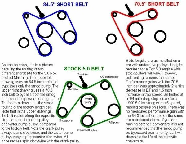

i have a csr electric pump with no pulley,no smog,no tensioner i have the adjustable alternator rod,i have no ac the power steering is up where the ac used to be anyone know haw i can run the belt?pics would be great.:shrug: :bang:
just one big circle around.like the red without the waterpump.
