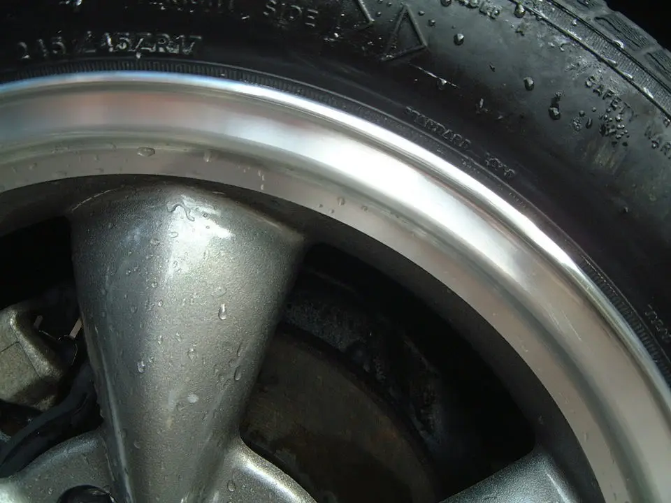

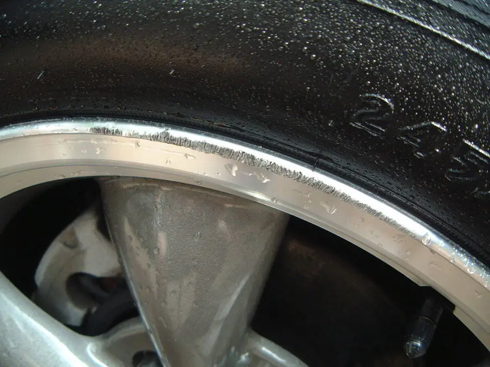

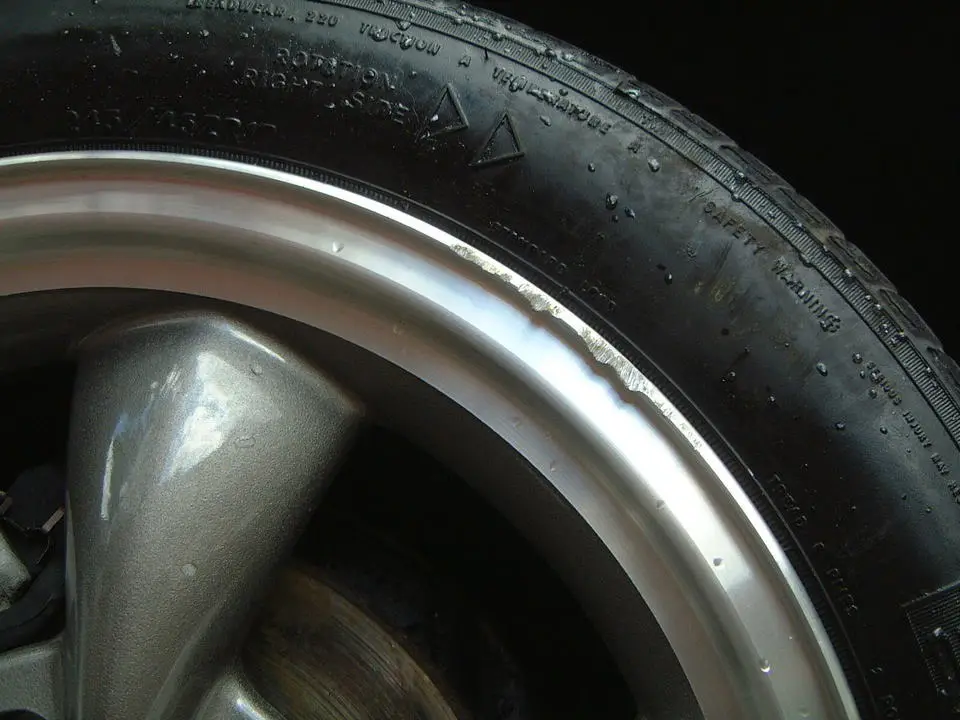

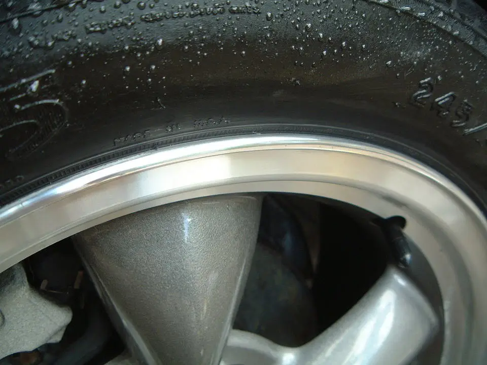

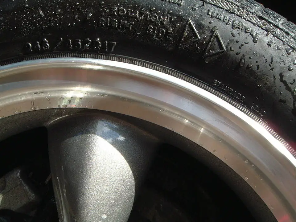

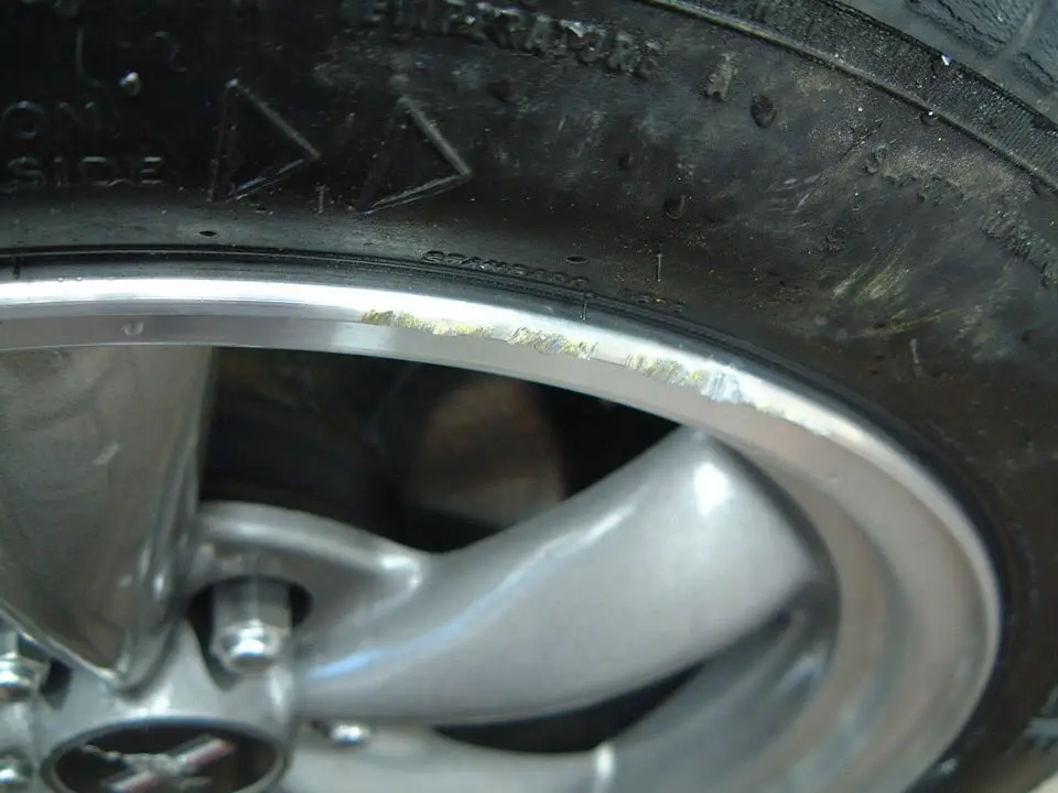

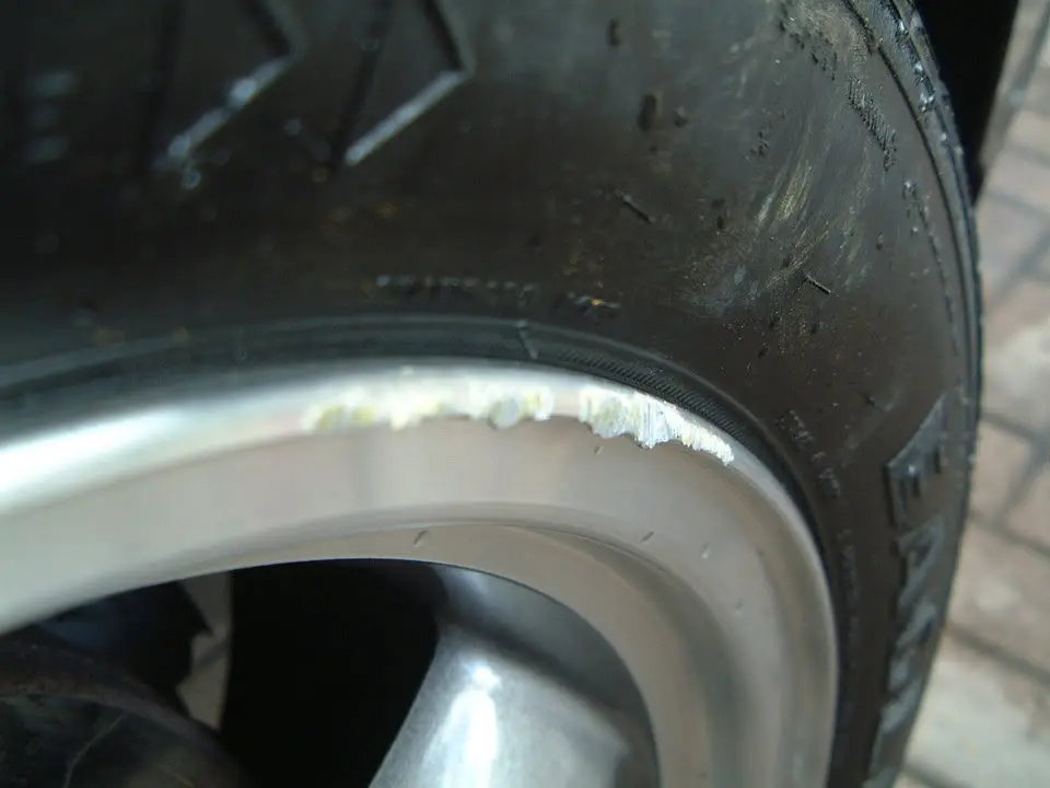

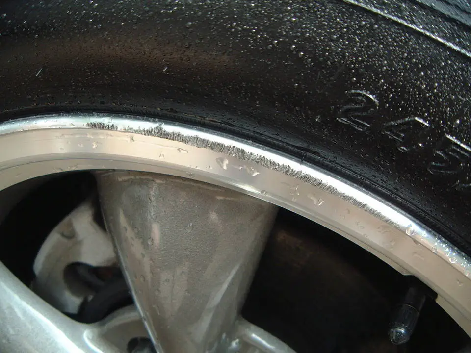

So yea, I got distracted for a second and I went over a curb in a parking lot and damged my driver side front rim.
So I decided to try to fix it. I can't make it worse by trying to fix it right?

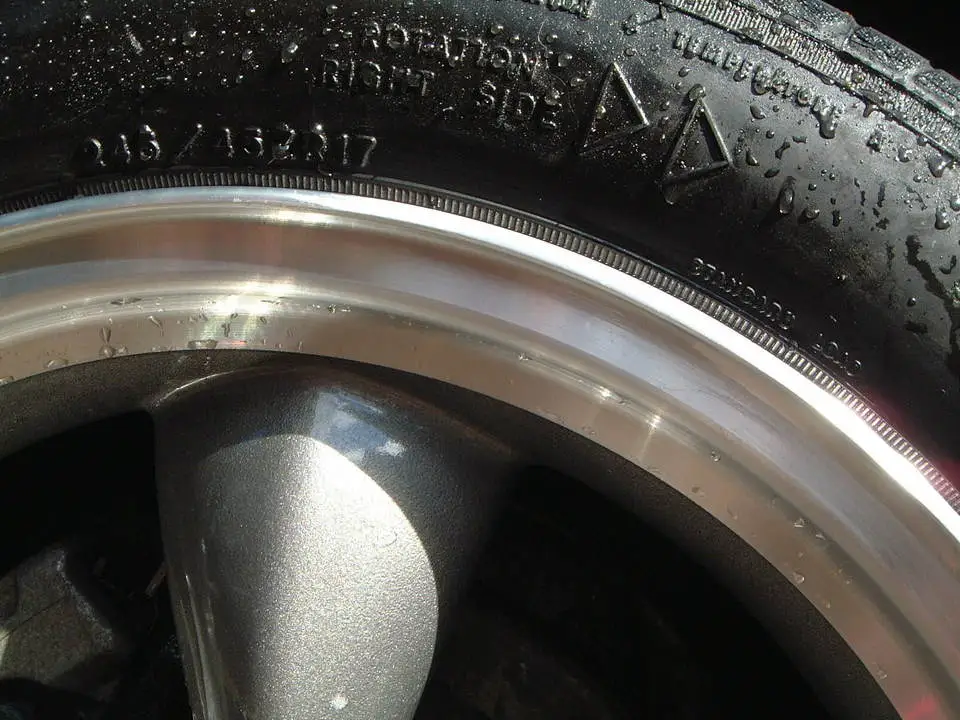

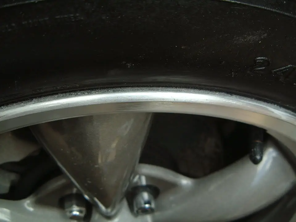

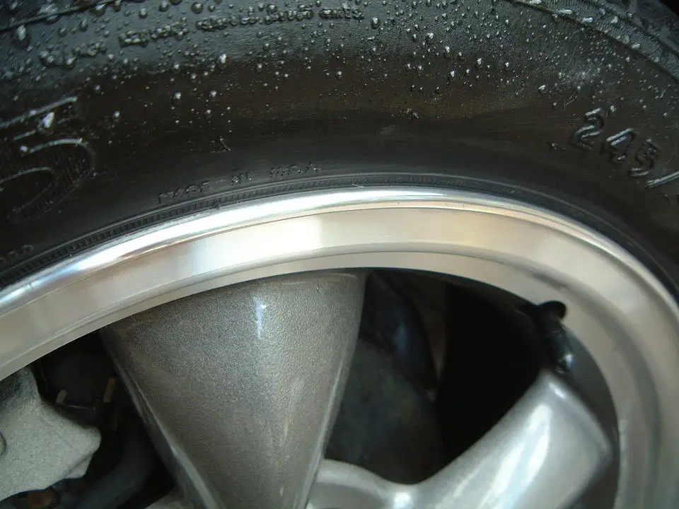

This is an old scratch the rim had when I bought the car
BEFORE
SANDING
AFTER

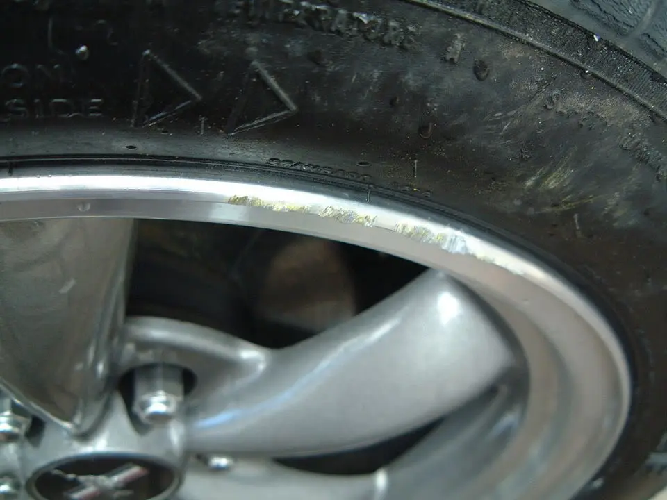

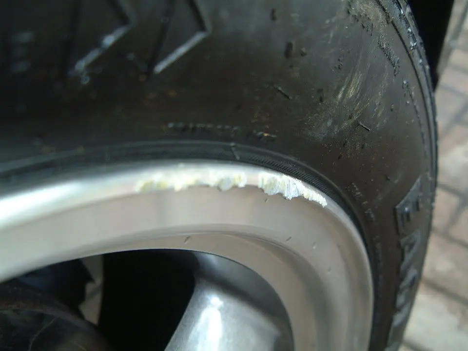

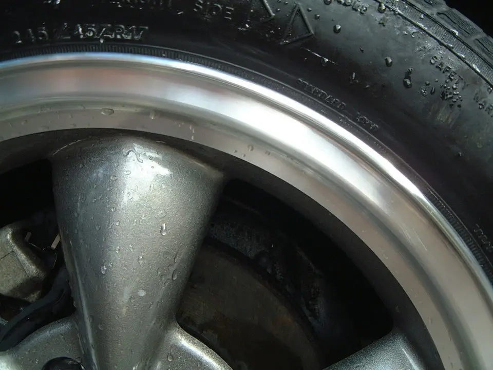

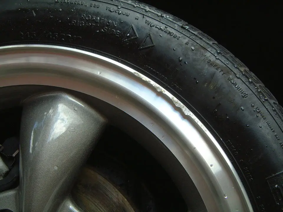

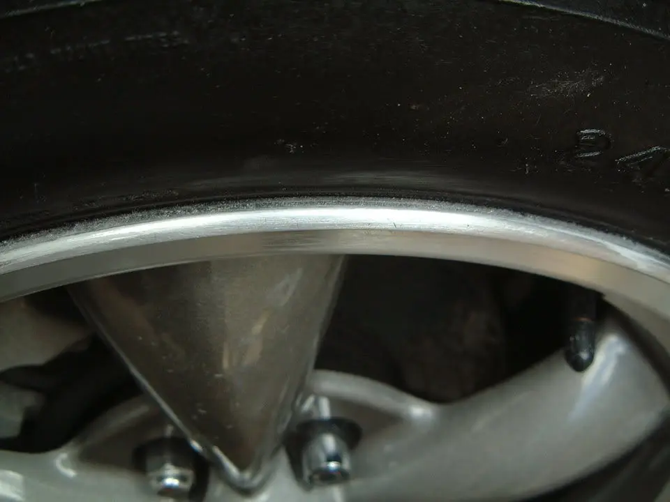

That scratch was no biggy, but this one, this is the one I just made last night. As you can see, I hit it pretty hard :bang: even though I was going idle speed.
BEFORE
SANDING
AFTER
Pretty happy with results. I've never done this before but it came out great. :banana:
Only costed 7$ CAD for sanding paper but if you know a bodyshop, you can steal it from them :p

All you did was sand that? I got curb damage too, and that looks great :D I want to do that, whats your process?
First, I used 80 grit sandpaper and sanded the area down until it's smooth with no pits and no scratches. The surface will be rough but it's normal. Thenn I continued sanding to blend the damaged area with the rest of the rim.
After, I used 180 just to polish the area.
Last, I wetsanded the area using 2000 grit sandpaper. Then I washed the rim, use rim polish to polish out the area and voila!
Pretty easy and much cheaper than to get it fixed at a shop or to buy a new rim.
One of my Bullitt rims looks exactly like your top pic. Exactly. I'll have to try your technique 'cause your results look amazing.
I'm going to go one step futher though and, after the "repair", shoot the spot with a misting of clearcoat (masking the rest) in an effort to help prevent oxidation.
