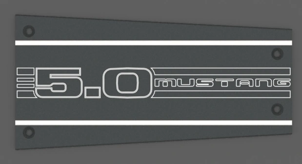

Hey everyone. I had posted several months ago about fabricating some custom intake plates. Well, I'm finally getting around to it again. I plan to cut the overall shape out of 6061-T6 on a waterjet. Then finish sand and powder coat in black, red, blue, etc. Next make an engraving jig to hold the plate while I post engrave the design back through the powder coat. Attached is a 3D rendering of one design idea in black. I can also do custom designs as well. Just wanting to get some feedback from other Mustang owners to see if there is even the slightest market for something like this. I'm working on a fox cup holder design as well. Shoot me any ideas you may have to. Thanks for looking.

man those lines look like some small ass cutters. the machine time must be pretty high... who much are you thinking per piece?

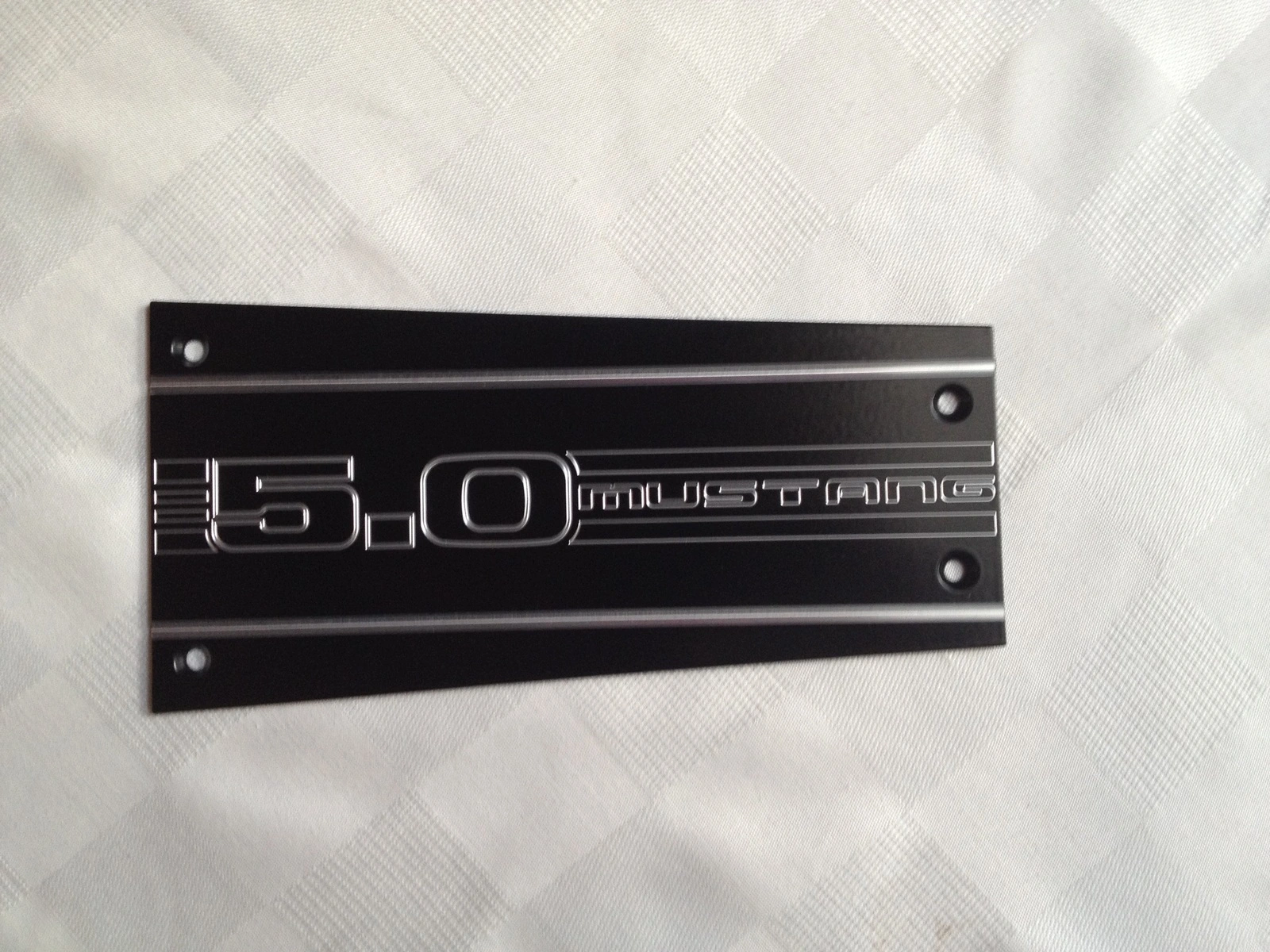

It would be a .030 dia 2 flute Ball End Miniature Carbide Finisher. Cycle time shouldn't be that bad. It only needs to go down enough to remove the powder coating. We've done thing with a lot more fine detail than this. Not sure on price. I was actually just making one for myself but I thought I'd throw it out there to see if there is any interest.

The Explorer/GT40 can use the same top plate as the stock HO 5.0 EFI intake. The only difference is the Explorer/GT40 only taps 2 holes diagonally opposite each other, and I think they are metric thread. That would have minimal impact on what you are doing.

srtthis, you called that one. With a ball nose that small, I could only run the machine at 7 inches per minute max. Factor in the finishing passes and it took 40 minutes for the "5.0" design. Good thing I don't plan on making these in mass quantities. :)

What kind of rpm are you running? We have some 15k rpm machines that would make quick work of that, we usually engrave with a #0 center drill at about 40 to 50 ipm
