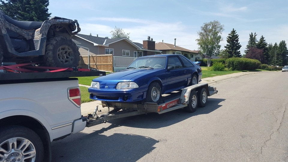

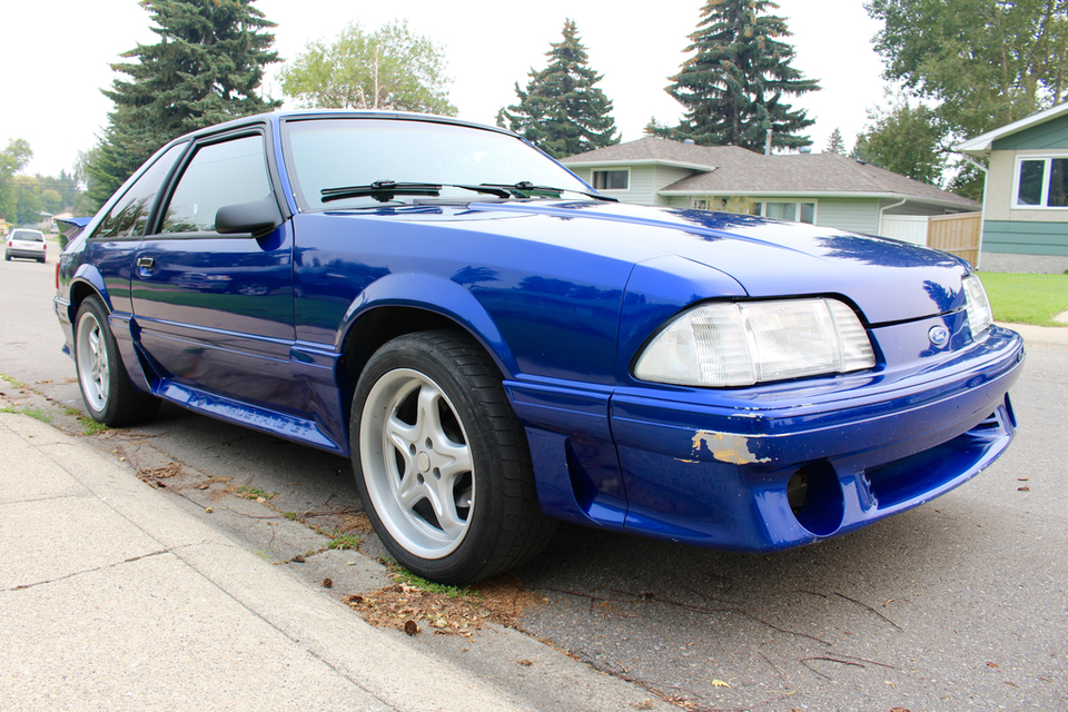

This is how she looked right after I picked her up:

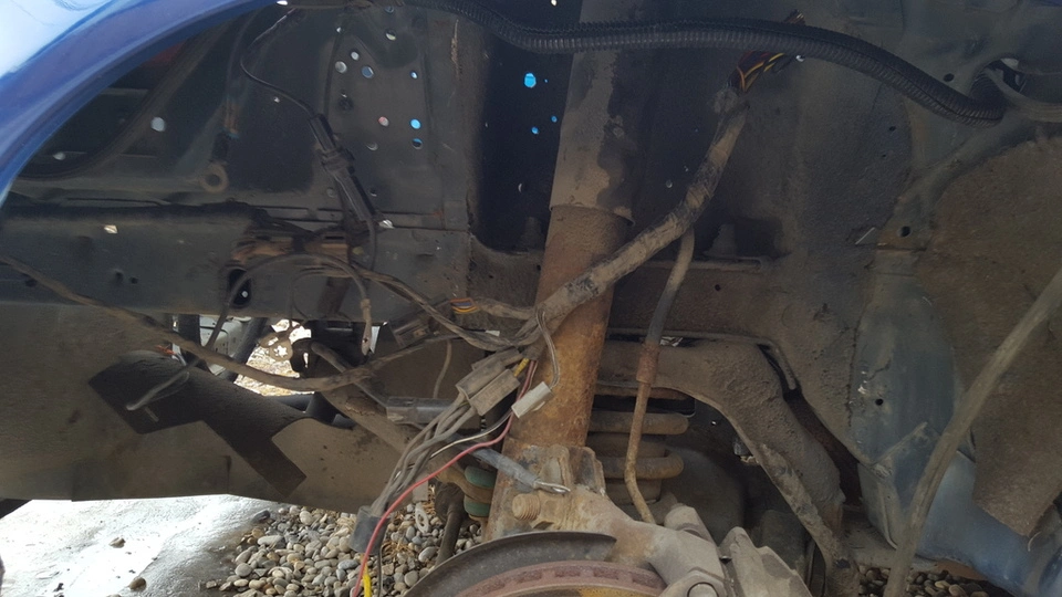

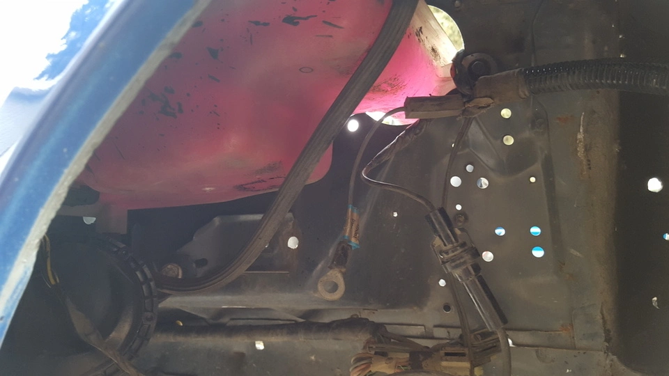

Right away there were some things I wanted to change, including the wheels. I gave her a much needed clean inside and out. There were some weird wiring bugs to deal with (Sub Wires, some sort of Kill Switch Wire under the dash) and I quickly got rid of those.

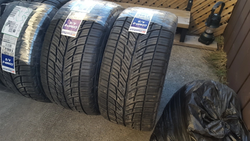

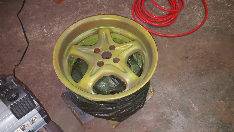

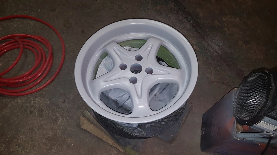

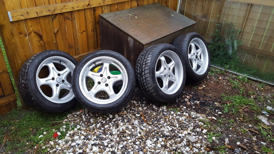

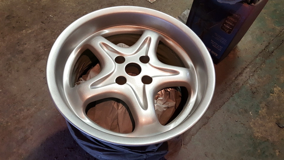

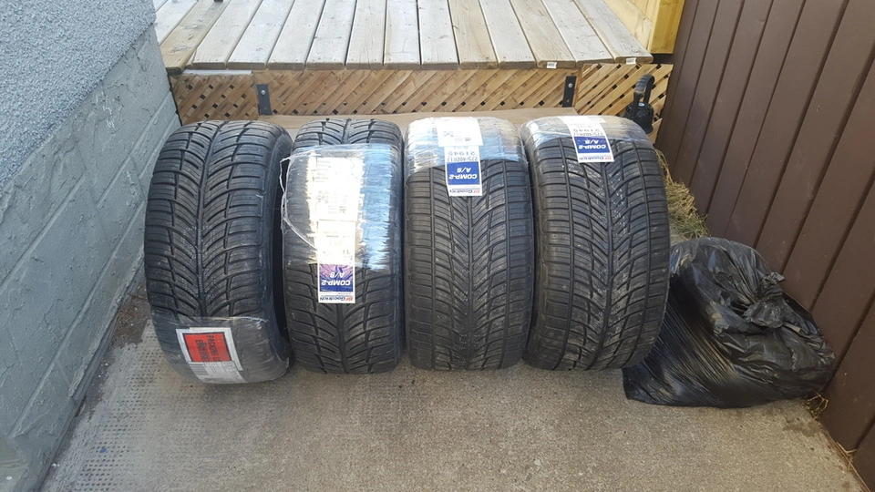

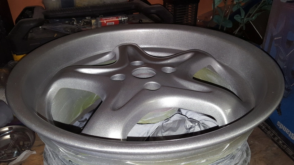

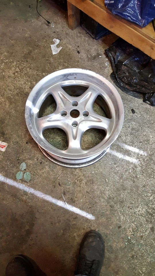

My first set of wheels after the Turbines were a set of 16" Ponies (sadly don't have any pictures). Then soon after I found a set of ROH ZS 17x8.5 on Kijiji and had to have them. They had a bit of curb rash and the clear coat is peeling, but I plan to refinish them before I mount new tires.

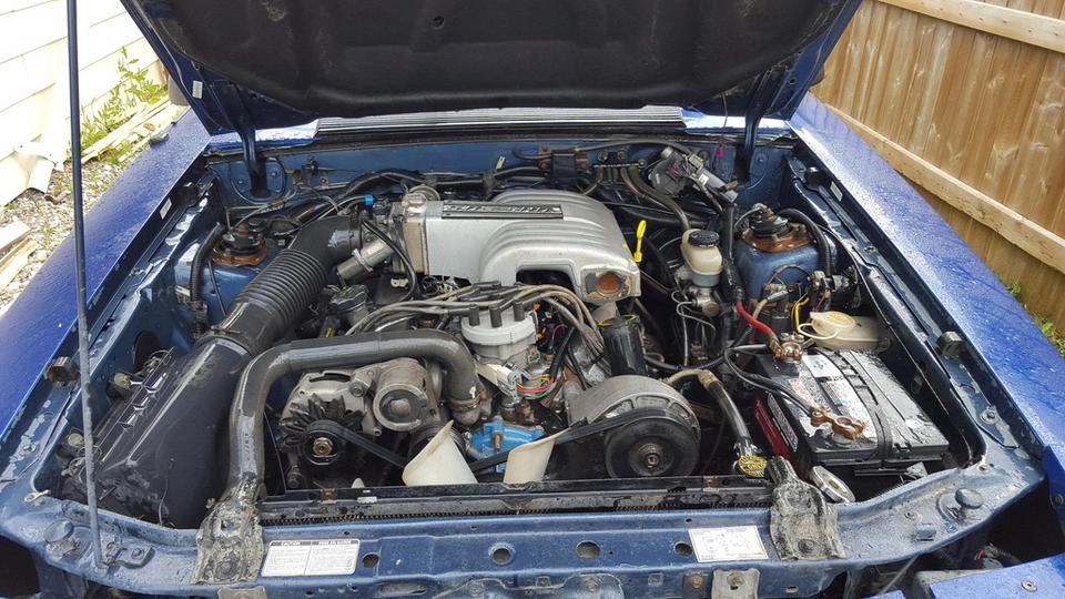

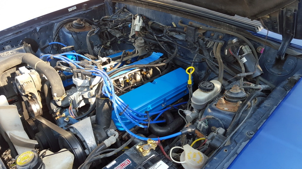

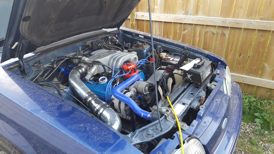

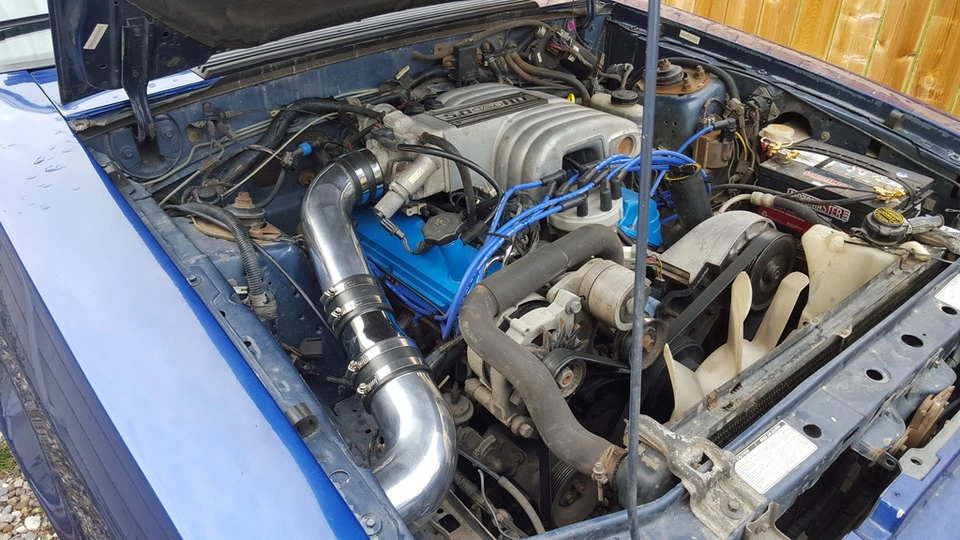

It didn't take long for the mod bug to set in, and I started small. I did the regular maintenance of changing the oil, new coolant, new spark plugs and wires (NGK to begin with, but now Ford Racing 9mm). Then I went ahead and ordered a SR Performance Cold Air Intake and BBK Adapter from American Muscle. Also decided to change up the coolant hoses and went with a set of G-Plus Hoses.

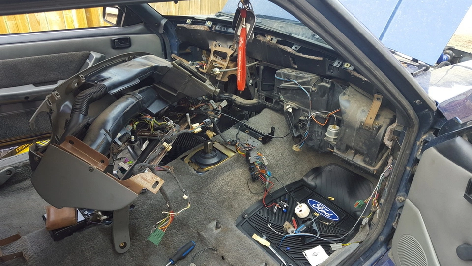

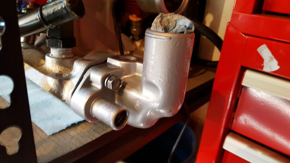

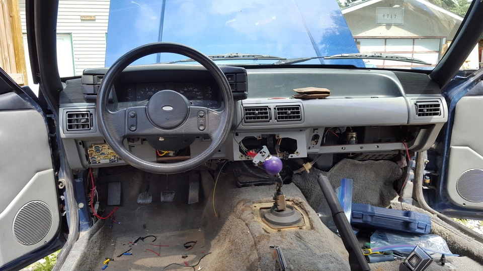

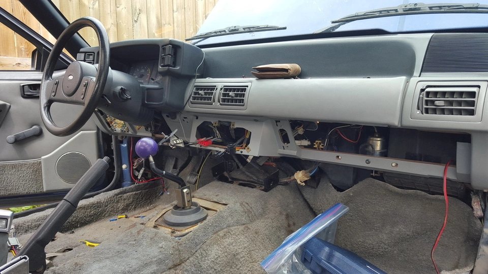

Now because of the sudden flow of coolant from the new hoses and the fact that Foxy had sat for so long, the dreaded heater core blew. I knew I could just bypass the Core completely, but I wanted to do this right. I stripped the interior (again) and swapped in a new heater core from The Mustang Shop. I also went ahead and installed the little yellow restrictor in the inlet hose to prevent (or even prolong) another blown heater core.

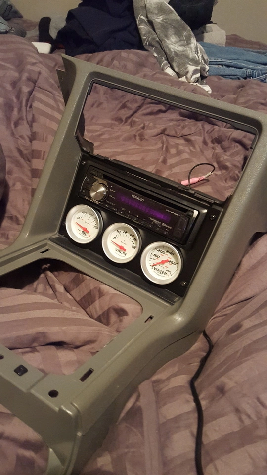

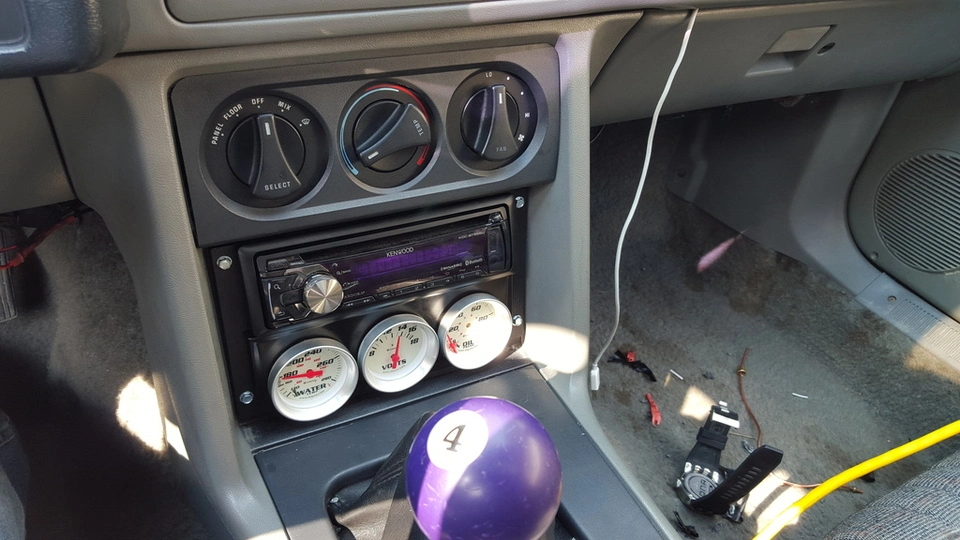

During this time I also mocked up some gauges underneath the stereo. I started with just cutting the face plate a bit and fitting the Equus triple gauge holder in place. I eventually went with a steel machined bezel to hold everything in place. (Also started with a mechanical Oil Pressure Gauge, but that didn't last long when it leaked inside the car and coated the carpet in steamy oil :eeek

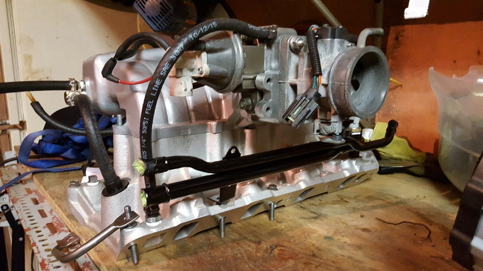

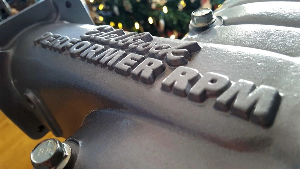

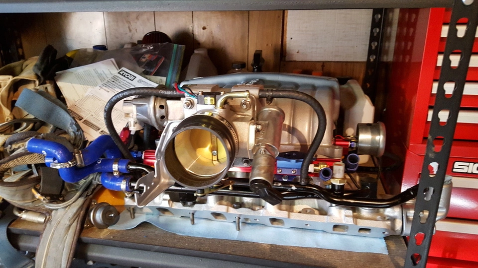

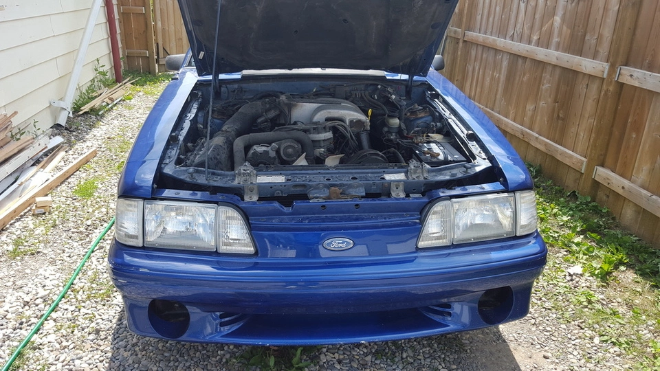

This plan wouldn't last long though.... While back home in Nova Scotia, I picked up an Edelbrock Upper and Lower RPM Performer 5.0 Intake and I couldn't wait to get it installed.

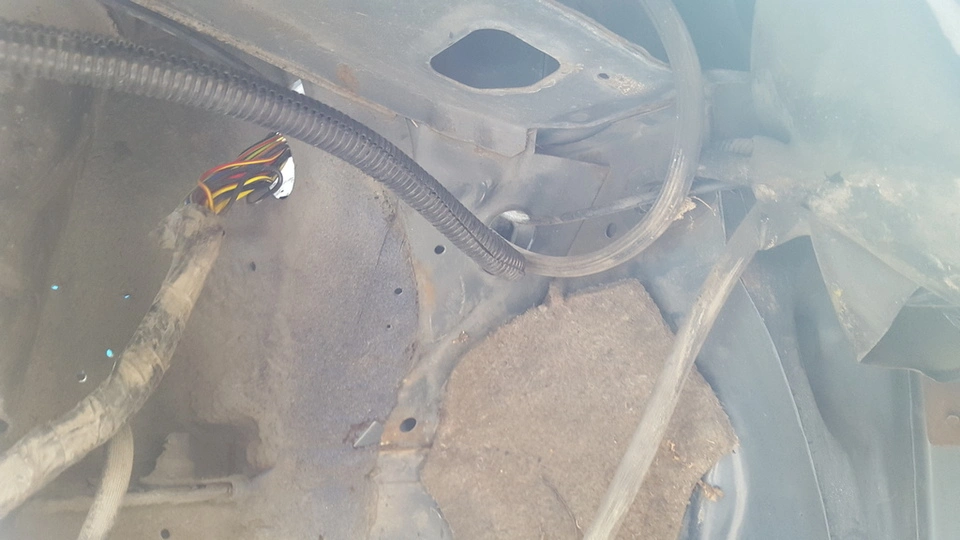

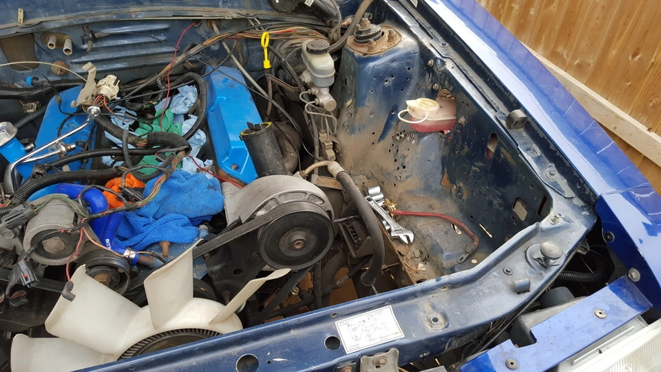

I knew at this point that most of the vacuum lines were rotted or brittle so I figured I'd go ahead and re-plumb everything and get her looking nice.

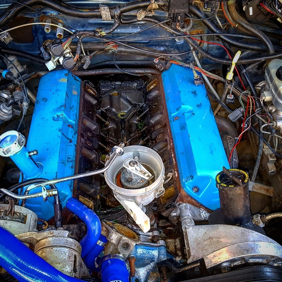

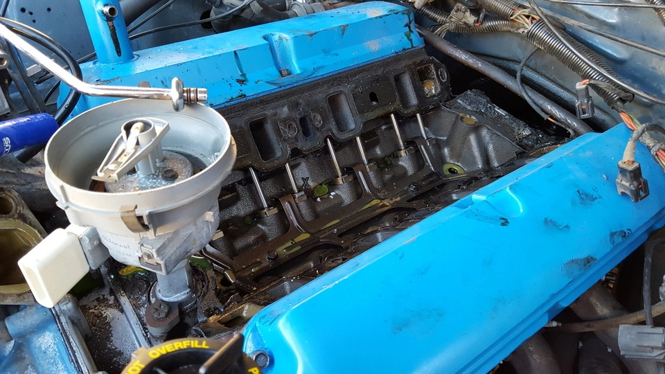

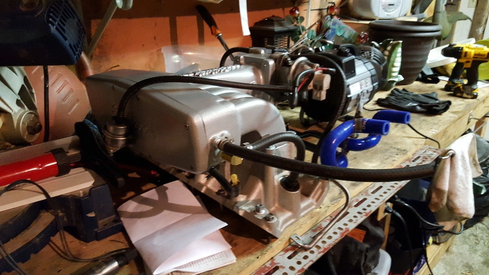

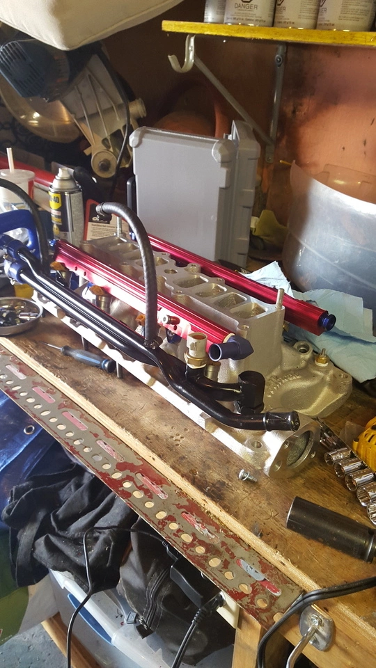

I started building up the Intake in my house when I realized that I'd have to start to take some things apart on the car in order to get an idea of where things went. So in the brisk cold air I suffered through many days of dismantling and installing parts between the two intakes.
At this moment I found out that the lower intake had a terrible leak towards the fire wall and I'm glad I found that out so I can fix it ASAP. The intake was going together great, and I ordered up a new BBK kit for the Throttle Body, EGR Spacer and TPS Sensor. Also ordered a Richporter Distributor and an MSD Rotor to go with my MSD Cap. Can't wait to get these things installed, since I'm currently out working up North.

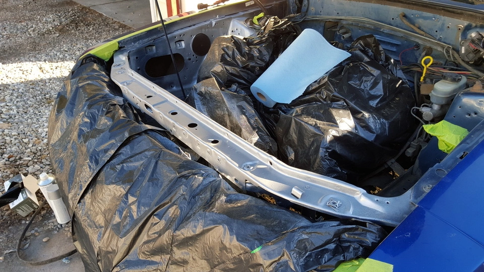

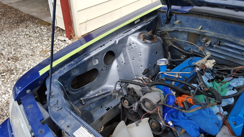

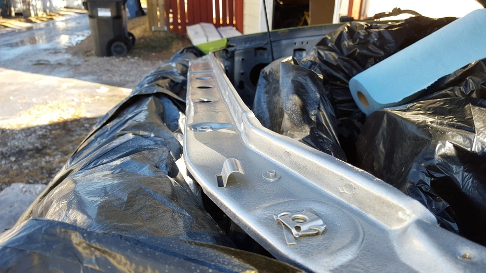

While I was working on the intake I also picked up a new-to-me Radiator with Complete Shroud and Coolant Overflow. Scuffed it up and gave it a blast of Semi-Gloss Black and also painted the Rad Supports.

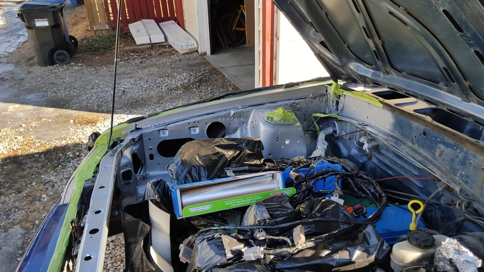

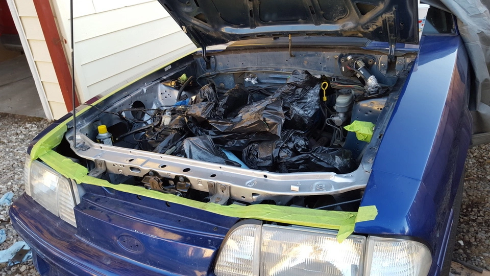

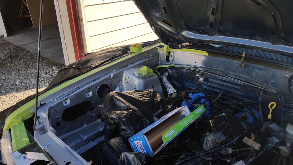

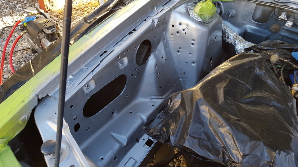

At this point and time I want to continue to clean up the Engine Bay. Starting with tucking of some wires, possibly painting it to match the body (Monaco Blue Pearl) and basically put everything back together. Gonna check out what the previous owner has done with the SMOG pipe that runs to the exhaust. If it's no longer there I'm removing the SMOG Equipment (Just the air pump, TAD and TAB and the hoses) to clean up the bay quite a bit. I'm also in the market for new tires. I'm going to be sanding and fixing the ROH ZS Wheels and would like to go with BFGoodrich G-Force Comp 2 A/S all around. (245-45r17 Front, 275-40r17 Rear).
