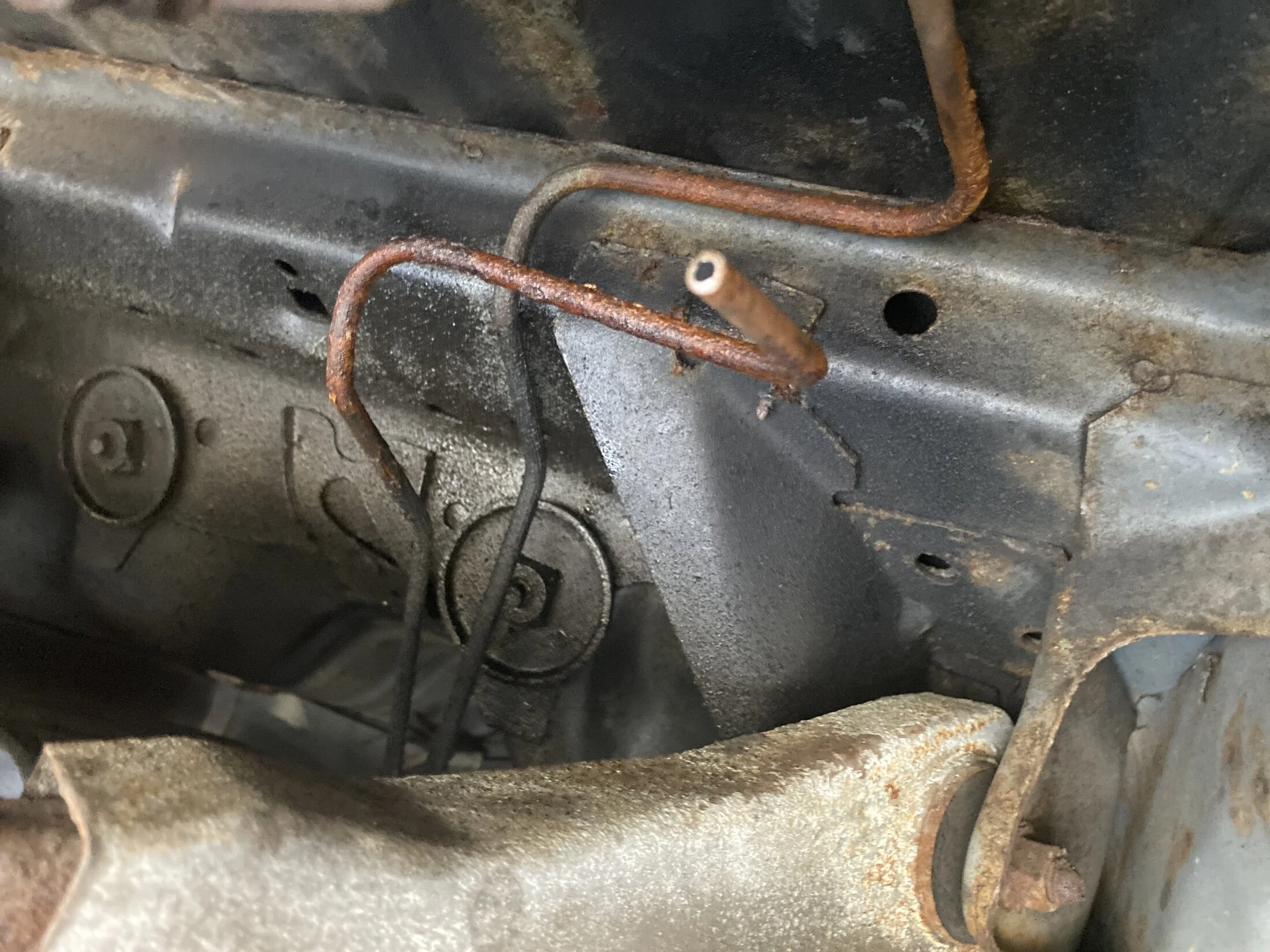

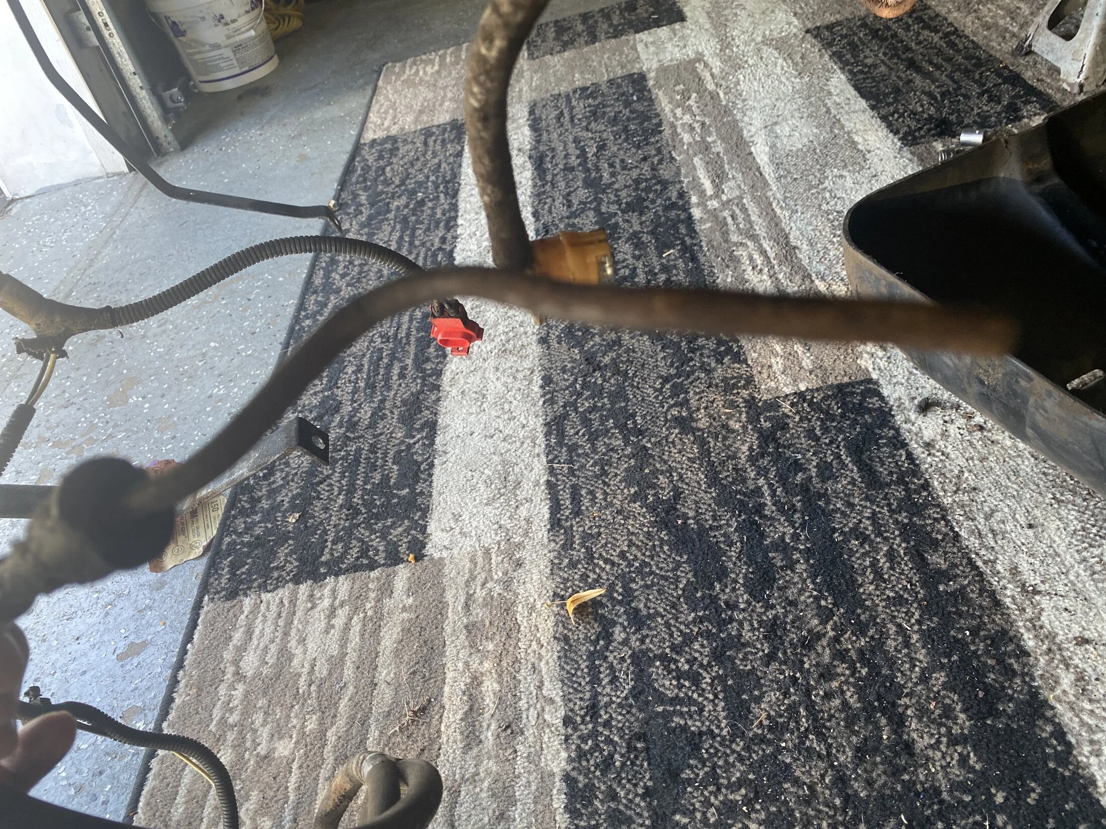

Hi guys, I had to replace my fuel pump and in the process I could not remove the line at the goes from tank to the hard line behind the tank . The fuel line tool would not disengage the line! I had to cut the hard line . My question is can I use a rubber hose to splice the hard lines together with clamps? Will it hold with the new pump? The car is a 86 LX carbuerated V6. Any help would be appreciated.
Thanks

You have a carbed v6 so it doesn't need high pressure . If you flare the ends of the lines ,use the fuel injection rubber fuel line should hold with fuel injection hose clamps.
This is my two cents worth of opinion, but worth a shot.
Reactions: Fcortes795
Just get a 5/16” (feed line) or 1/4” (return line) compression union from the parts store. Ran them on my Coupe for years when I swapped it to a V8. Had to cut the fuel lines in half to get them around the subframe connectors. Wasn’t willing to remove some of the drive train to not cut them.
This is if you cut the hard line where a union will work. If not then go with the injection type rubber hose and clamps.
I used a rubber fuel line hose and two clamps on a broken fuel line on my Supra and it held up with no issues.
However, I was a starving artist back then. Today, I would replace the line(s) because I can afford too.
