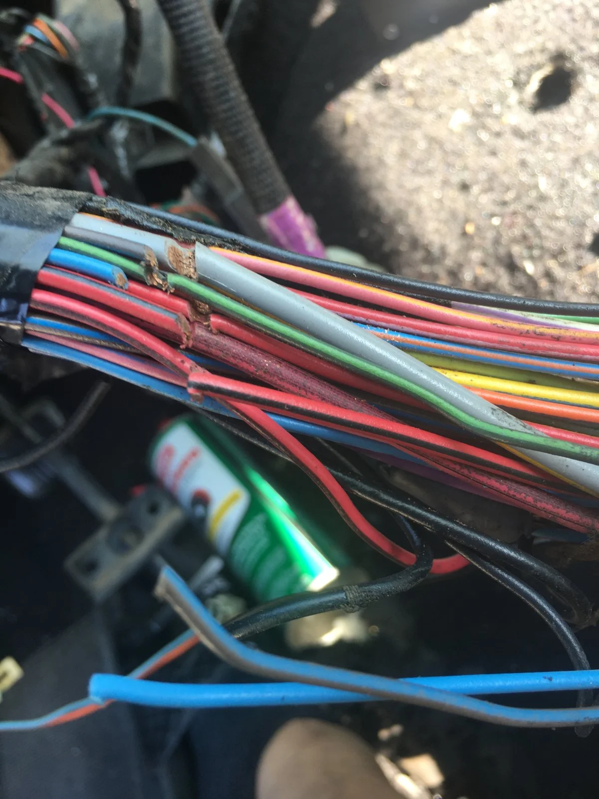

Can any one help ID these wires that I found cut on wire harness

Please post the wire colors with the solid color and stripe color along with the model year of your car. They help identify the circuit and its function. Do not depend on a photograph to do the job, since the camera and then the device the photo is viewed on can alter the color presentation. Clean the wires with some solvent before trying to identify them.
The wiring color codes are a clue to the wire function. A list of the colors is helpful along with the pin to color assignment. The connector shells always have a letter or number on the shell for each pin.
Example:
connector pin A= blue/white
connector pin B = red/green
Ford Factory wiring diagrams have a wire color to function table in the first few pages. The table is generic and is for all Ford products, not just Mustangs. For that reason, you need to think about what sort of options and equipment are in your car.
For example: If the table says wire color is for a power seat, you are looking at the wrong wire color/item type. Fox body Mustangs didn't come with power seats, so you know that isn't what you want.
Ford changed the color for some wires in 91, so that's why the year model is important.
Also show an extra picture of the mating face side of the connector so that we can see the connector shape and how many pins are in the connector. That helps identify the circuit function since most of the connector shapes are unique to the circuit they serve.
Sorry u guys are right that was sloppy
How about this connector on the driver side next to starter solenoid
I have a 86 mustang btw
And it was making a flickering noise when I had it on key on
You are in luck...The link below is for the 1986 EVTM which is the wiring and electrical troubleshooting manual for the 86 Mustang.
See http://slantnosefox.com/picturehosting/jeremy/86 electrical & vacuum troubleshooting manual.zip
You can download the whole set of electrical troubleshooting and diagrams for an 86 Mustang courtesy of Jeremy, AKA V8only.
It is a big 61 MB download that you get to unzip and save on your computer. It may take some time to download it, but the results are worth your time.
