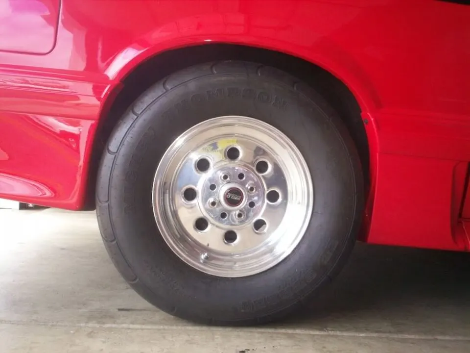

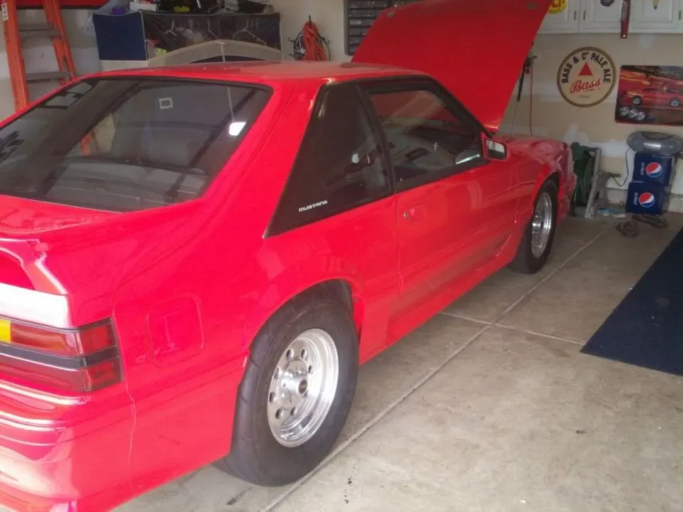

I installed 2" lowering Jamex Lowering springs on the rear of my car a few years ago. I never thought it sat right, and now that I put 28" tires on it the car has a rake look that I don't like! I want the rear to be about an 1" lower. How much should I cut out of the spring to achieve the height I want? Thanks!

When I put the 2" lowering springs in the rear of the car, it only dropped maybe 1 inch. Thats why I wanted to cut them just a bit more to get the rearend down a bit more. Here's a couple of pics of how the car is sitting with the 2" lowering springs in it. There is no way it dropped 2"
How can you tell with such a meaty tire on there?
If you cut your springs, you'll more than likely start whacking your tire into your fender well and possibly cut it.
Your car is a prime candidate for adjustable rear arms. You can adjust for larger wheels both up and down for when at the track and on the street.
For the amount of coin you have into your car, cutting springs is a hack way to achieve what you are looking for

The side wall of the tire you chose isn't helping either. even if you got it down another 1" going by the pics you are going to still have the rear up higher. going by the 1st pic you are real close to tire rub, look at the angle the rear sits at, to level her out you are going to have to stuff the tire up into the wheel well. coil overs or adjustable arms are going to help but you are still going to have issues, the only other cure for running a drag tire setup and stuffing meats under there and making it level would be tubs to stuff them up into the wells. good luck and hopefully you can work it out.
