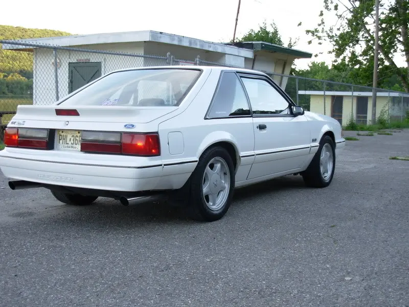

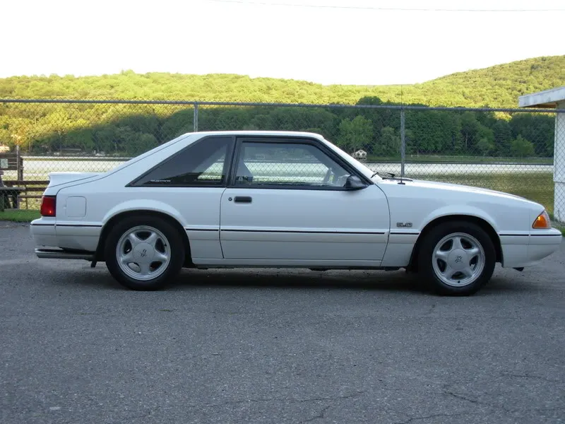

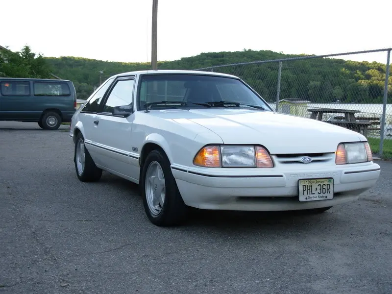

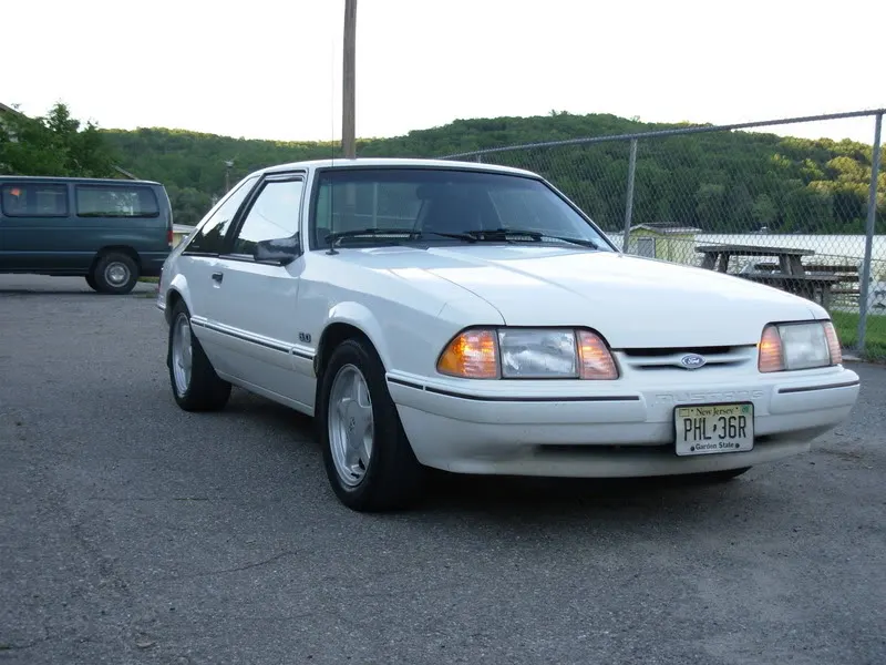

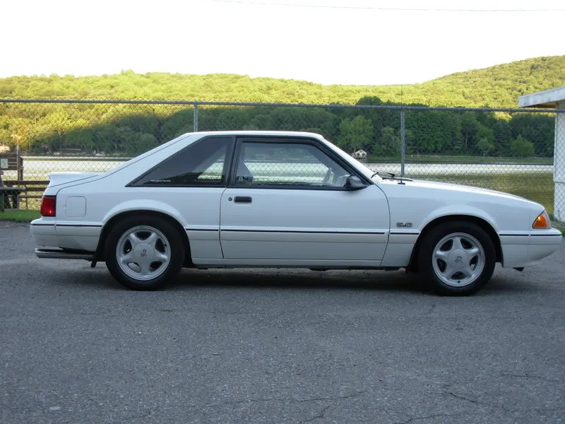

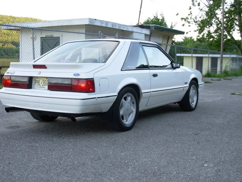

I've seen some pictures of moroso drag launch springs cut and if the eibachs are anything like them I'm going to cut one coil off. We'll see, I'd hate to ruin a set of springs by cutting too mucn off.
GTO: I have a set of C springs and a set of 6 cylinder Eibachs. No stockers tho. Also, can you post a pic of your car with the drag launches again?

i have the drag launch springs, i wanted to cut them but i didnt b/c i figured they were designed to work a certain way with weight transfer and such. so i left them, i dont think mine looks too high but idk. either way, best to decide now, i know i never want to take mine out... scary
