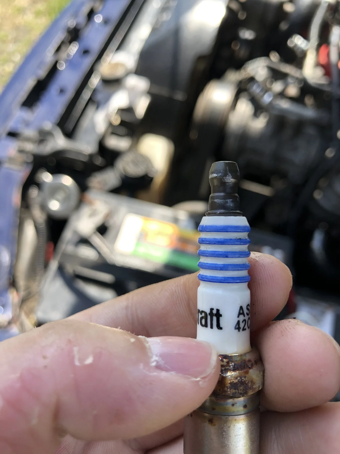

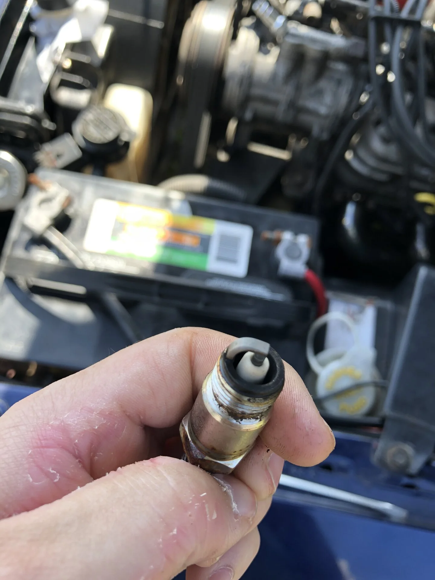

Pulled the #7 plug and this is what it looks like. It looks more white than it is but it’s more of a grey. Here’s the top of it
What do you guys think? They all pretty much look like this they’re all a lightish grey color
