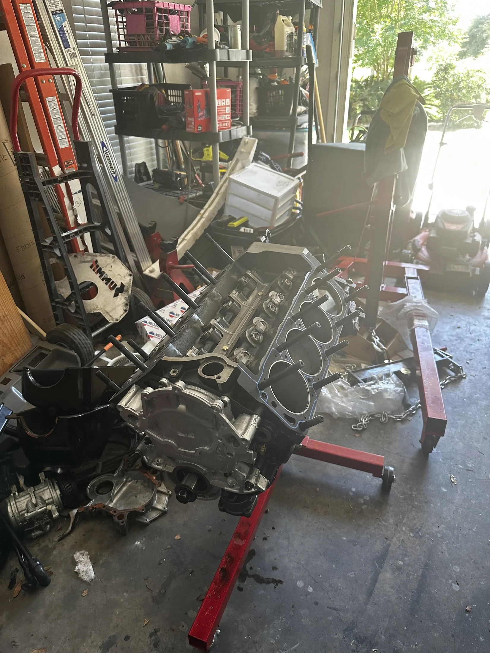

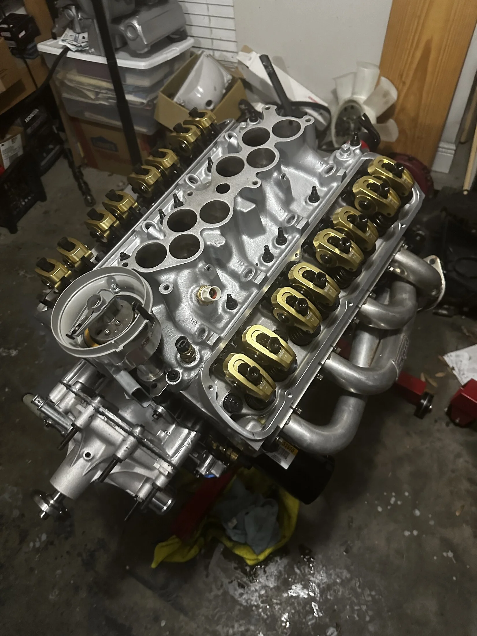

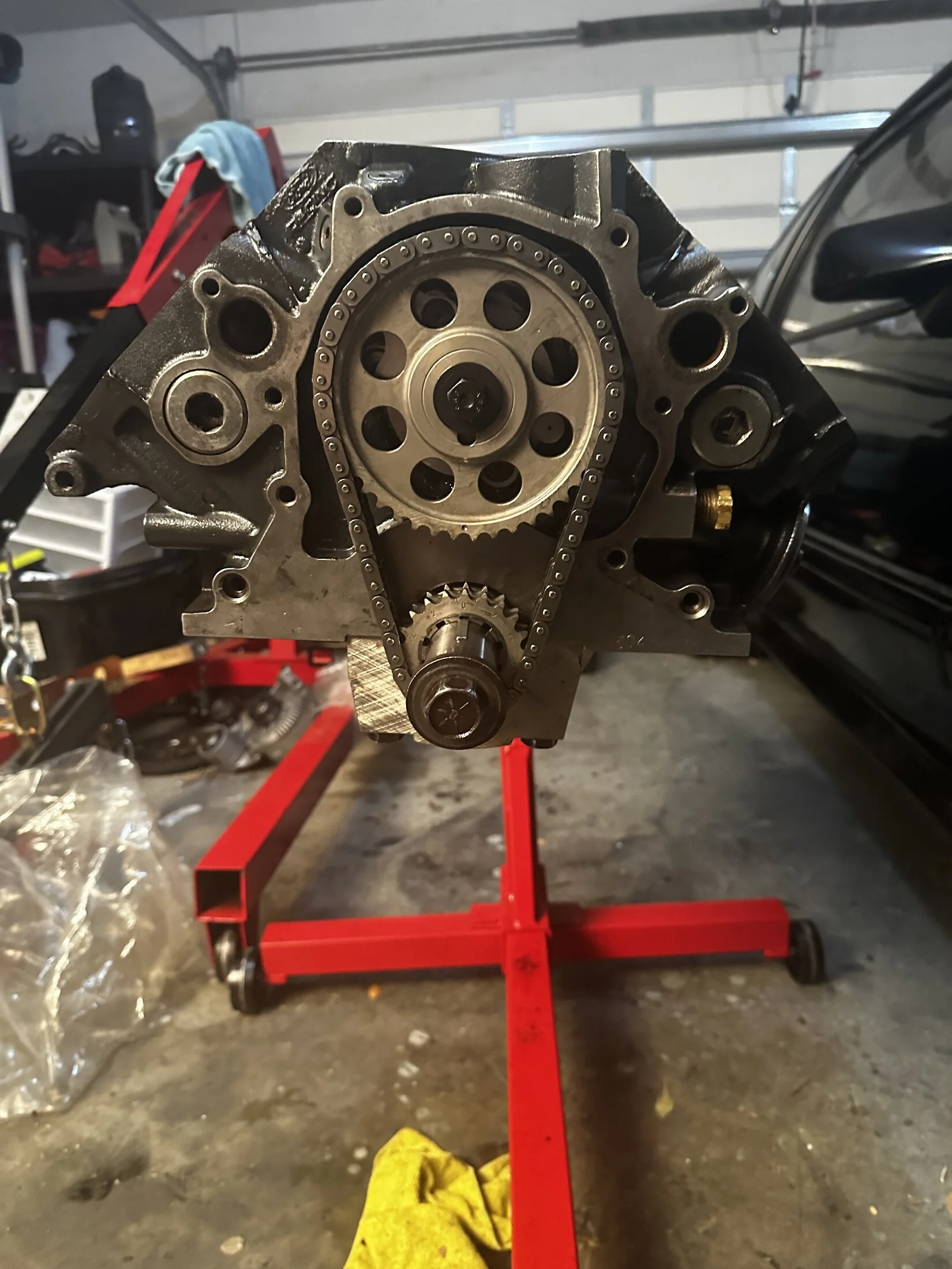

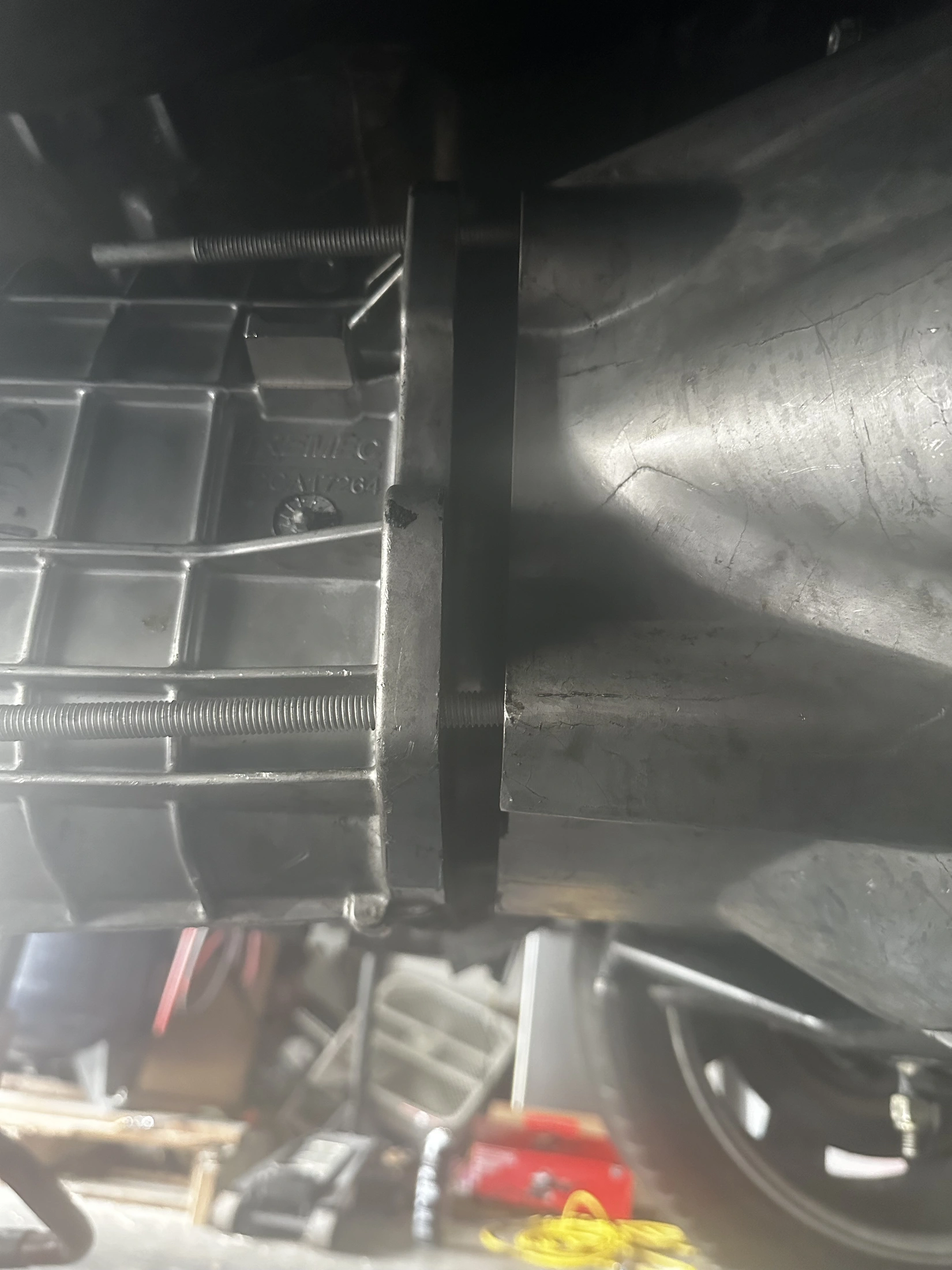

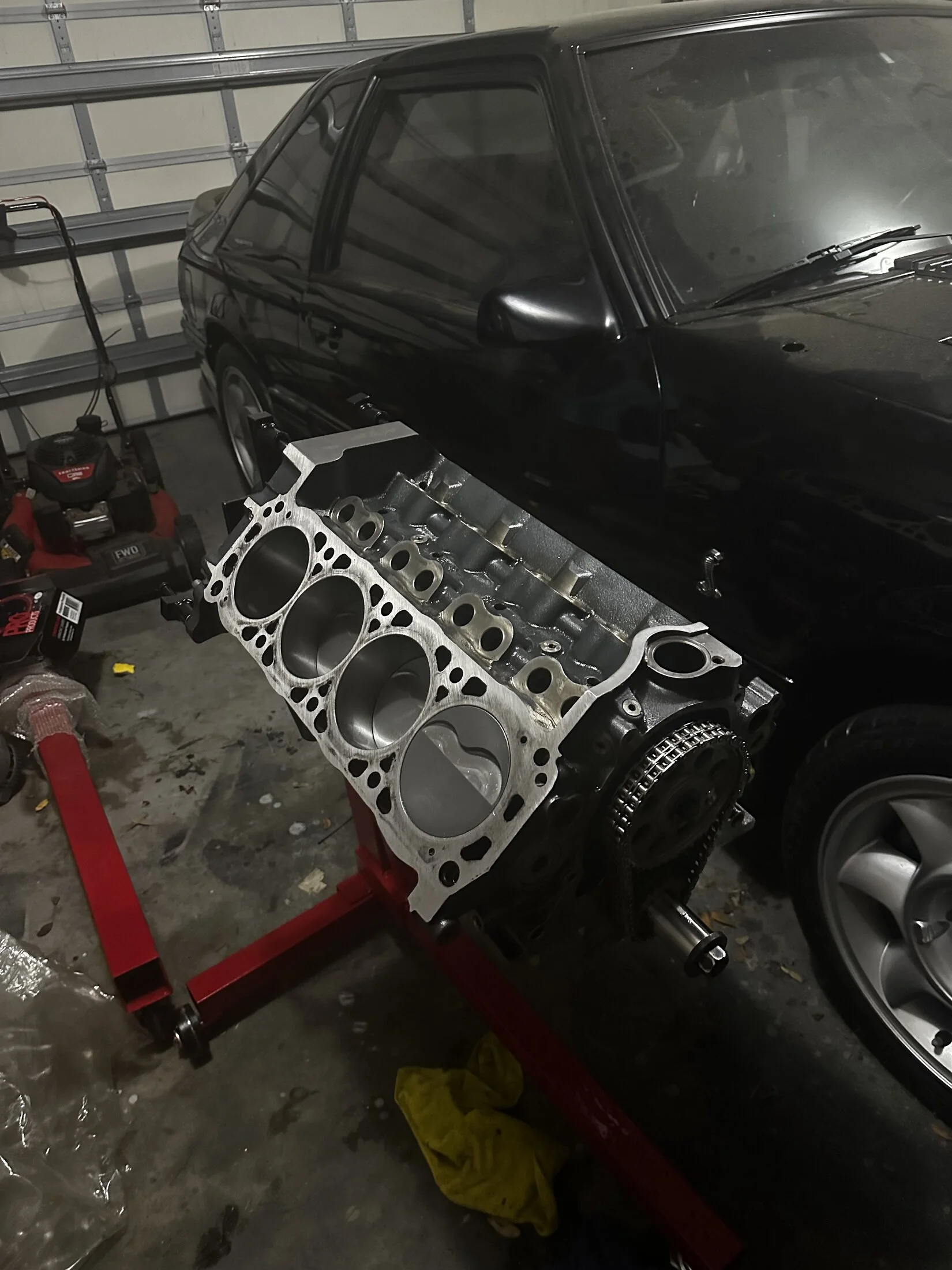

I bought this car without the original cobra parts like the engine, transmission, and computer. I will be adding more pictures soon.

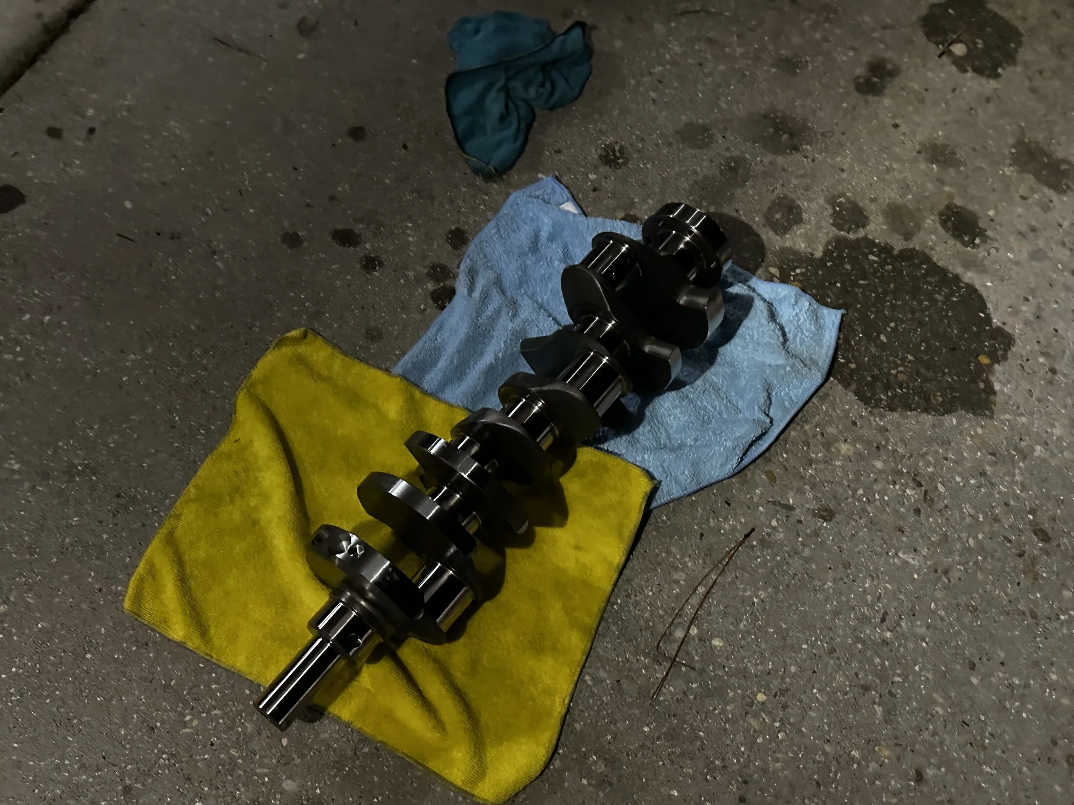

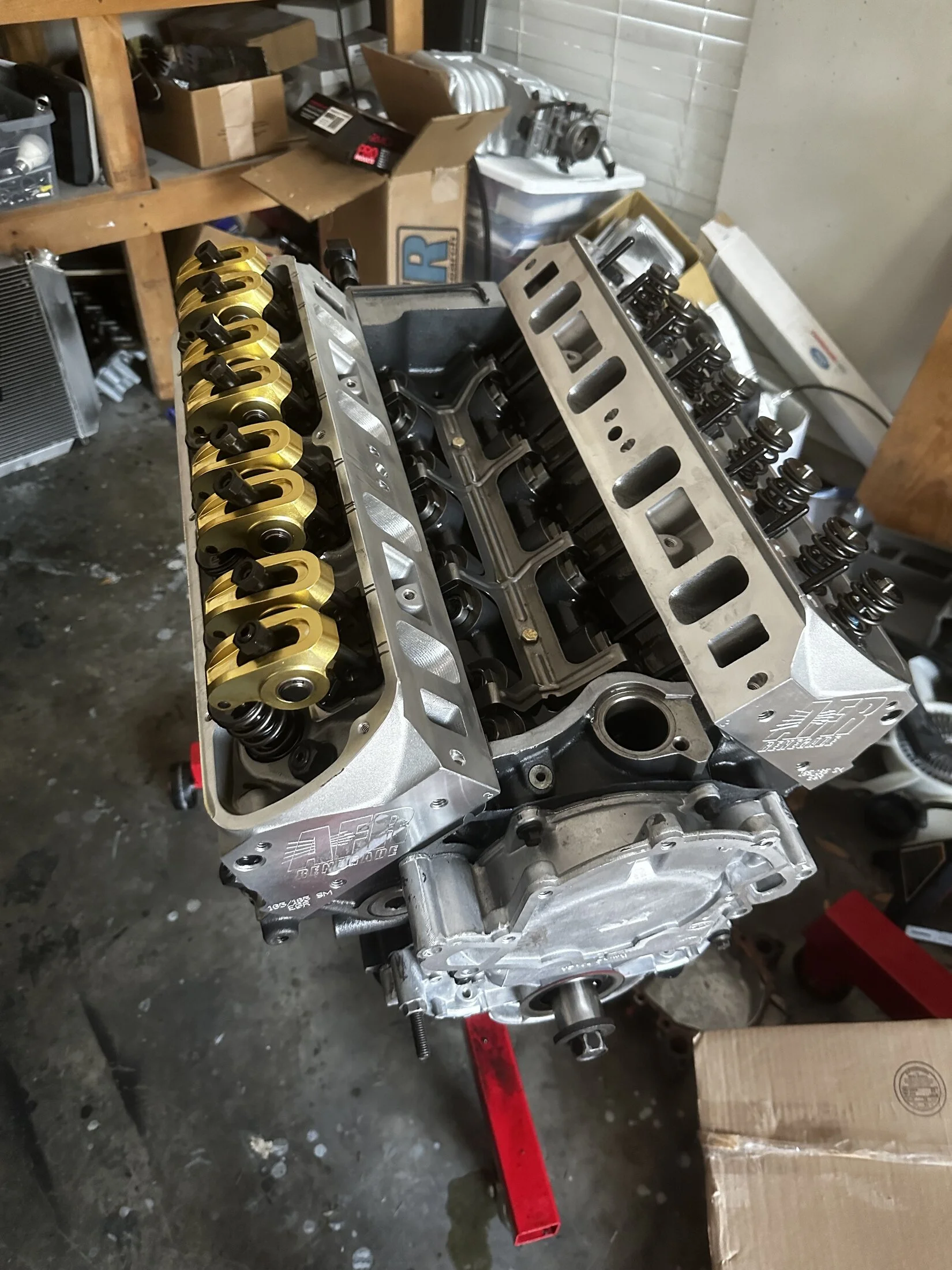

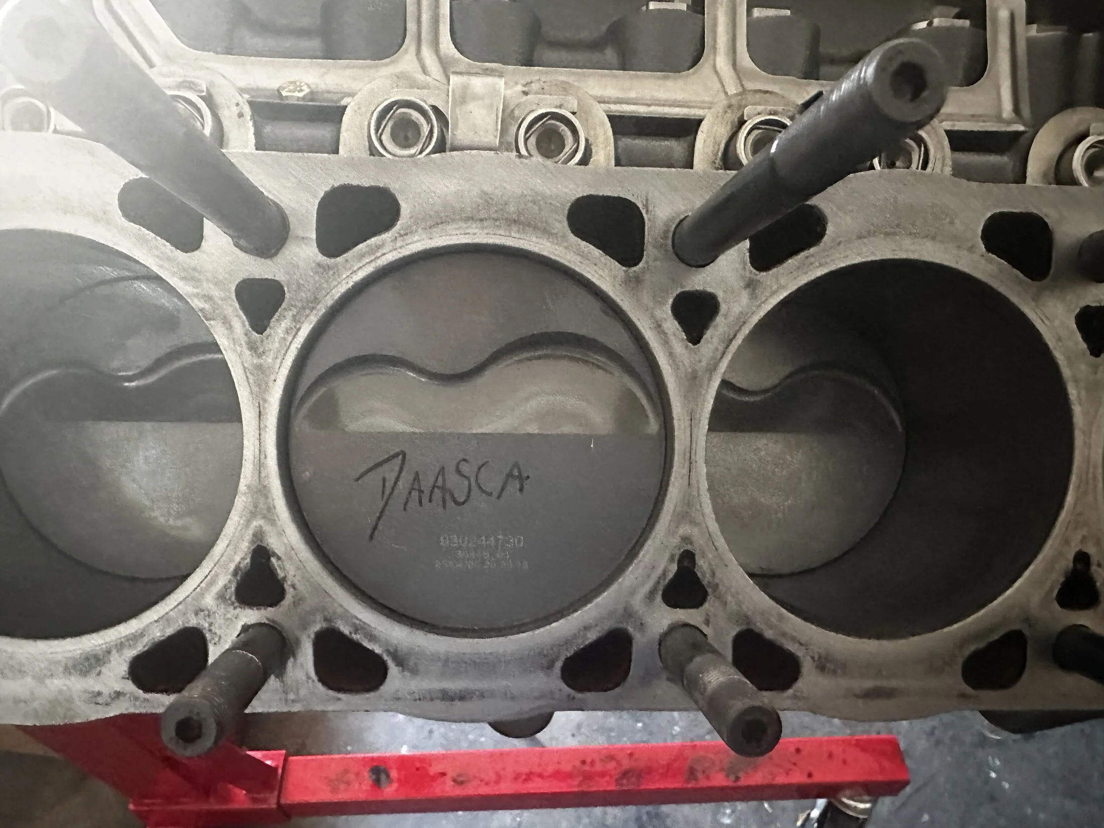

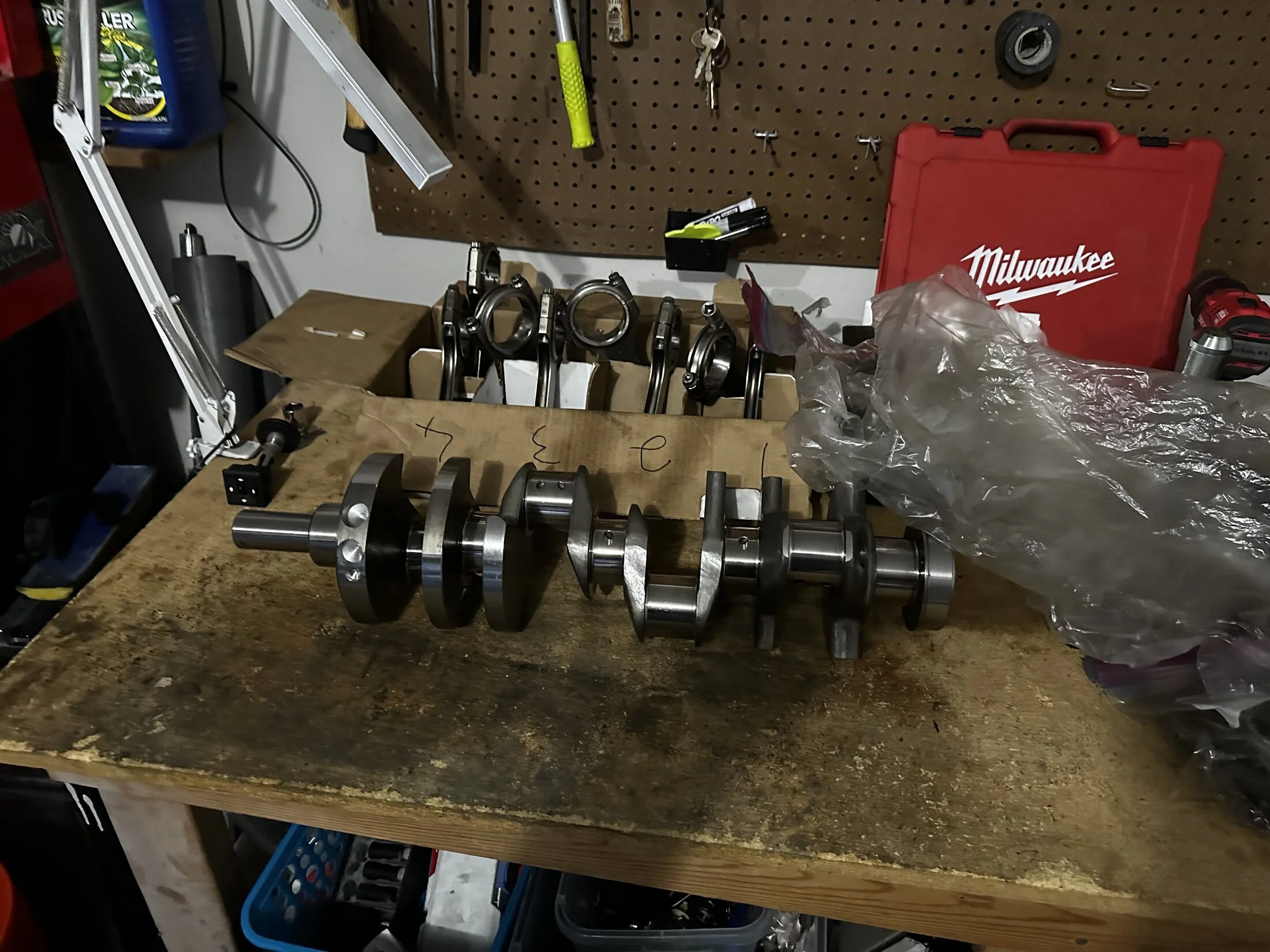

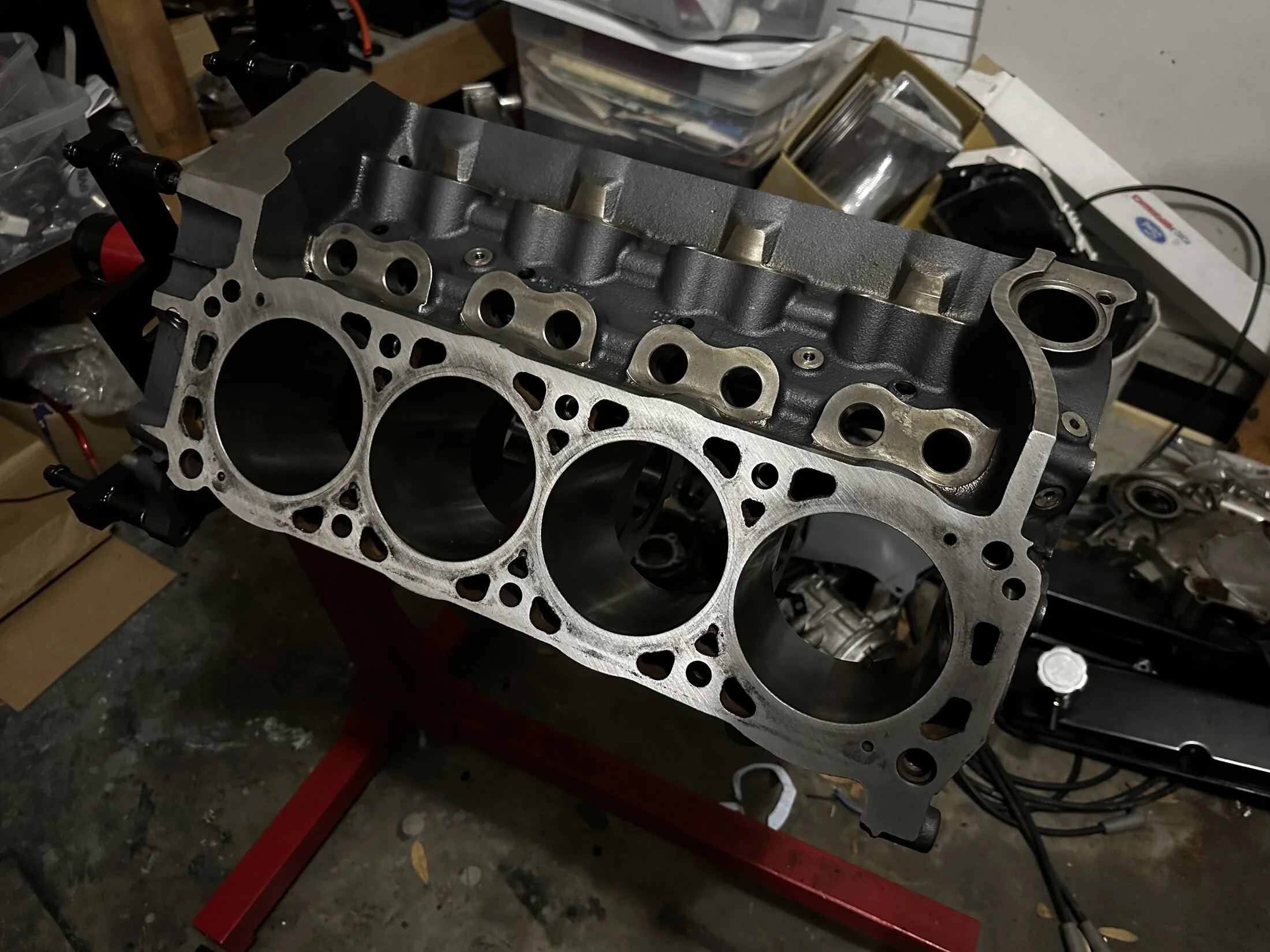

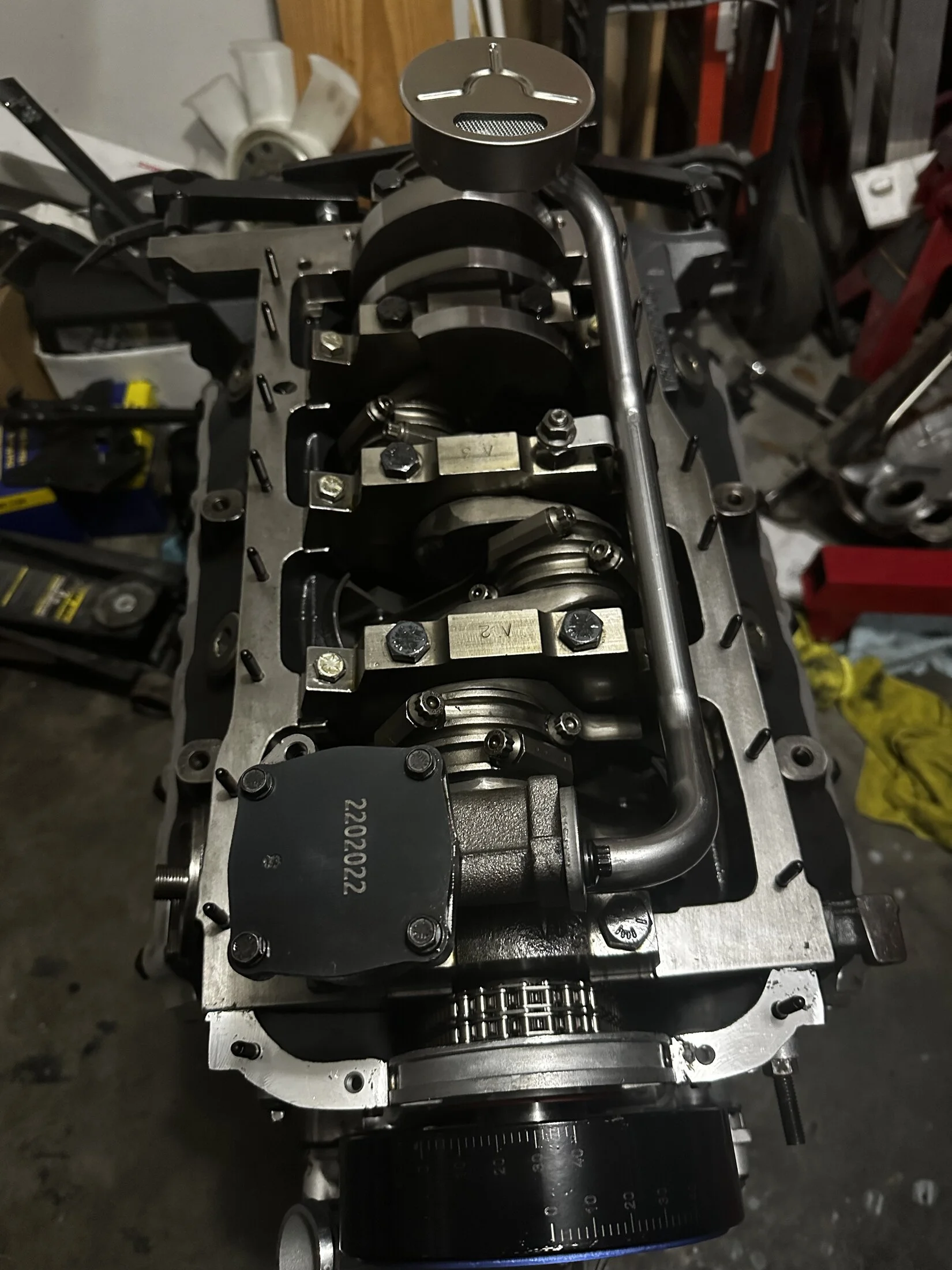

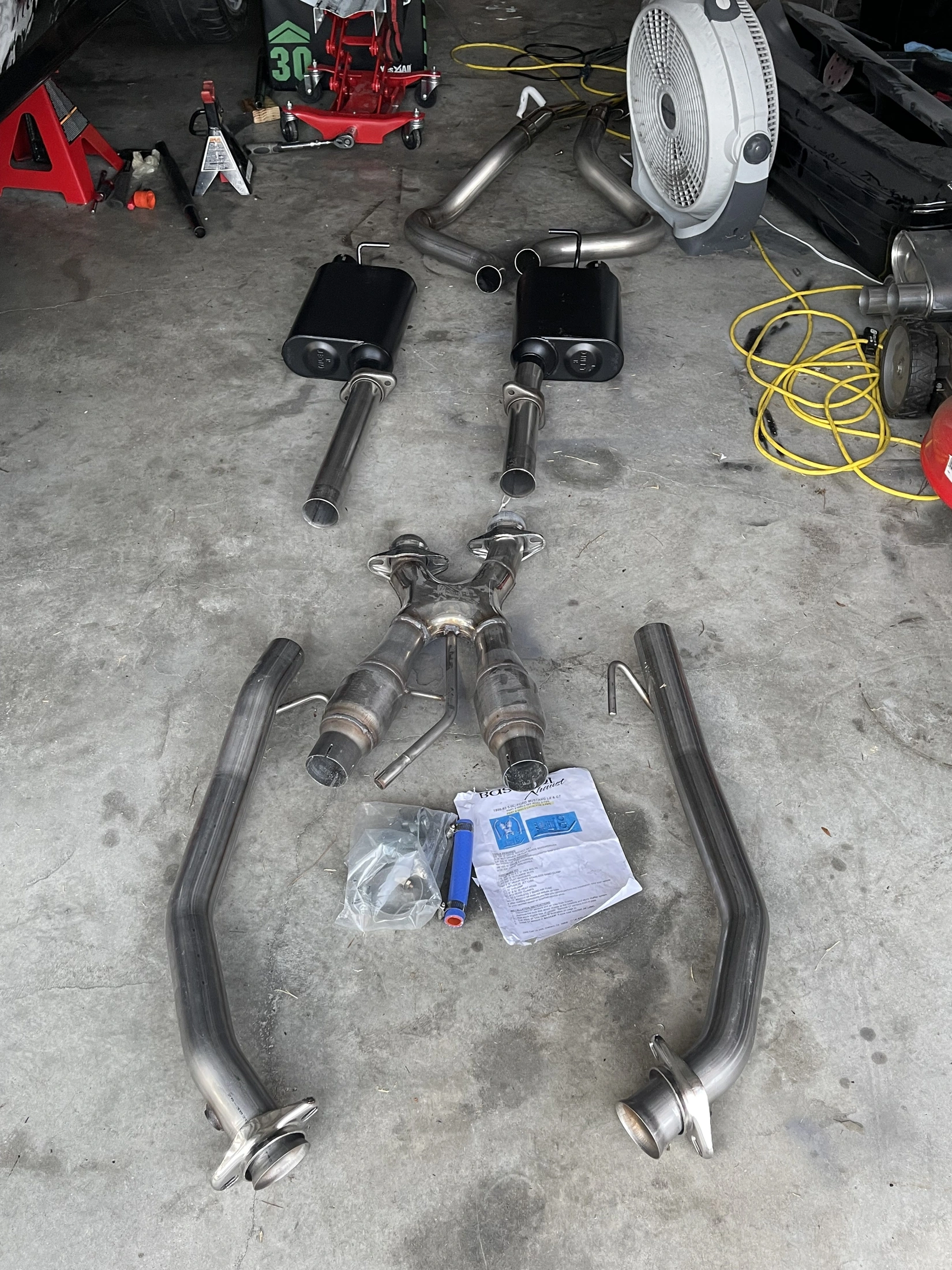

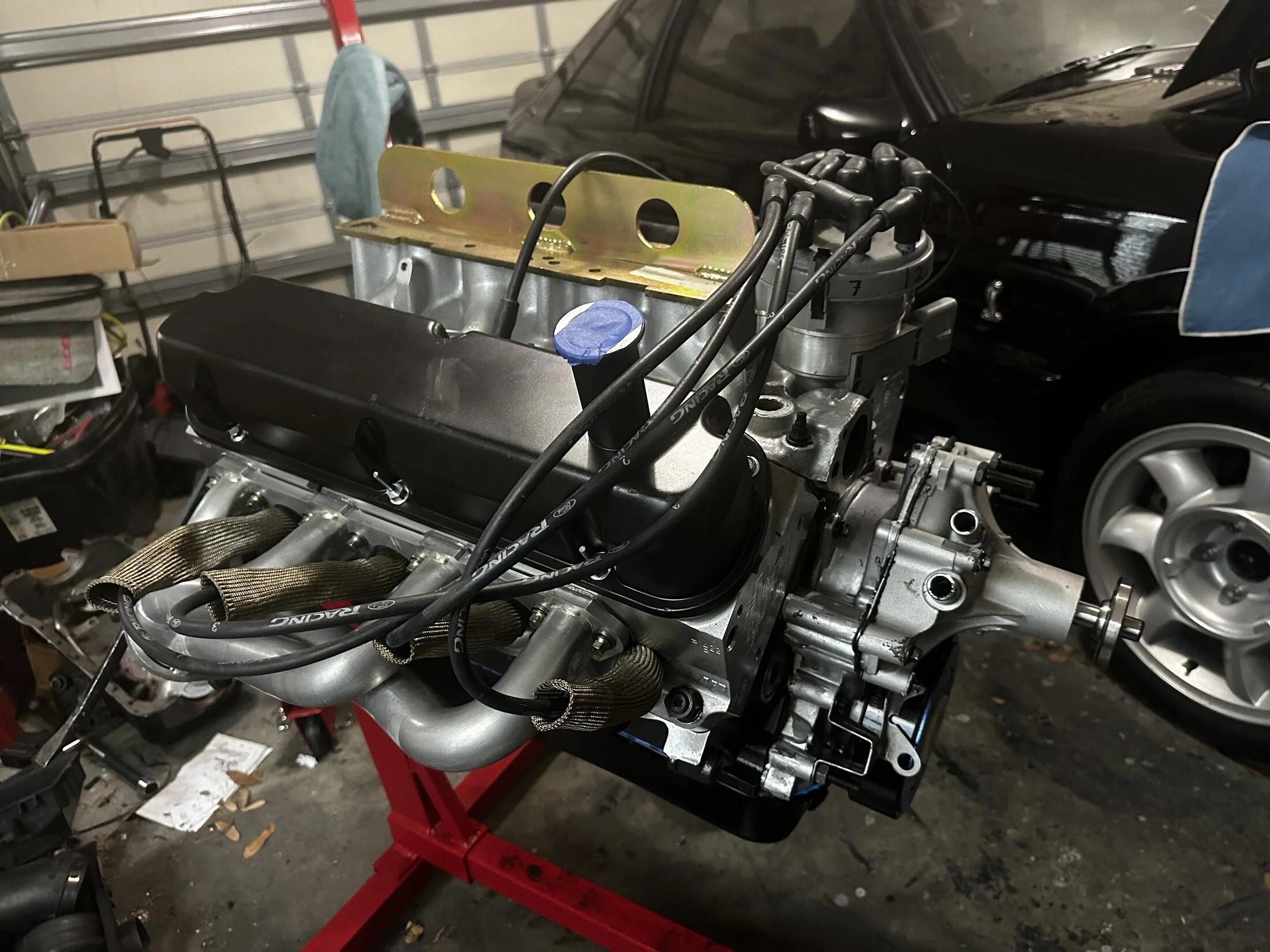

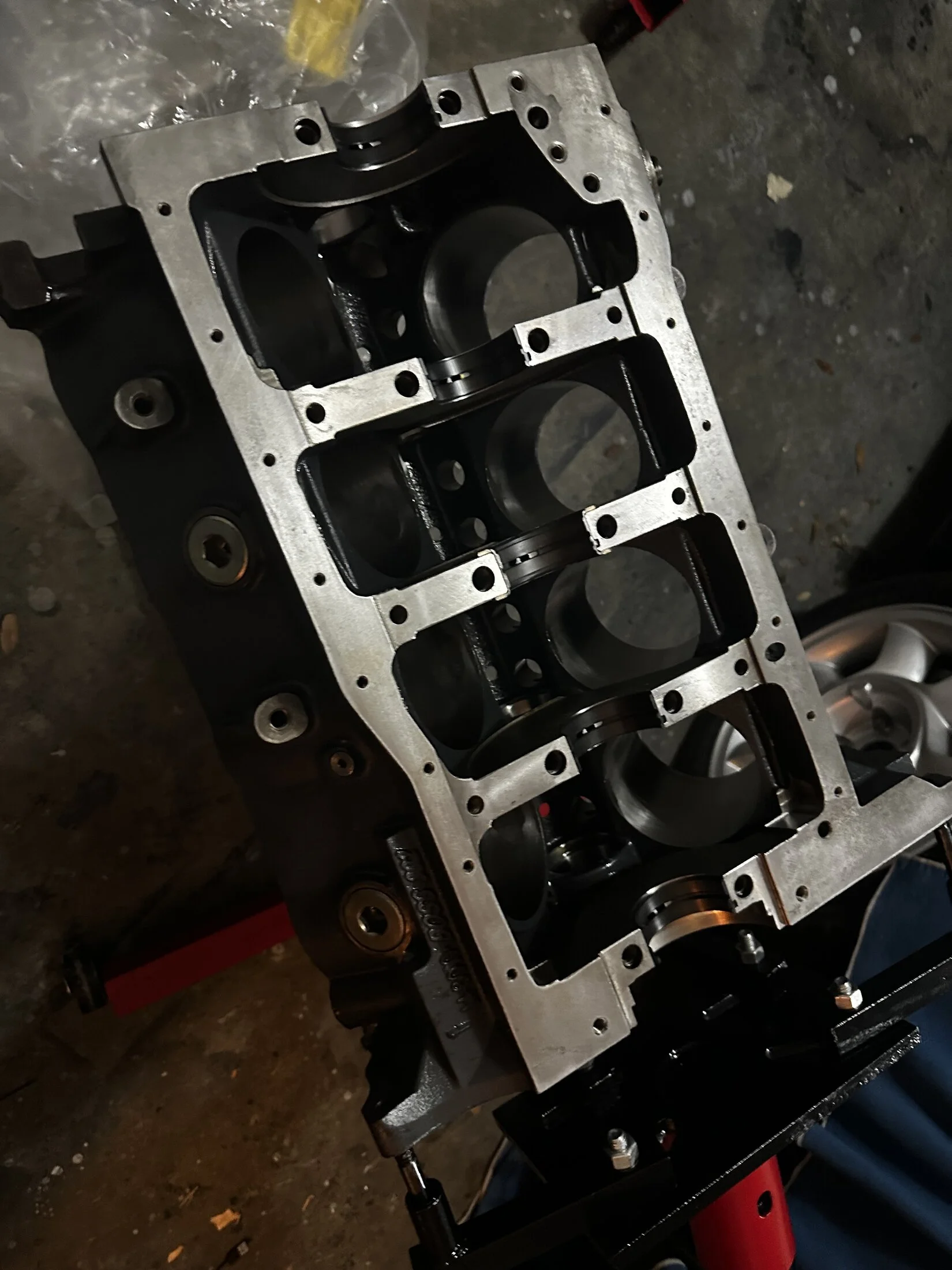

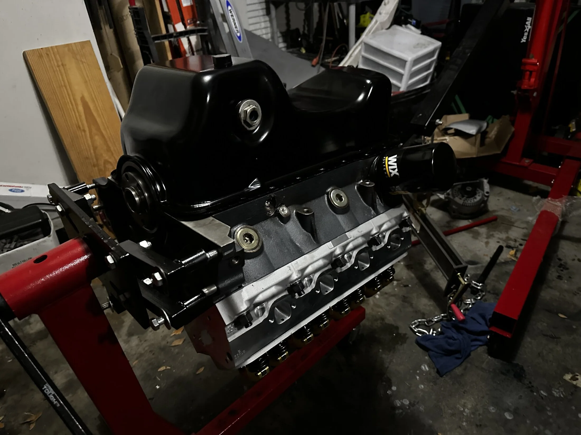

Thanks guys. My son and I did all of the build ourselves. Before the build the local machine shop did the honing on the block and balanced the rotating assembly. Some info about the car,
347 stroker
Boss 302 block
Bored 4.030”
Scat forged crankshaft
Eagle hbeam rods
Mahle forged pistons
B303 cam
1.6 comp cam gold rockers
Afr 185 renegade heads
ported stock cobra intake
Stock 65mm throttle body
Terminator x max ecu
Bbk shorty headers ceramic
Bassani xpipe with cats
Flow master American thunder cat back
TKX transmission
4.10 gears but have 3.31 going in
I uploaded a base tune recently. Just need to get the final tune.
