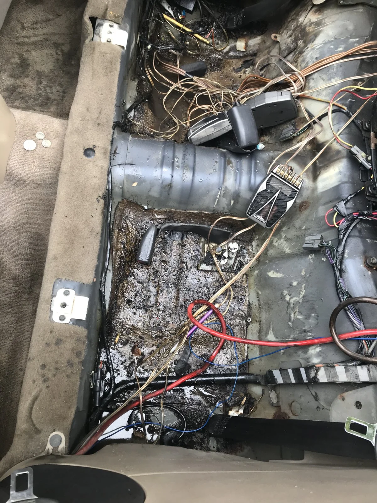

Today's focus was around the GEM, visually inspecting all the wires plugged into it, cleaning grounds. disconnecting the radio, amp and as many accessories as I could to see if I could in hopes to pinpoint the problem. Nothing gave me any clue so I started back at the beginning. Wanting to teach my daughter about the fuses I had her pull and reseat some and replace f2.39 for the GEM. This fixed a big chunk of our to do list, we now have:
Seatbelt Chime and dash light
Airbag Dash light
Door Chimes
Interior Lights
Door Locks
Wipers
Might be difficult to stretch this project a year!

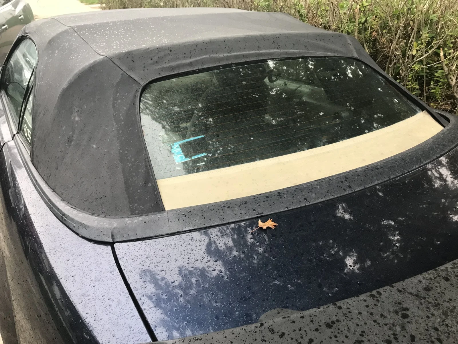

Here is a quick convertible top question: The cloth panel under the rear window is beige while the top is black. Was this just someone cutting corners when installing a new top? I can’t imagine it was oem design like the PO had told me.
Most likely original since they came with both color tops I believe.

Thanks, but would they use both colors on the same top? I have not been able to find an example.
No. Either the top was replaced with black or with the back window from a Tan top, definitely not original.
100% Yes on the colors, the top was replaced and they did not replace the rear glass. I just replaced my top about 2 years ago. I had the same option to replace it with a tan top like it was from the factory or to go black. I then seen the top and the rear are not the same unit, they are defiantly separate in case that back glass breaks. I had the full top placed by a local upholstery shop because mine was separating at the seams.
