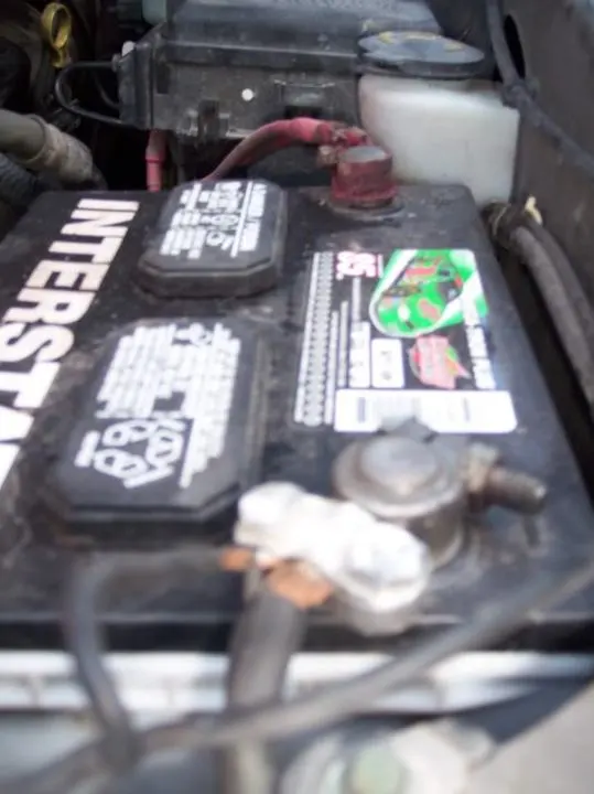

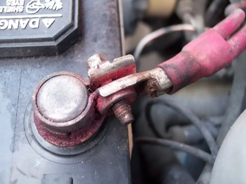

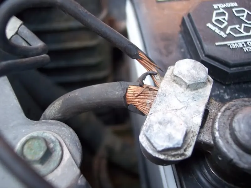

Here are pictures of the battery terminals:
Do they look like they could be the culprit? The negative terminal's rubber housing is beginning to go and the positive has this lovely looking sunburst red orange sediment forming around it.

Those splice-on battery connectors suck. I would unbolt the connection and clean and inspect the cable strands. Clean it all up and then try to find him some better terminals.

Ok, well i popped off the terminal connections and cleaned them out. The positive one was the only dirty of the two. I ran my eyes down each cable and they seem to all look to be in good shape other than the fray near the negative terminal.
All of the grounds seem firmly connected and are hardly harvesting any corrosion. My jumper cables just turned up missing, so it will be a couple hours before I can get some and try jumping the car.
