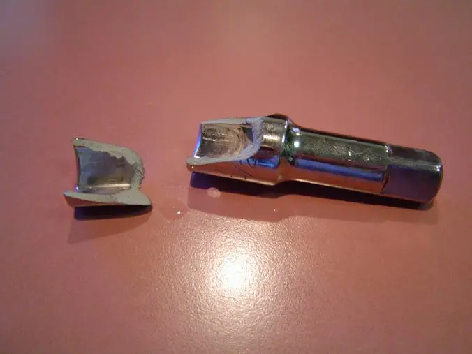

What's the best way to get the driver's side motor mount unbolted from the k-frame? We already broke a flex handle(3/8) and a 3in extension(1/2). Think a universal joint would be the next best thing? Thanks
yeah, we let some penetrating lube soak on there for a while. we used a breaker bar both times..it's on there so well that it twisted the drive part of the flex handle, and it completely broke the extension.
attachment.php
I think we'll throw some heat on it next time...
Craftsman..good thing about their warranty. I think I was going at it at a weird angle. I heard a crack, and I thought it was the bolt breaking loose, then I went at it again and it broke completely off. Got a new one though, so I'm happy.

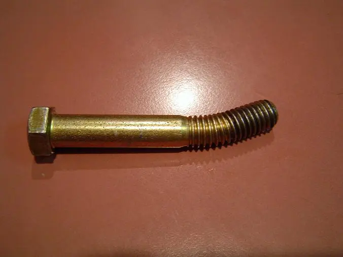

Funny you mentioned PB..little PB(I decided I'd bring some from home since it's good stuff) and a universal joint accompanied by a breaker bar did the trick. Yesterday when we were working on it, we noticed the driver's side motor mount was pretty bad. We figured if we kept jacking up the motor, it'd rip right out since the pass. side was out. We were wrong. Grade 8 doesn't mean a thing when there's that much pulling on it..
