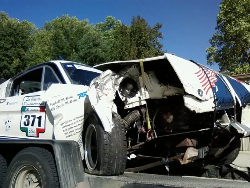

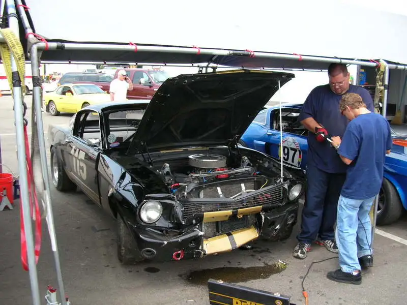

Eventually the 65 will be rebuilt. I just need to get some funding stashed away to do it correctly. If the cars in your pics can be saved, then mine certainly can. I just need to find a shop to do it right and not rob me at the same time.
