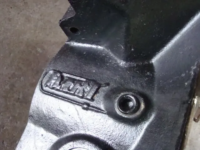

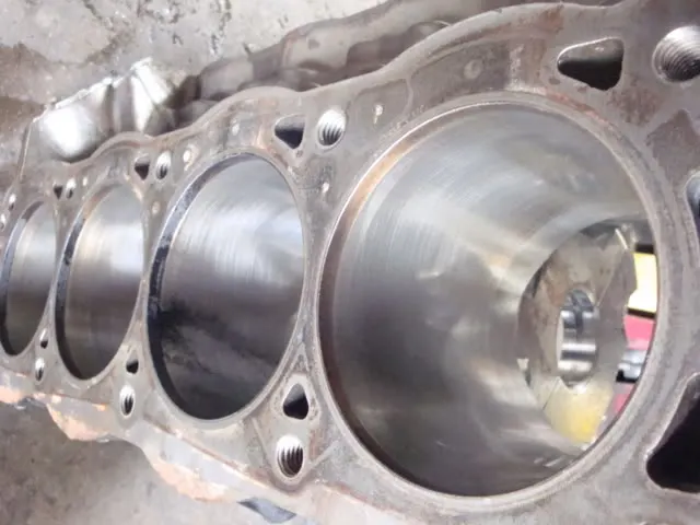

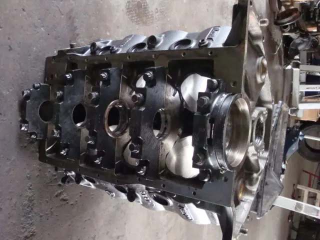

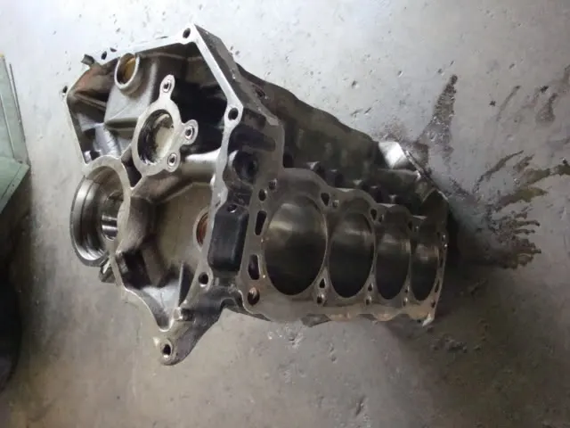

he says it has a 1000 miles and it looks to be so too, bore is 4.030 and deck hight is 8.2 and the block just went through a fresh machine, any chance the block is stolen and if so are there numbers to verify so, i was only saying that because i didnt know they deck height, now that i do and that its had a fresh machine to 4.030 then i'll keep my stroker kit cause that will also save me machine costs as well
i know its kinda old now but i did pick up the block and its beautiful

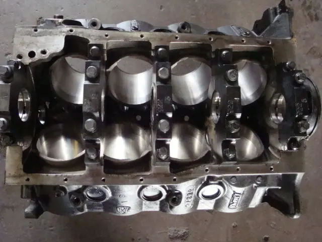

Does it look like this?
:nice:
So call me a pic whore :shrug:
Dirty!?!? Why I oughtta :ban: :D
Nice find. If I found a deal like that on an Iron Eagle, I'd ****** it up. You probably saved yourself about $1600-2000 between the new cost of the block and machining. :nice:
