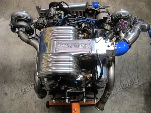

Wonder how much this weighs when it's all said and done:
Now I know full well that a TT 5.0 setup will make a ton of power more than an N/A heavy old 460 will
But that still don't change the fact that you now have 700 pounds in front of the firewall.
All depends on what you're trying to accomplish.
A BBF swap is just as easy now days as any other engine. It fits a Fox better than any Ford engine bay that had the engine in it stock.
If you're looking for fast street car for cheap, that's also different because nobody will do this, (cause they all have a problem putting 700 pounds of cast iron in front of the firewall) But,..don't think twice about putting twin turbos on a SBF.
