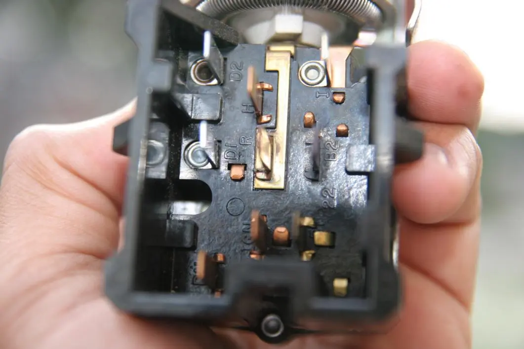

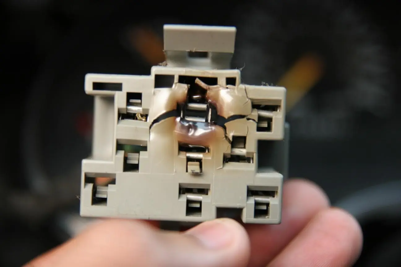

Okay guys, here is what I found. The switch and harness are both damaged.
Terminal B22 on the switch is burned pretty bad. See attachments. Thanks a million for all the help. 225,000 miles and still riding strong!!!

when I replaced the connector i was able to push out the wires and reinstall them back into the new connector.(no splicing) Only do 1 wire at a time.

I purchased a new connector (harness) from Ford and the switch from Napa Auto Parts. I followed the suggestion of Desertcox05 and pushed out the wires one at a time on the damaged connector and installed them into the new connector. Everything works fine. Thanks Again!!!
