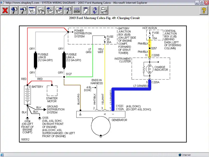

There is one wire from your alternator that feeds that warning light. Check fuse #5 (15A). Pull it out and really check it. That may be the cause.
