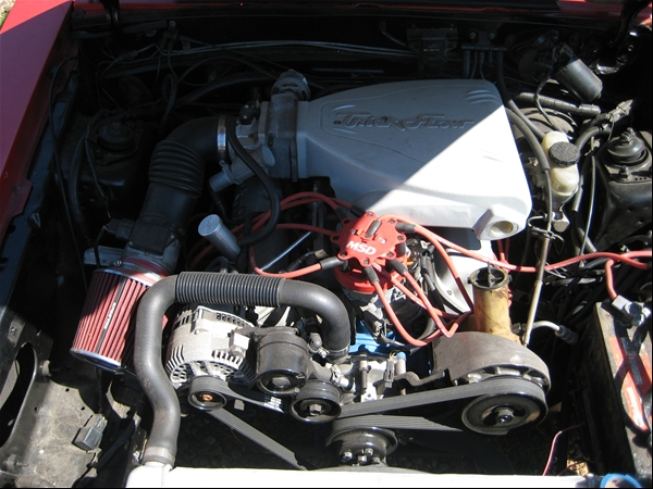

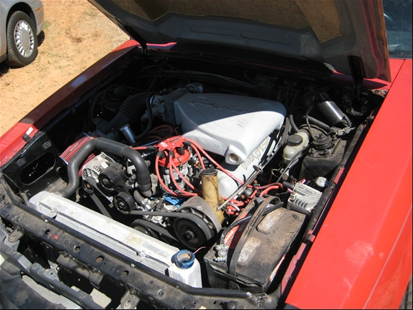

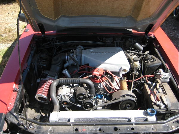

I have the opportunity to pick up a 89 convertible with the following mods for what seams like pretty cheap. The motor has not been broken in yet. It has brand to TFS heads/cam/intake. Inside is forged flat top pistons/rods.
The following are all brand new: Throttle body, alternator, PS pump, smaller pulleys, belt, aluminum radiator, clutch, flywheel and clutch cable. The wiring harness has been re-built to look brand new. The shocks/strut's appear mostly stock and it comes with an extra rear-end that has 3.73's and lakewoods (the spider gears are broke however). The current rear-end is unknown.

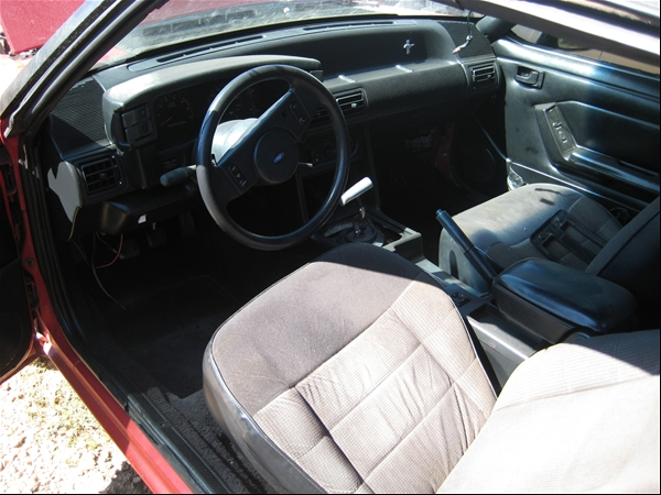

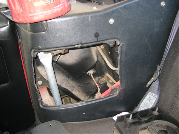

The interior appears to be in good condition (original black), but it is missing some trim pieces (a-pillar, shifter plate, kick plate and a few other pieces.

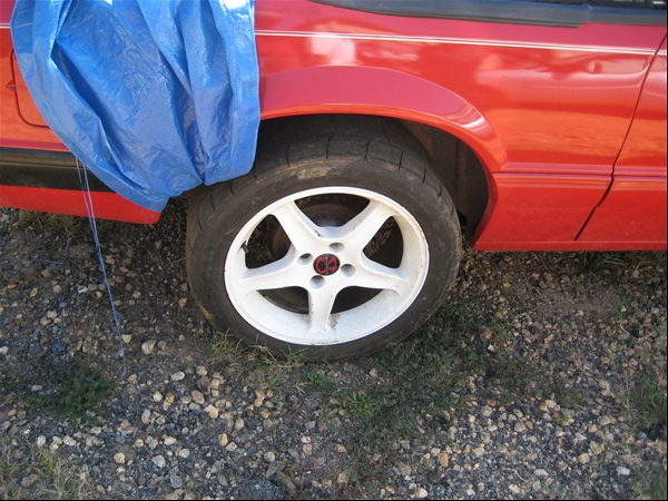

The bad is, it's a vert that needs a new top...all new seals/rubber. There are some dents on the passenger door/fender on the hinge side. It has a 3 inch cowl hood that has a chip on the cowl near the windshield. It also needs a complete paint job, but the rest of the body is mostly straight (and completely rust free). The exhaust stops at the headers, so it would need a H or X pipe and some muffs.
Is it worth it? The price is $2000

Personally I see a whole lot of money being spent to get the car back to a decent shape. I don't need to tell you this but it has clearly been wrecked (duh). There is possible frame damage since it was hit so hard it broke the door hinges. You may want to lift the back of the car up and see what the battle boxes look like. Chances are that they're damaged since this car has clearly been abused. It has what looks like non matching SN95 seats in it. In non matching I mean they don't match the rest of the interior. The rest of the interior looks rough. Is the radio gone? Does the seller have the receipts for any of the engine work?
I wouldn't even buy this car. It's more work than I'd want to do. I'm guessing around $1,000 to $1,500 max. If I were to buy the car it would only be to part it out.

The interior really isn't that bad (mostly dirty with some missing pieces). I figured that a collision occurred at some point, as I don't know how those door dent's could have happened otherwise. The body is relatively straight still however. The question is...is it worth cleaning up, or would I be better off selling everything off except perhaps the drive-train?

I have fixed two cars before with similar damage. Both were caused by the car backing up with the door open catching on something and crumpling the door fender edge and breaking the hinges. Just something to think about.

1989s never came with black interior. Its either been swapped in, or it's painted. Plus those are 4-banger cloth seats in it.
Looks like it's just a bunch of good motor parts in a car that isn't that clean really. I'd prob do $1500 tops on it with the intent of taking what I wanted and parting out the rest.

Mustang5L5, I didn't know black wasn't an option in 89...good to know. He claimed the interior original black, but based on whoever he bought it from.

I based my damage assessment on the fact that the front has been replaced. You can see the primer black on the headlight "covers" (for lack of a better name) and the primer black bumper.

I'd pass, that car is going to take a lot of money to get back into shape.
Unless you know the engine builder personally (and by engine builder i don't mean the seller if he's the one that did it) the engine could great or could be a pile of junk. So many times cars come into my buddies shop for "minor work" or "tuning" with new engines and they turn out to be homebuilt piles of crap.
If you are only interested in the car for yourself not parting out, it's worth nothing to you.
Paint jobs and body work are very expensive, that interior is going to nickel and dime you to death.
Stay away.
I'd say you would be hard pressed to have it look and run good for less than 6-7k

The front bumper has most certainly been replaced (it is indeed black). Also, the drivers seat is not bolted down...it is not bent.

Millhouse, if you're buying to build, I think you can find better. I'd be concerned that the engine "hasn't been broken in." Unless it's running and driving without issue, there's no way to know what you're really getting.
However, I'm sure it's worth well more than $2k for the parts:
Conservative sale estimates:
Interior = $500
Heads = $800
Intake = $400
Shortblock = $300
That's $2k right there and you still have plenty of stuff left to sell off (rear, tranny, accessories, wheels, tires, suspension, body parts). That's probably another $1k or so altogether for a quick 50% profit on your investment. That's better than stocks, albeit more work.
To build up? No, there are better cars out there.
