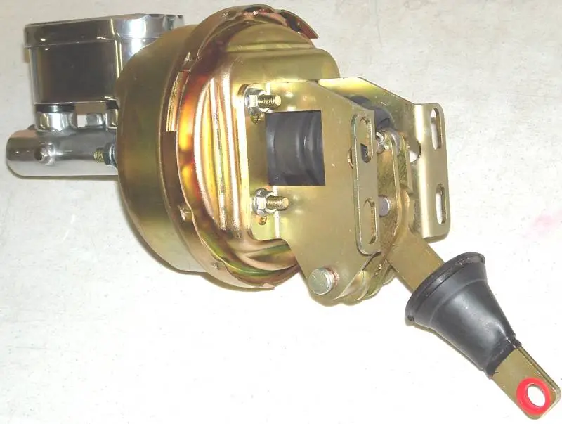

If you have no power brake booster, the clutch MC will fit. If you have a '69-up and power brakes, the clutch MC will fit. If you have a '65-'66 and power brakes, you will have to use a bell-crank style booster, that lifts the booster/MC out of the way of the clutch MC. This style will also work with the '67-'68. The only fitment I'm unsure about is the '67-'68 with a non-bell-crank booster. You can always try it and either jettison the power brakes if it doesn't fit or buy the bell-crank booster.
Here's a pic of what I mean by "bell-crank booster":
This model is made by Scott Drake for the '65-'66 and goes for $410 at Mustang Depot Las Vegas. Notice the MC ports are on the engine side, so you'll have to bend new lines.
I believe Master Power Brakes also makes a bell-crank booster, and NPD seems to have a model too.
