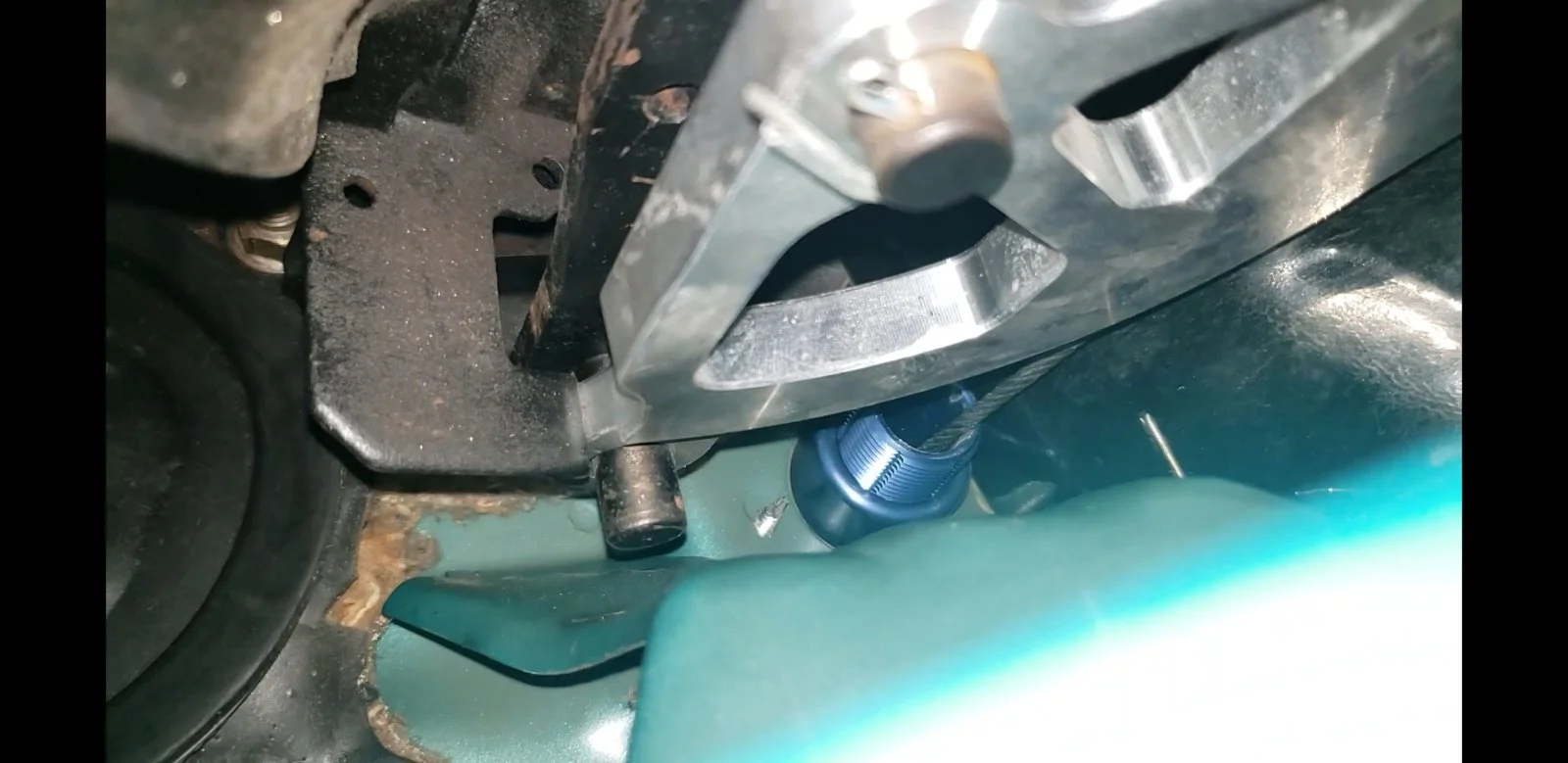

Ok so here's a bit history on the car what I know so far. It a 92 fox body 5.0 originally an Automatic converted to a 5 speed. I believe it has a T5 in it now. The car ever since I bought it from the owner has always had a stiff clutch was fairly hard to push in the pedal in, but was manageable to drive. Recently it started to get really hard to put into first gear as the transmission got hotter. Then one day driving I felt the pedal get softer felt like a honda clutch. So I suspected that my cable maybe needed adjustment. So the previous owner had installed a aftermarket firewall adjuster and dual fork clutch pedal quadrant assembly. So I went an adjusted the fire wall adjuster to see if maybe i needed to give more tension to the cable so that the clutch will disengage and give smoother shifts. Well it did for like 5 mins then the clutch cable snapped and I had to tow it home.

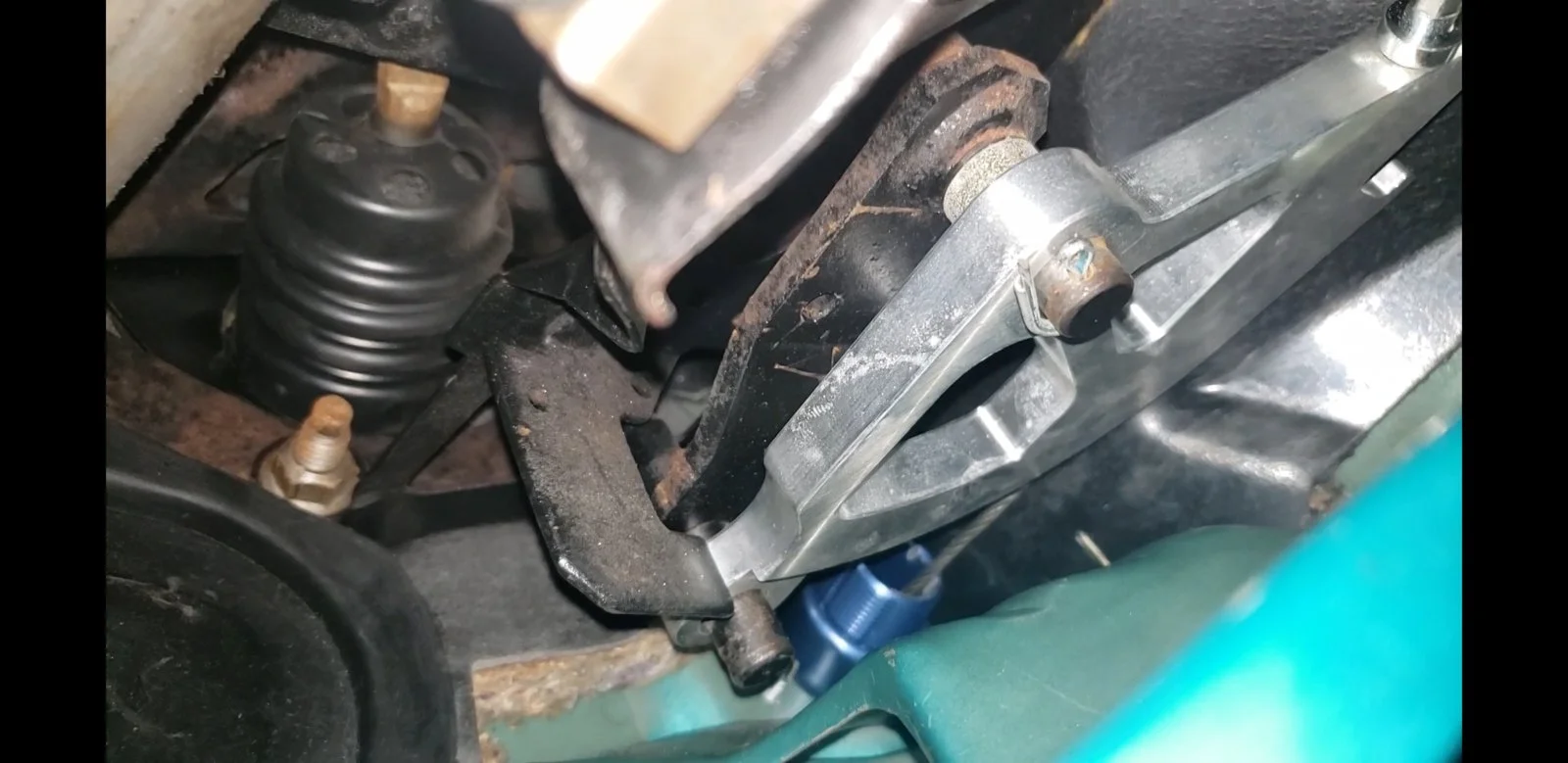

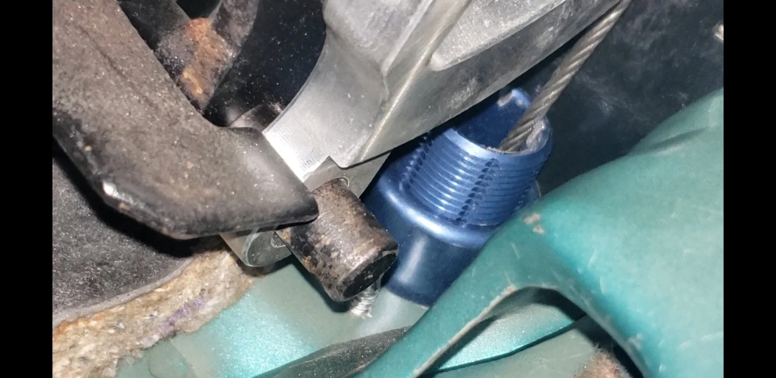

Ok so here's the problem I installed the new BBk cable which was a bit longer than the one in the car. Went through all the steps to putting back to make it functional. Now my clutch is super super hard harder than before to the point that I feel like something is really wrong and might snap or break. I thought it was an after market cable thing because I've read that sometimes they might be stiff but not like this. I adjusted it from the firewall adjuster as well as at the bottom of the bell housing. The car goes into gear smoothly and shifts relatively smoothly, but to de press the clutch is ridiculously hard. I also here creaking coming from the pedal everytime I press it. I went under the dash to see what's going on and from what I can see it looks like the cable is rubbing on the fire adjuster. I can even see the firewall flex where the adjuster is everytime I push in the clutch. I'm all out of ideas and can really use some of your guys help.
I've attached some photos to maybe help.

The noise comes from under the dash. I believe it's the firewall flexing that's making the noise or the clutch cable rubbing on the firewall adjuster. As for the clutch I really dont have any idea.
I had a BBK cable way back over 15 years ago. It broke shortly after I installed it. I also had a Centerforce clutch and that combo seemed very stiff. Maybe try another brand cable like Ford Motorsport or Steeda.
The sleeve (it has a name but it escapes me now) that the throw out bearing rides on which partially covers the transmission input shaft may be gouged or scored which can cause binding. If it is I believe a steel replacement is available.
It's time to pull the trans and look at it and the clutch assembly. My friend has a 92 also that I believe was an aod converted car and his clutch was also very hard to push. I always felt something was misaligned to cause that. The motorsport clutch is stiffer than stock and the king cobra even more so.
