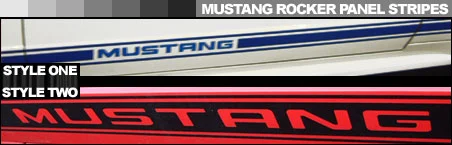

Ok Mustang Guru's
I need some advise I brought rear bumper decals and Side decals.I have done the bumber decals and they went ok using the washing up liquid method.However I do find the side ones a bit more intermerdating due to there size.Does anyone have a any helpful hints they could pass on to a mustang newb.
Cheers
Similar to the ones Im trying to put on.
Get an empty squirt bottle with dish soap and water and spray like crazy. The more water and soap you use the better the letters with more around and seal once you get them where they need to go. I got the soap and water decals so cheap before but now all I can find are the stickers. Where do you find the soap and water decals?
1 tablespoon Dawn-1 gal water. I'm pretty good with decals. HOWEVER, I ruined the side decal 2x because- I did it with some wind(picked up dirt). And too much sun present. Also, laying on the ground trying to get them parallel was rough.Take your time..make sure the weather conditions are correct.(temp & no wind)I like to use a small rubbber sqeege instead of the little rubber scrapper.Good luck..show us the finished work.
