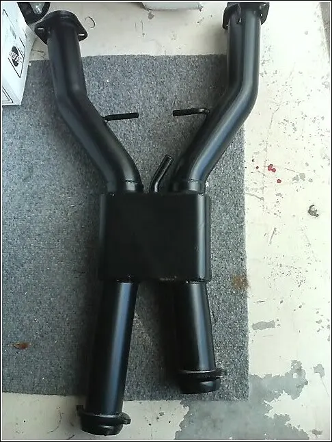

I had a huge exhaust on my 347, MAC 1-3/4" Ceramic Long Tubes w/ 3" Collector, MAC 3" Prochamber and MAC 3" cat back. This was my 5th exhaust system and by far the best sounding. That Prochamber sound is unmatched. I've posted the car idling in another thread 94-95 specific.
