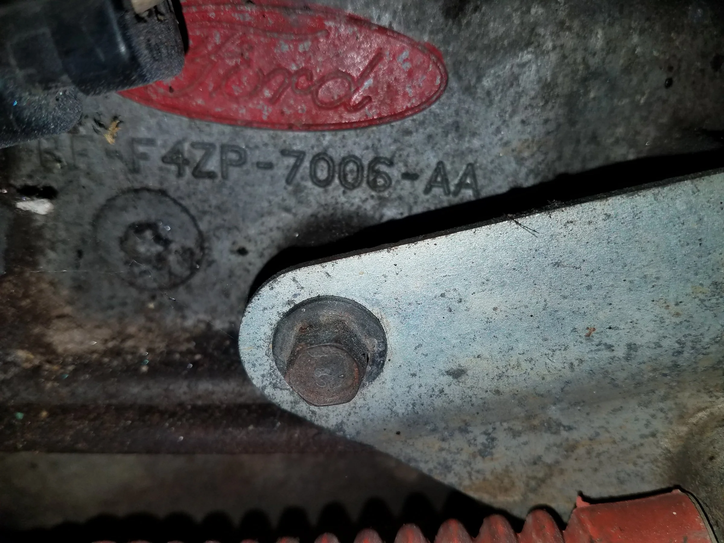

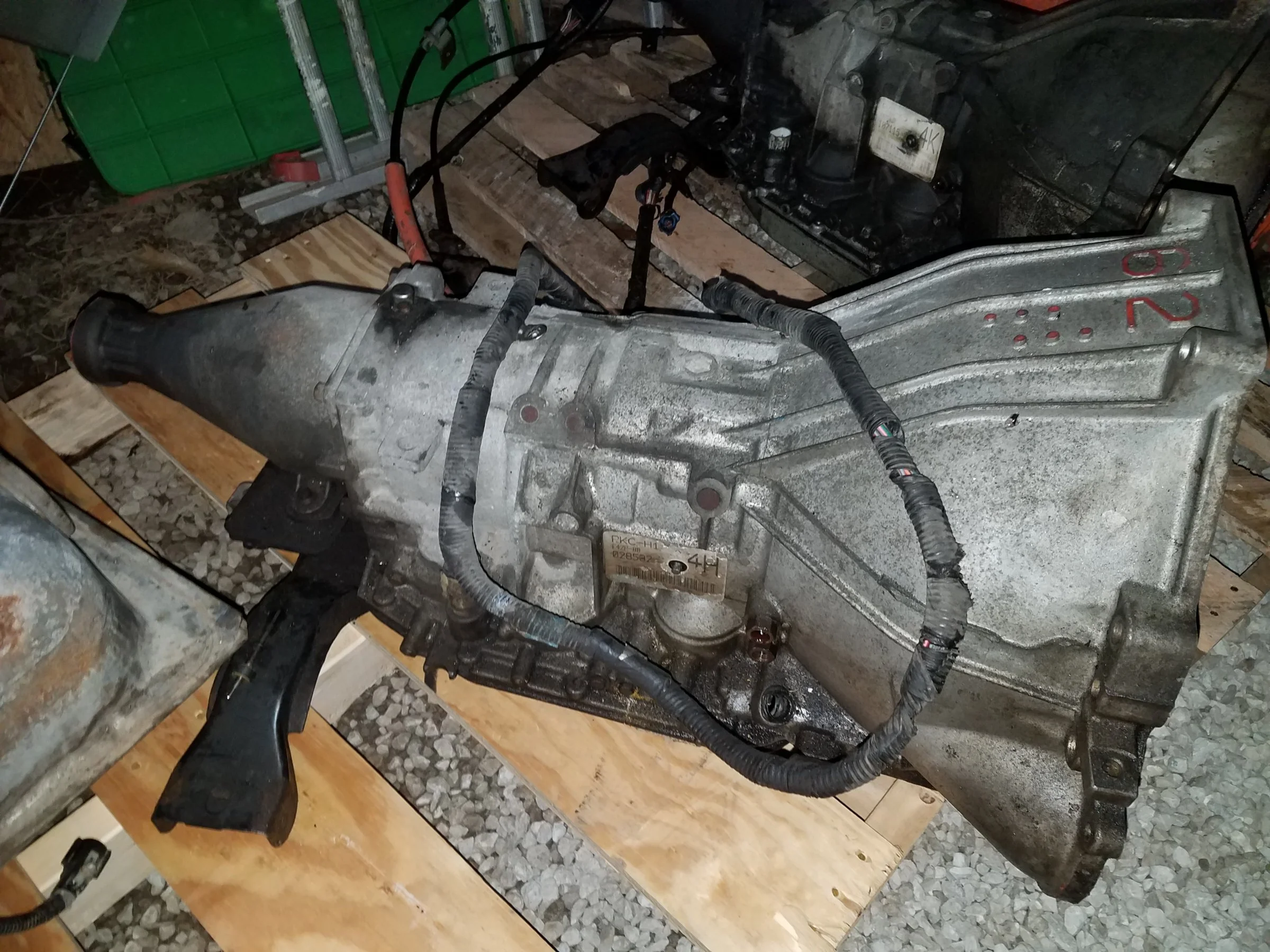

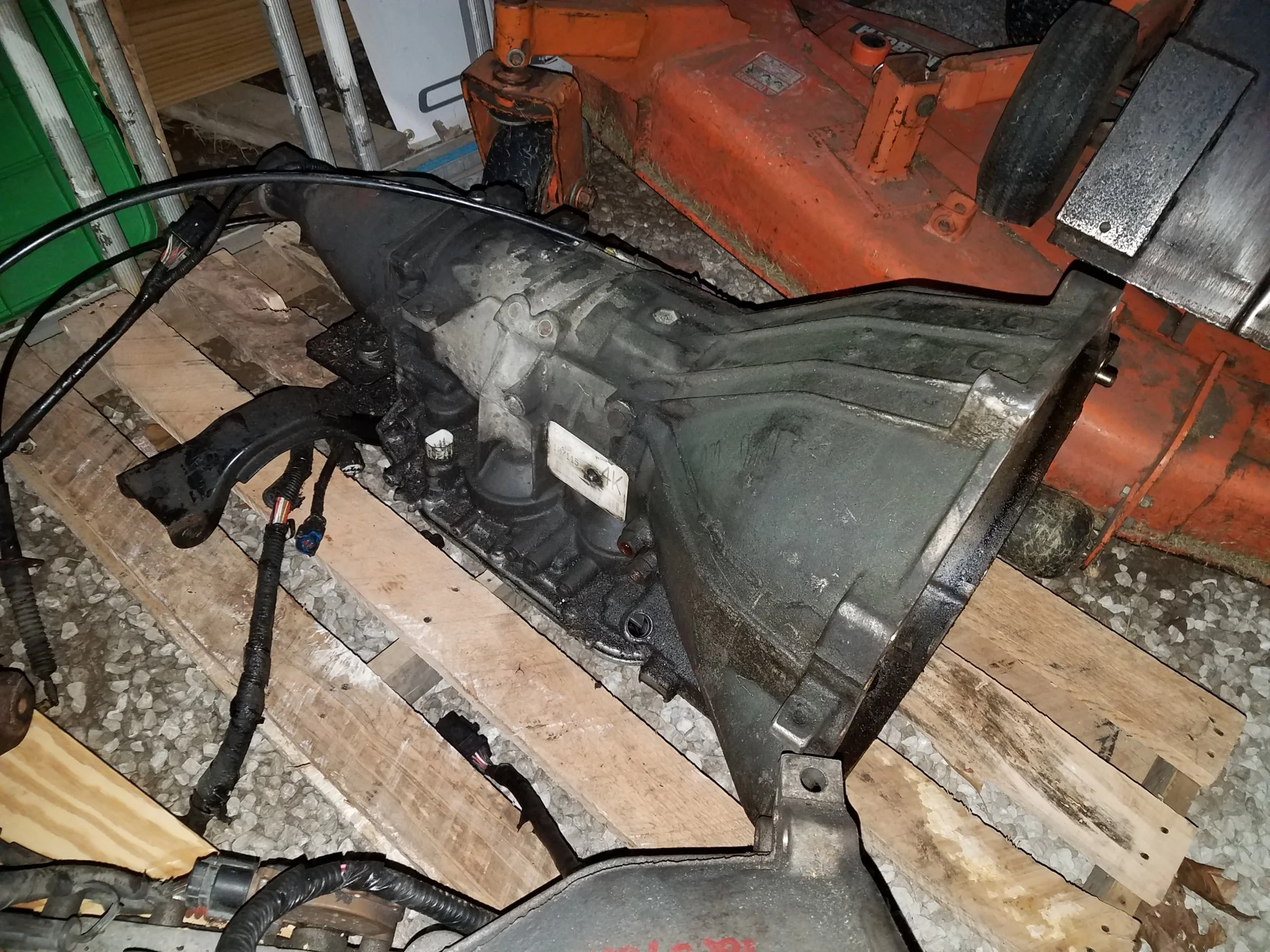

Ok, so now..... Transsmissions! From what i know now, im assuming one is a v8 trans, and one is a v6 trans. How do I identify them? Thanks!
