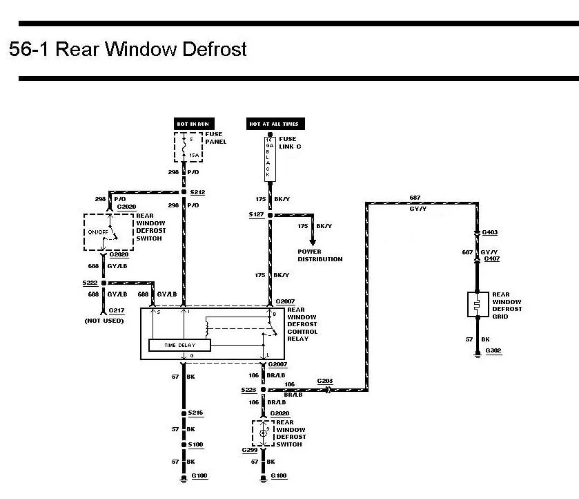

Alright so my window defroster ain't working and I was wondering if anyone has a wiring diagram for the switch and if anyone knows where the relay is? The light on the switch doesn't come on and I'm not sure if its the switch or the relay because if i run a hot wire to the rear window the switch light comes on. Any kinda help would be much appreciated.
The defrost control relay is under the dash near the steering column.
