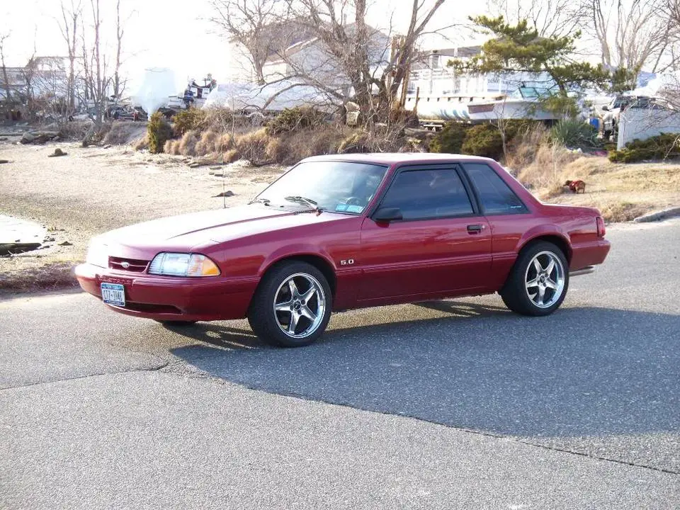

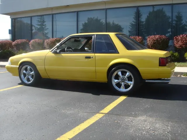

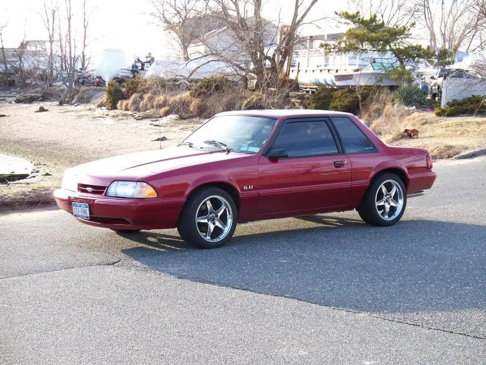

Okay, for any of you following along... my car is pretty much done mechanically (for now :D) I installed a room full of parts and had it dyno tuned and made the power I was looking for. Now my problem is that the car is still running on 100% factory stock suspension. I have full length MM subframes welded in and they made a world of difference. I would like you guys to give your honest opinions on a solid street suspension setup. I'll need the following:
  • lowering springs
  • shocks
  • struts
  • caster/camber plates
  • rear lower control arms
  • bushings(??:shrug:??)
i have my heart set on megabite jr. lower control arms and an eibach pro kit for lowering springs... but i'm open to any suggestions... post up, please!!!
here's how she sits now

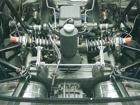

Do thid in the front :

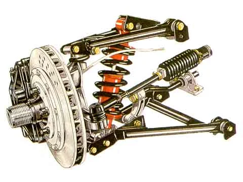

And do this for the rear:

thanks Matt, a little advice from someone who knows what they're talking about is a big help, i think i'll be ordering the strange 10 ways... i actually already have a MM steering shaft sitting in the box as well but forgot to mention it, and lower control arms should be ordered next pay period :D thanks for the advice!!
and thanks for nothin laser! :rlaugh:

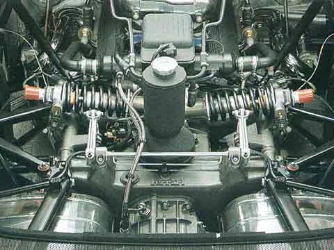

Fully adustable performance valveing at all four corners. Great ride quality and you can lower it up to 5 inches!
Damn, that's nice, just looks expensive...haha
yeah leroy93lx... $4,000 is a liiiiiiitle out of my price range for my suspension mods hahah, but your car/house look beautiful
too bad archaeologists like myself don't get paid that well :rolleyes:, otherwise i'd be all over that air-ride system, or a full coilover setup
