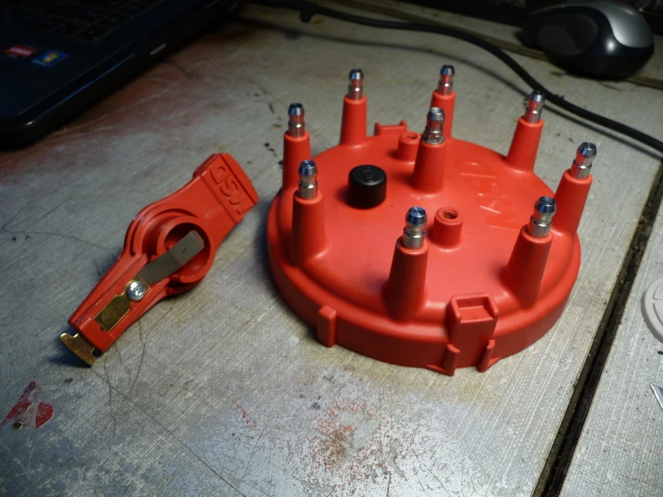

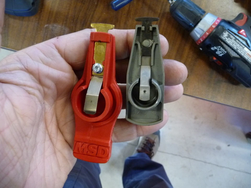

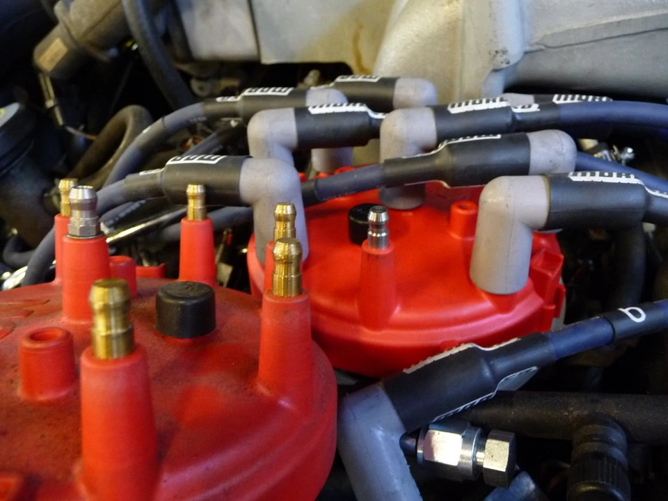

Ahhh, chasing the gremlin. I think I've figured it out. It was the new MSD distributor cap. First big change came when I removed the cap topper thing that goes over the wires. I could even see on the coil wire tower and mounting screw holes where the dust from arcing had been happening. But even with the top piece removed, the problem was intermittent. It was weird because I could cut the timing back to 8 and the problem would go away mostly. Move it back to 10 and the problem would come back, even happening as low as 4k rpm. Just didnt seem right. Anyway, I decided to put the old cap and rotor back on. That fixed it. Timing back at 10 and no issues. I'm going to test again tonight when it gets colder outside.
So, new MSD cap/rotor (suspected made in China) has non brass posts and a larger red colored counter balanced rotor. It's a POS!!!
My old MSD cap/rotor (made in USA) has brass posts and a smaller grey colored rotor. Works fantastic!!!
So beware, even if a vendor shows you pictures of the good stuff like this.
You might wind up getting junk like this.
Here are some side by side comparisons. Brass posts and grey rotor works for me. The other one causes misfires in my application.
