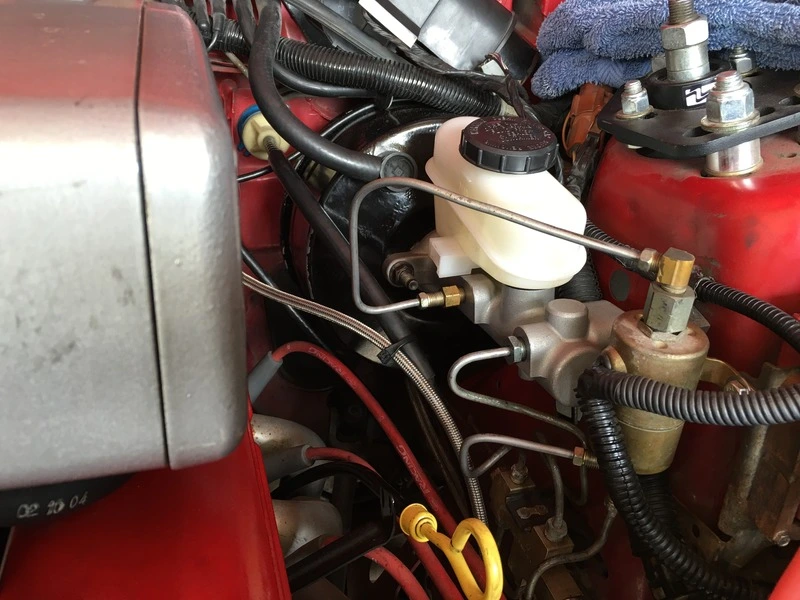

Just finished my Cobra booster install to compliment the 93 Cobra MC, 03-04 Cobra brakes f&r with ss lines and I lost a few fillings yesterday during testing. Man this thing stops on a dime then asks for change!!! I'm always driving my friends 04 Mineral grey Cobra and his brakes are spectacular in stock form so I knew how mine should perform. My car's braking was definitely sub par. It feels on point now and glad I made the change. Pic for tits!

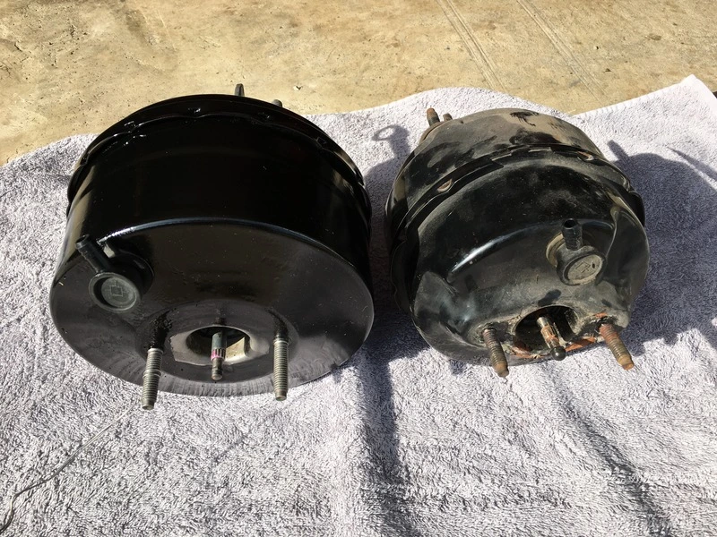

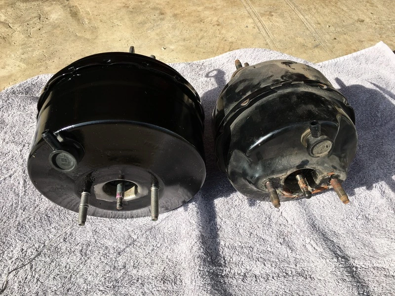

Boy were you guys right, swapped in the cobra booster and M/C earlier this week and just now finally got the wife to help me bleed the brakes. The car stops so hard it makes my head hurt, no joke lol. Thanks for all the help.
