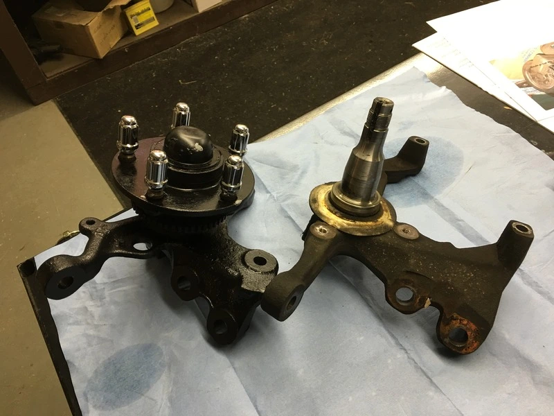

Finally did the 5 lug/4 wheel disc swap on my car. Used the following parts....

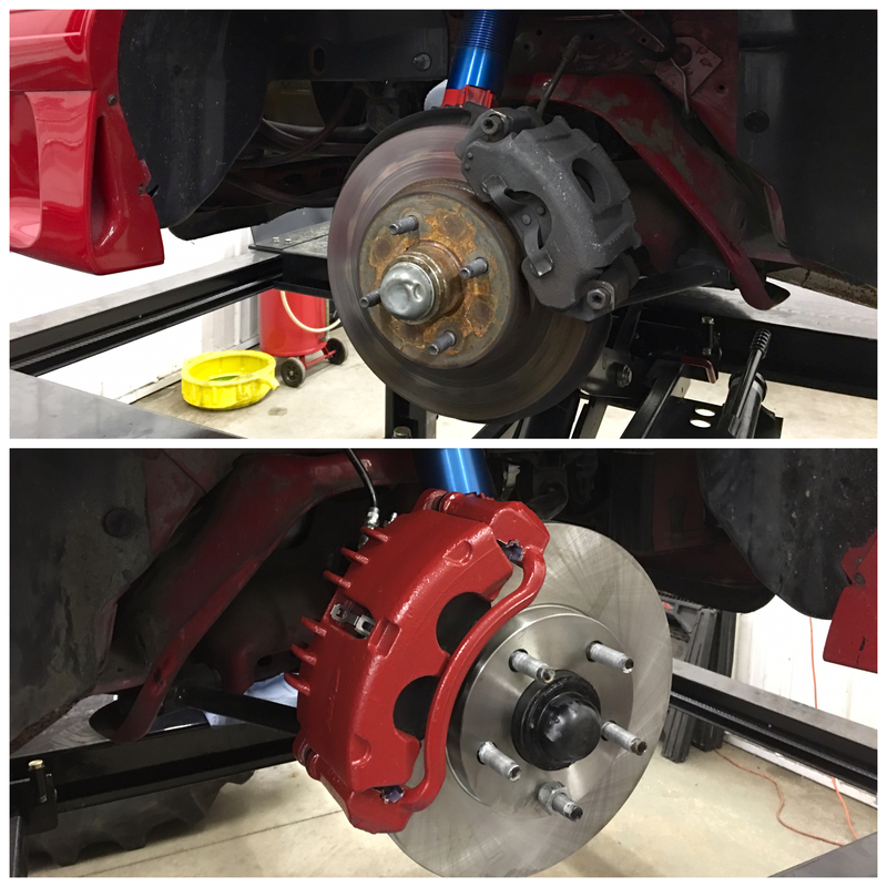

94/95 spindles
JM Stainless brake lines up front
99-04 PBR dual piston calipers up front
Gutted and plugged stock proportioning valve

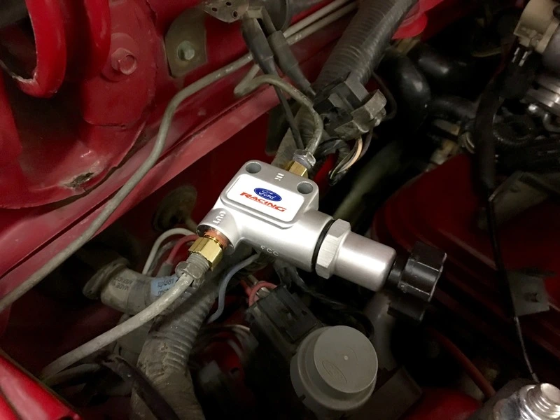

Ford Racing adjustable proportioning valve
94/95 GT Master Cylinder
Stock fox vacuum booster
StopTech "Street" Pads up front

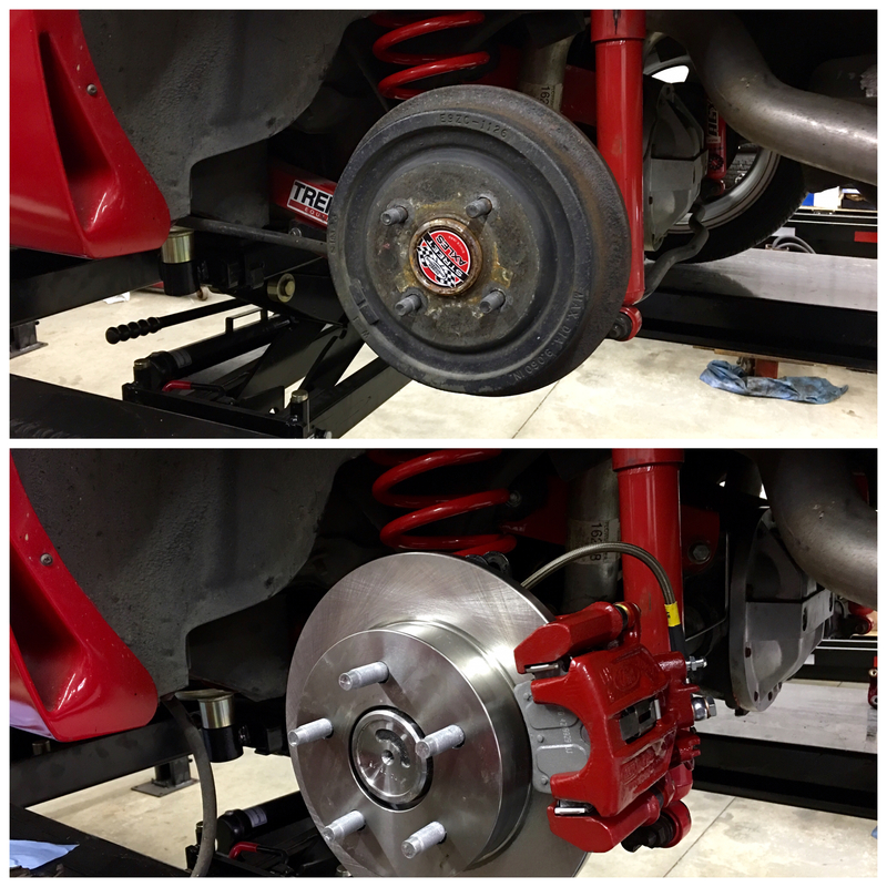

Brand new stock 94+ GT rotors on all four corners
McClure line lock kit
Moser 31spline 5 lug rear axles
Maximum Motorsports rear brake line adapter kit
94+ GT calipers in the rear
Ceramic rear pads
Proportioning valve turned in 4 turns in from all out
So far the brakes are extremely underwhelming, takes a TON of pedal pressure in order to stop the car in a hurry, and even then it's not doing so very well. The factory brakes did a better job, if that tells you anything. Do I need to give the StopTech pads some time to seat? Is the stock brake booster way too under powered for 4 wheel disc? Should I bypass the line lock kit, it worked fine with the old setup. Really disappointed thus far with the swap (other than the looks). Some pics for reference....
