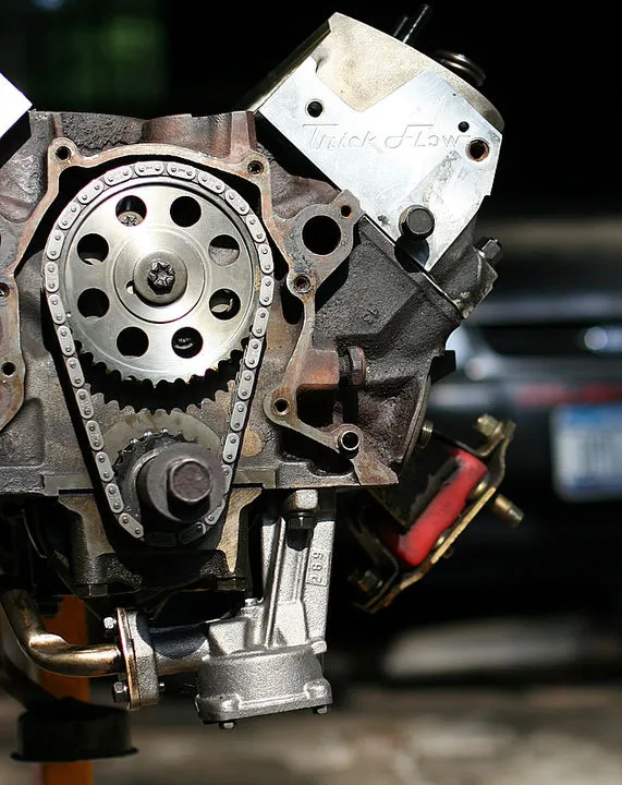

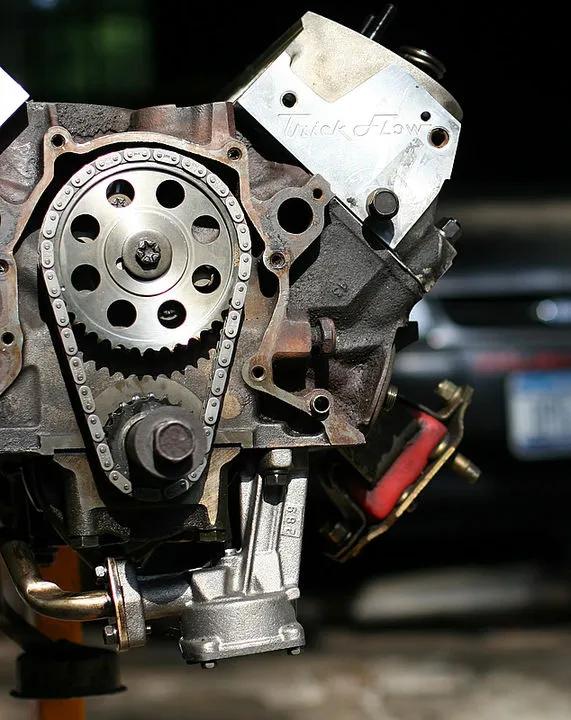

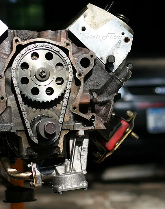

Well the motor is in the car, and it seems that the oil pump has made a small crack in the oil pan, about as thick as my fingernail but not as wide as my pinky nail, right at the corner of the pan. I didnt notice this when I was installing the motor, its a very small hole I had to look a few times because it looked like just a nick in the pan. It looks as if the oil pump pushed out the pan a very very small amount and Im not exactly sure how it happened because I cannot feel the oil pump when I stick my fingernail in there.

For now I just put some JB weld on the small spot since I am about 2 hrs worth work from starting the motor and I figured the worst it could do is just leak a little, what do you guys think? Did I install the wrong pump? It says its for SBF and everything lined up perfect, even looked like the old pump.

I've personally used that exact pump about 3 or 4 times on various engine builds and never had an issue...sounds like you put something together incorrectly... did you use a different pan??
No this is something that happened while the motor was out for sure, heres some pictures of the oil pump on the motor and then with the pan too

im gonna say you probably bumped it or something when it was out cause based on the pics it looks like its assembled properly....clean it up and jb weld it till you can take the pan off...

I think its due to being a High Volume pump. I used one once had the exact same issue. I did not like the HV pump, went back to a stand volume pump and did not have any issues. The housing might be different, I would like to compare them side by side and take measurements to be for sure???
I have heard the same thing, that the high volume pump requires a bit more clearance because its in a different housing. Thats the only reason I replaced mine with a standard one.
But thats just what i've heard, whether or not there's any truth to that is another story.

did you use a high volume pump with the newer style pan ?all new oil pans for the mustang is a super ceded part # to the sn 95 style pan slight diffrence but shallow enough to put a small dimple in the pan need to get a 87 93 older style pan no longer avail from ford.summit has them i think or go with a deep sump pan
