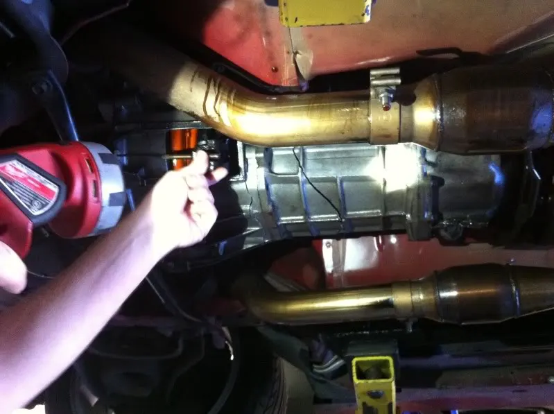

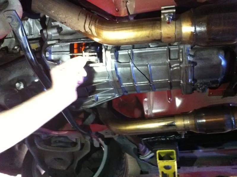

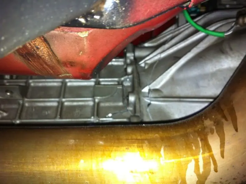

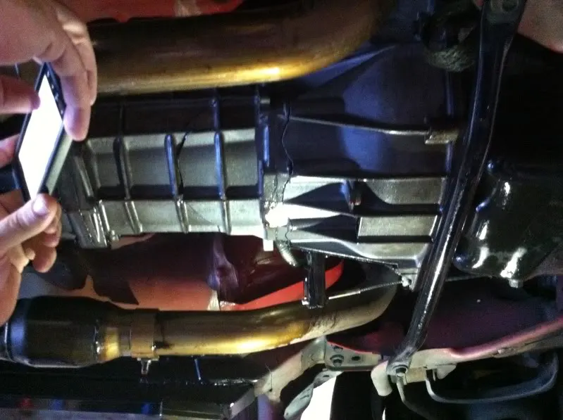

Well guys here you go! Stock T-45 cracked the case during a 4th gear pull... not a hard shift, just a pull on a 305 rwhp 88,000 mile 99 cobra. Enjoy
I am shocked, I have never heard of a T45 cracking the case before. The case should be able to stand up to well over 450rwhp without an issue. I am guessing there was something else going on inside.
I have had my fair share of T45 issues as well. I have broken the 1-2 shift fork, the 2-3 shift fork, the key holding the 1-2 fork. After a full rebuild and 20k miles, it is starting to hang up in R and makes a little noise in 5th. Obviously, it needs to be pulled out and taken apart again.... All this on a 180-230rwhp GT....
