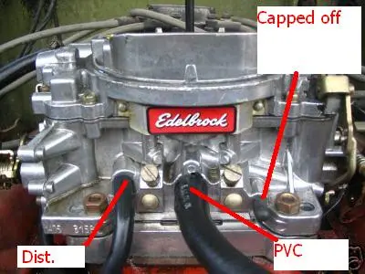

A couple of other things, do you have the vacuum hose from the distributor pluged into the small vacuum port on the passenger side? Do you have the PVC hose pluged into the middle vacuum port (the big one)? Do you have the small vacuum port on the drivers side pluged off? Like the attached pic? Have you tried a new PVC valve? or just capping it off at the carb temporarly?

EDIT: Oh, and I don't have a PCV valve on the car at the moment, but I did have one on it before I changed the engine. Right now there's a breather cap on the pass. side valve cover and on the driver's side cover the cap is supposed to have a hose on it that goes up to a connector on the base of the air filter, but right now, I don't have a hose on it (gotta dig though my garage and find a chunk of hose that will fit).
