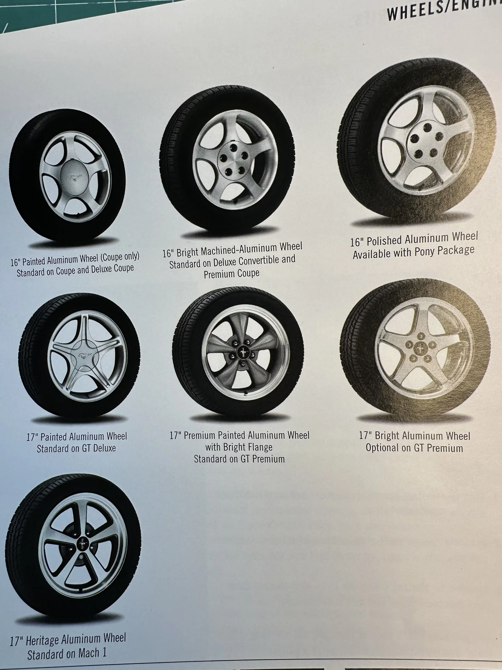

so for the GT deluxe, for 2001-2004 you got the painted 5-star 17” wheels, and the 01-04 GT premiums got the bullitt wheels. The 03/04 also had a bright wheel option that was not available for the deluxe I believe.

Also, do you know if I can put 17" TIRES in place of the 16"??

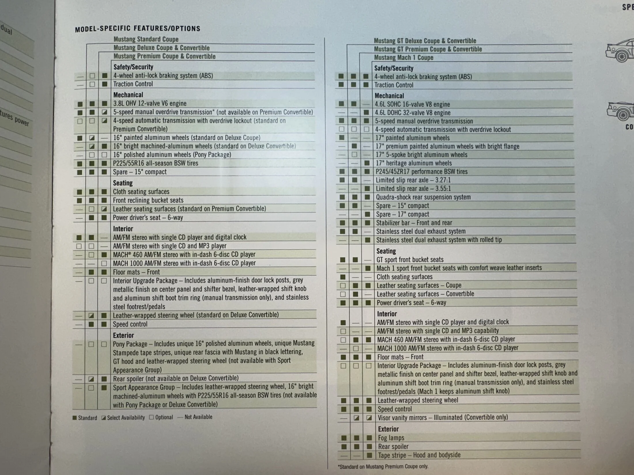

Pulled out my 2003 brochure and forgot to mention with the V6 there is a “standard” level trim in addition to the deluxe and premium.
Hopefully this is clear enough to read.
Headlights should be the same. There is no difference from V6 to GT to cobra. Headlights can be changed out over the years. Also, rear bumper should say MUSTANG (unless a cobra) on all models. The lack of it may suggest aftermarket bumper.
You can’t just put 17” tires on the 16” wheels. You will need to source the proper wheels and then put 17” tires on those. GTs got 17x8 rims with 245/45/17 tires.
