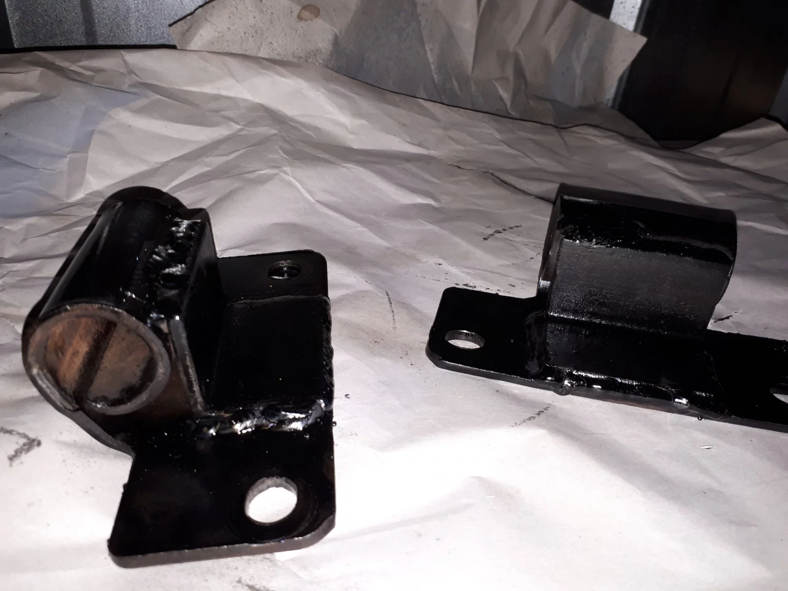

Sub Frame Connectors from Stumpy's Fab works are a must.(just do it)
Traction bars can be nice too;
slapper bars (universal old school)
Mustang II traction bars by Stumpy Fab works ( get to keep stock rear roll bar with these)
Calvert Cal- trac (a good drag bar available for MII)
The leaf spring to car mount is wimpy, it can have a piece of angle iron welded to it
This is post 144 from 429MII's thread
Thats the usual rear stock suspension upgrades for our M2s

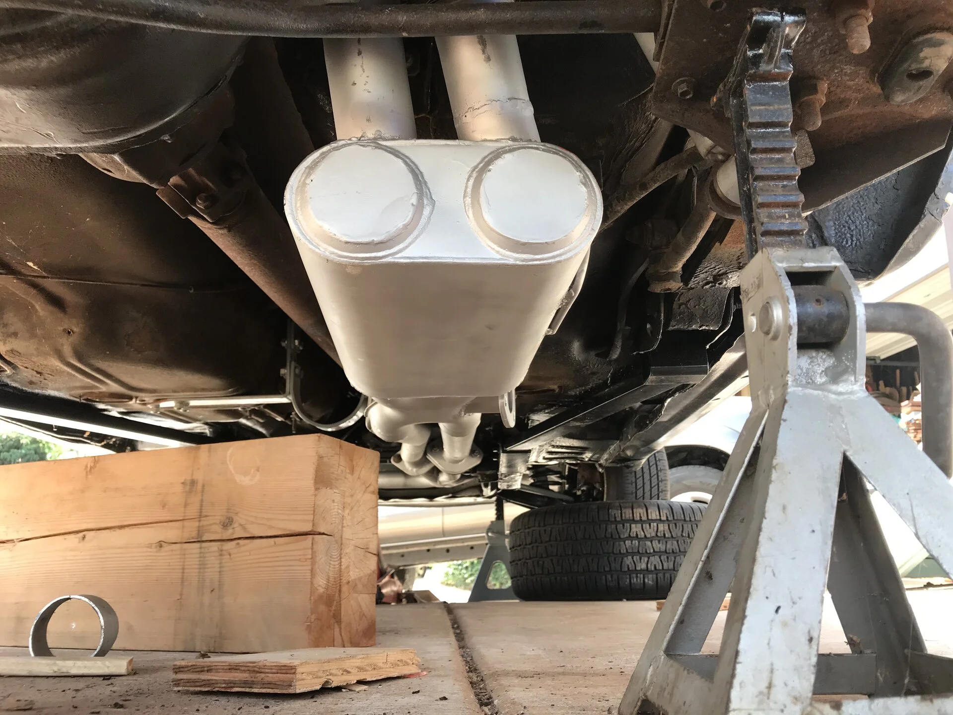

Heres mine with drive shaft safety loop, stumpys subframe connectors, and shot gun style exhaust.

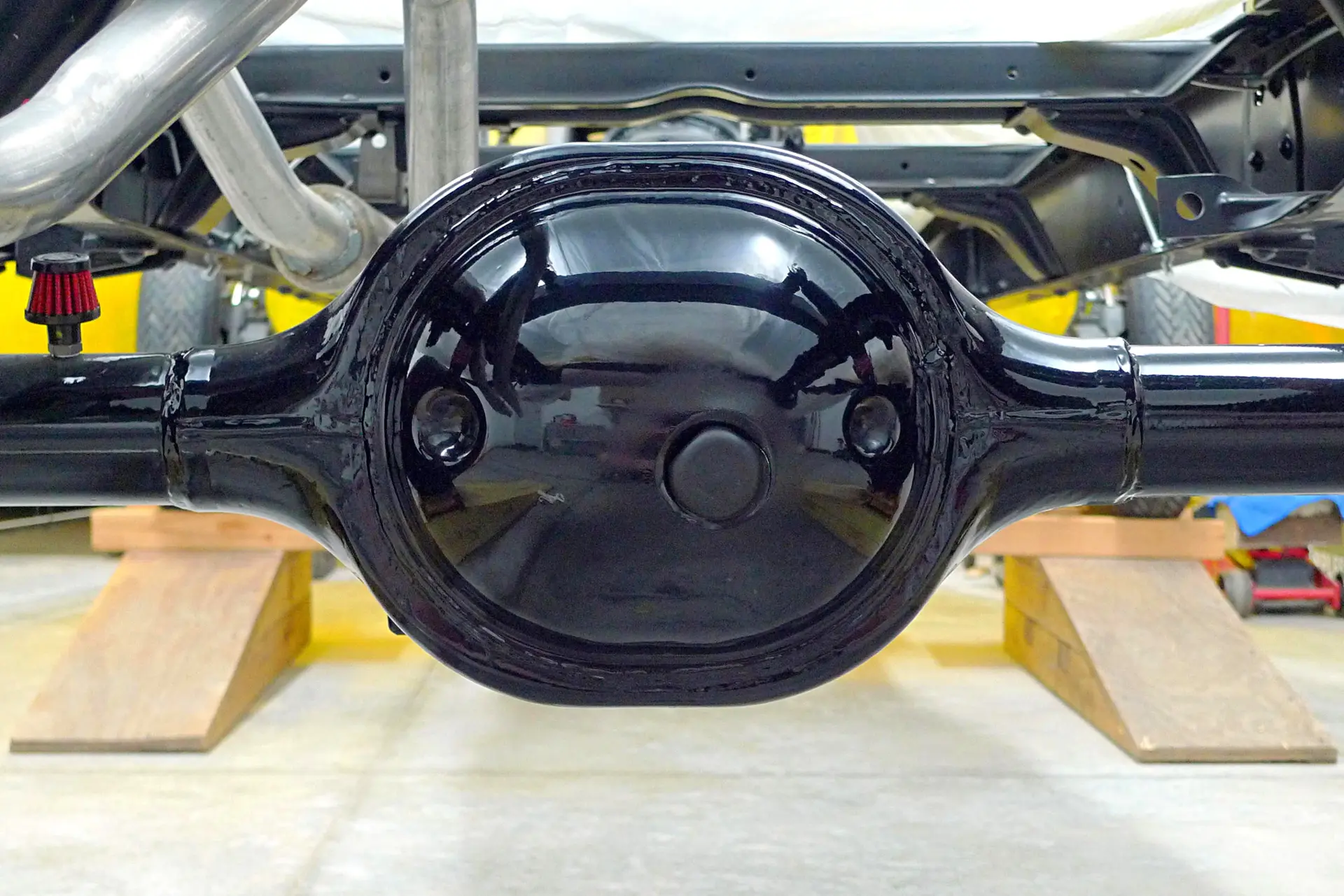

The easiest way to tell between the 2 is if the back of the differential has a cover or if it's "smooth." The one with a cover is the smaller rear, I think it's a 6.75 ring gear, the "smooth" differential is an 8 inch.
I took a look at the axle I have, I knew it was missing one of the brake baking plates but it's also missing an axle from the same side. I'm in the Atlanta area but I'm from Iowa, so I do travel through southern Illinois on occasion. I don't have any plans of making the drive anytime soon, but if you're not in a hurry I'm sure we can work something out if you want it. It's from a V8 car, I believe it's a 2.79 gear with an open differential.
An 8 inch for reference:
All of the II 8 inch rears that I've ever seen don't have that plug that's more centered in the housing. The fill plug is on the pinion side in the carrier.

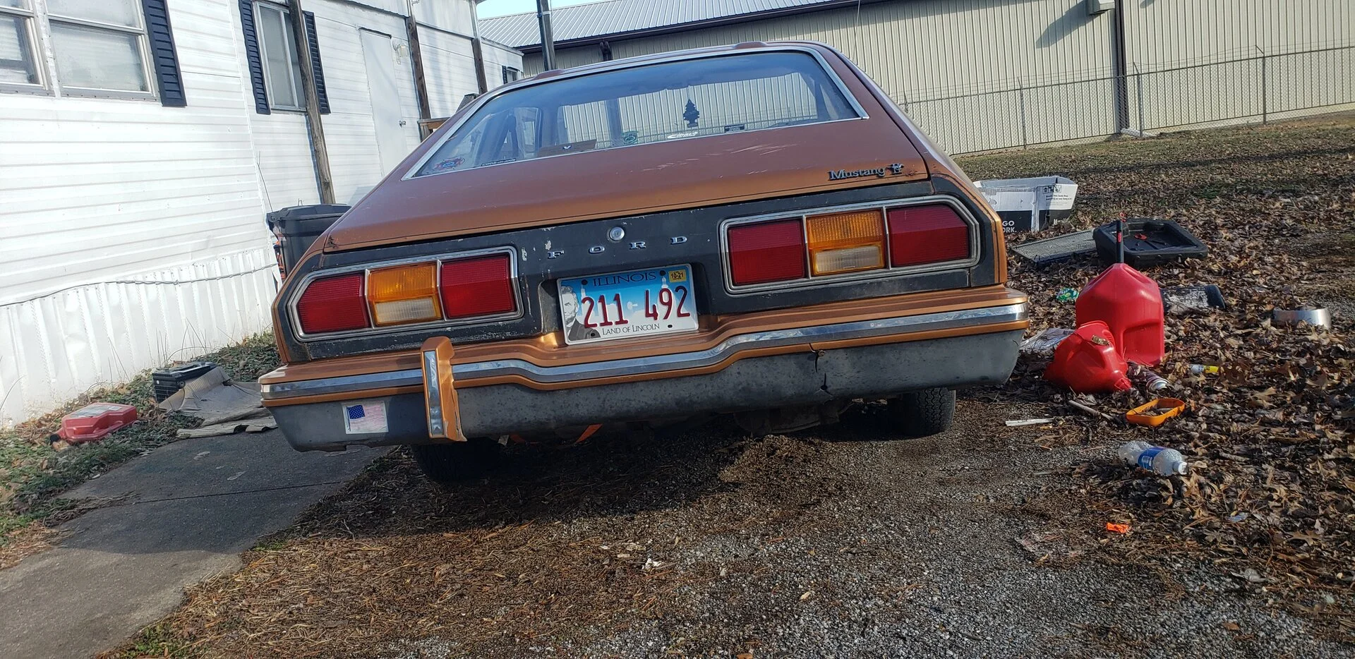

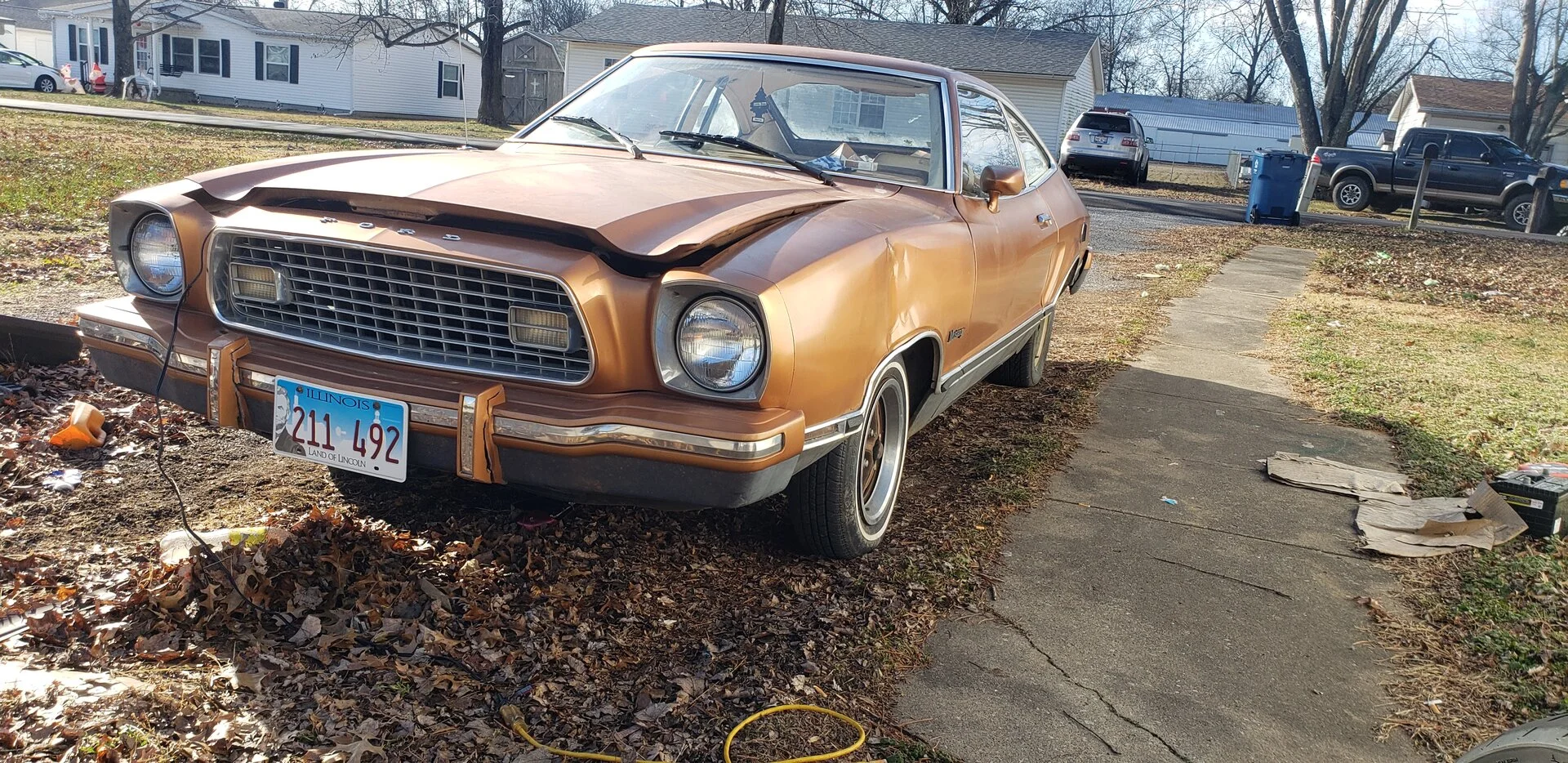

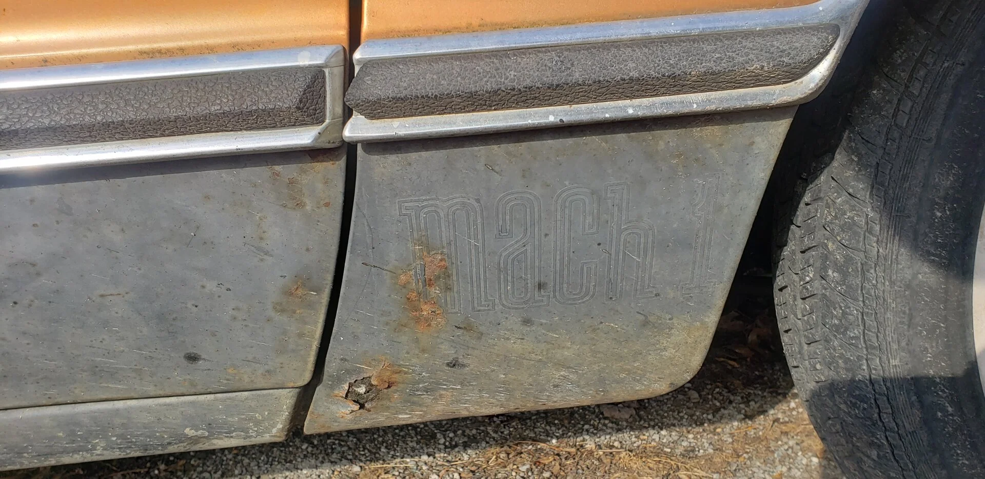

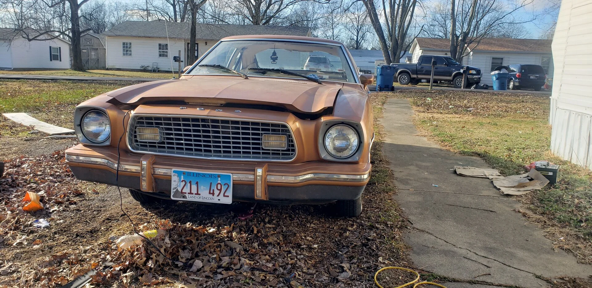

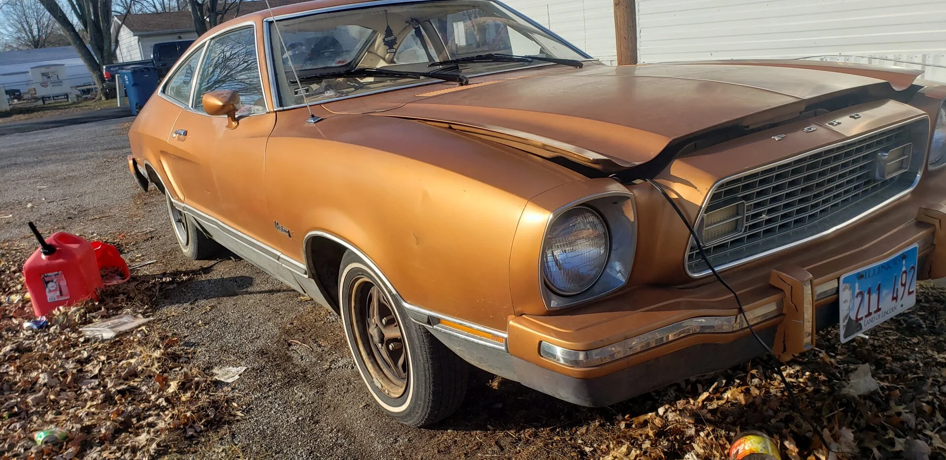

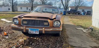

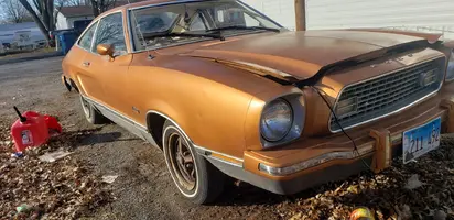

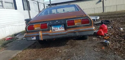

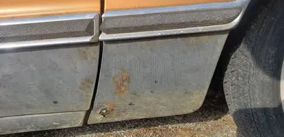

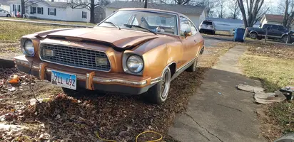

Got busy guys but here she is.
That old car is in pretty good shape,
Looks like an original paint Mach I, Wow! neat!
What color is that ? Ginger glow? First 2 yrs only? IDK
Always liked that Mach I package. Thanks for sharing
inspiration picture
