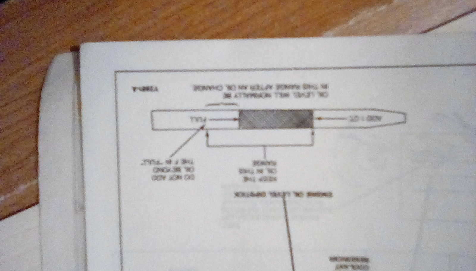

As for the oil level on the dipstick:
633144
I think it is upside down and really blurred but you can see the arrows point to the bottom of the shaded area and the 'F' in FULL and it states do not fill past the 'F', it also states 5 quarts with filter.
